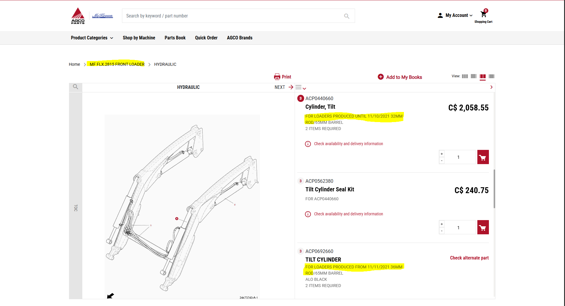

When I went to replace the cylinder I discovered that Massey had two different ones for the same FEL. One had a larger diameter rod and was obviously the replacement for the one that bent frequently. (insert inappropriate inflammatory language).
Being cheap I wasn't about to replace both cylinders although I wanted to. So, I gambled that all I needed was the rod assembly and not the entire cylinder. it's not too difficult to replace, but you won't find that construction type if cylinder on youtube so don't bother looking. That was two years ago and the repair has been working just fine.

Don't listen to the person making asinine comments about abusing your loader. He has no idea what happened and he obviously doesn't know that these loaders did have a sort of recall on the curl cylinders.

The rods have been upsized since November 2021. See screenshot below. Dealers and their local AGCO rep will consider the replacement of these cylinders on a case-by-case basis. The new rods are 4mm larger in diameter. That may not sound like much, but that works out to almost 27% more cross section. Huge upgrade, and the only reason they do that is because they screwed up the first design.
