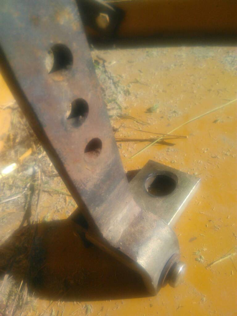

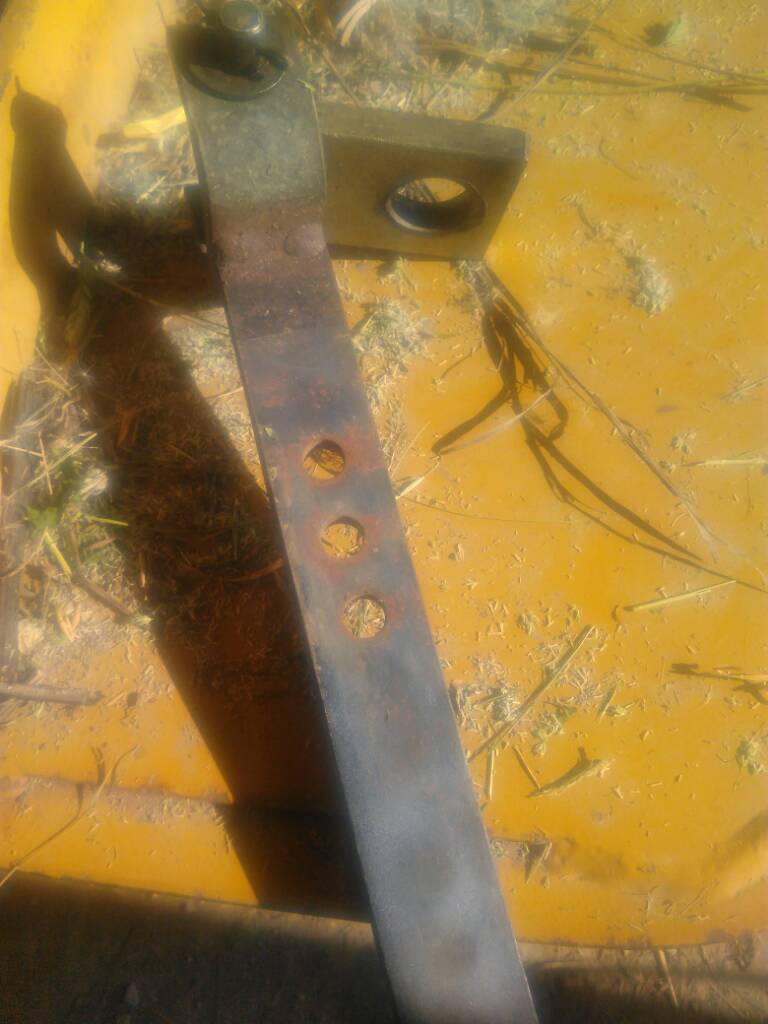

That’s what I’m saying about that plate- I think the plate is good. The stud just side loads it. I’d just grind the stud off and drill even a 3/8” hole through it and put one of these on there-
Connecting Links - Grainger Industrial Supply
Either the double clevis or a quick link.
Or if you insist on using the factory stabilizer just put a grade 8 bolt through it.
Why not take the plates off and have a shop rewelded and also reinforce the stud area. Might be better than a new one.

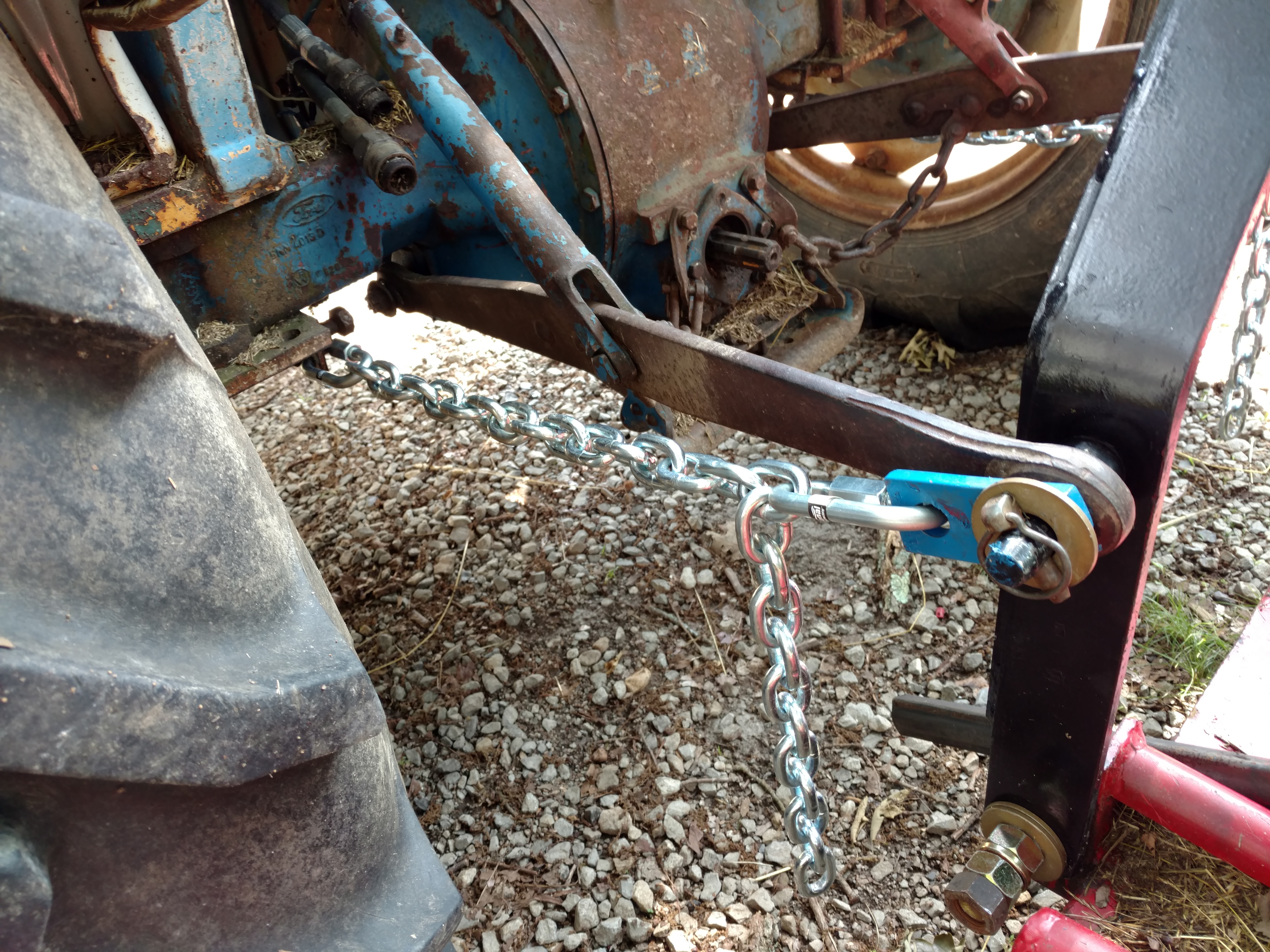

Interesting. I have yet to test out our 'log chain' solution on the 3600 that came with no functioning stabilizer system. Chain can move a great deal without bending or breaking.
I tested it hard with the Bush Hog 84" twin spindle (700+ pounds) and all went well. I used the adjustment idea mentioned by twisting the chain. I used the cheapest 3/8" TSC chain and National Hardware 315BC 1/2 Quick Link, Zinc at Tractor Supply Co.
   / Bent, broken telescoping anti sway arms on Mahindra. #24

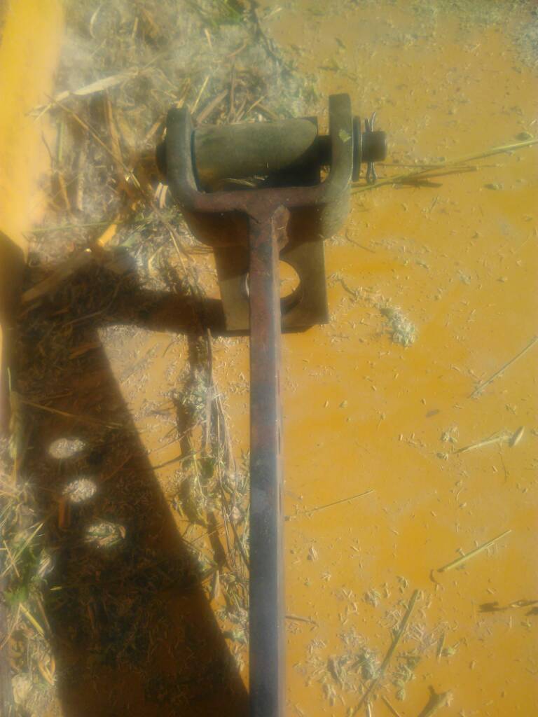

It’s easy enough to weld the stabilizer and or make new ones- heck it’d be an ok project. But with all the failures I’m thinking a different approach is needed. My “fix” was about a 10’ job on a Saturday when my options for parts was limited- and I was mid dirt project.
My biggest concern is I often use the box to “push” or cut with the tractor going backwards. This is adding to the stress on the stabilizer.
The chain seems like it was made for that type of load but it is only using one side at a time- the tension side only. the compression side obviously doesn’t see a load when using a chain. With that maybe something rigid is the way to go. However, it would seem the grade of steel would need to be something that can flex and move instead of just breaking like so many have. And just replacing it with some mild steel bar stock seems like a long shot to success.

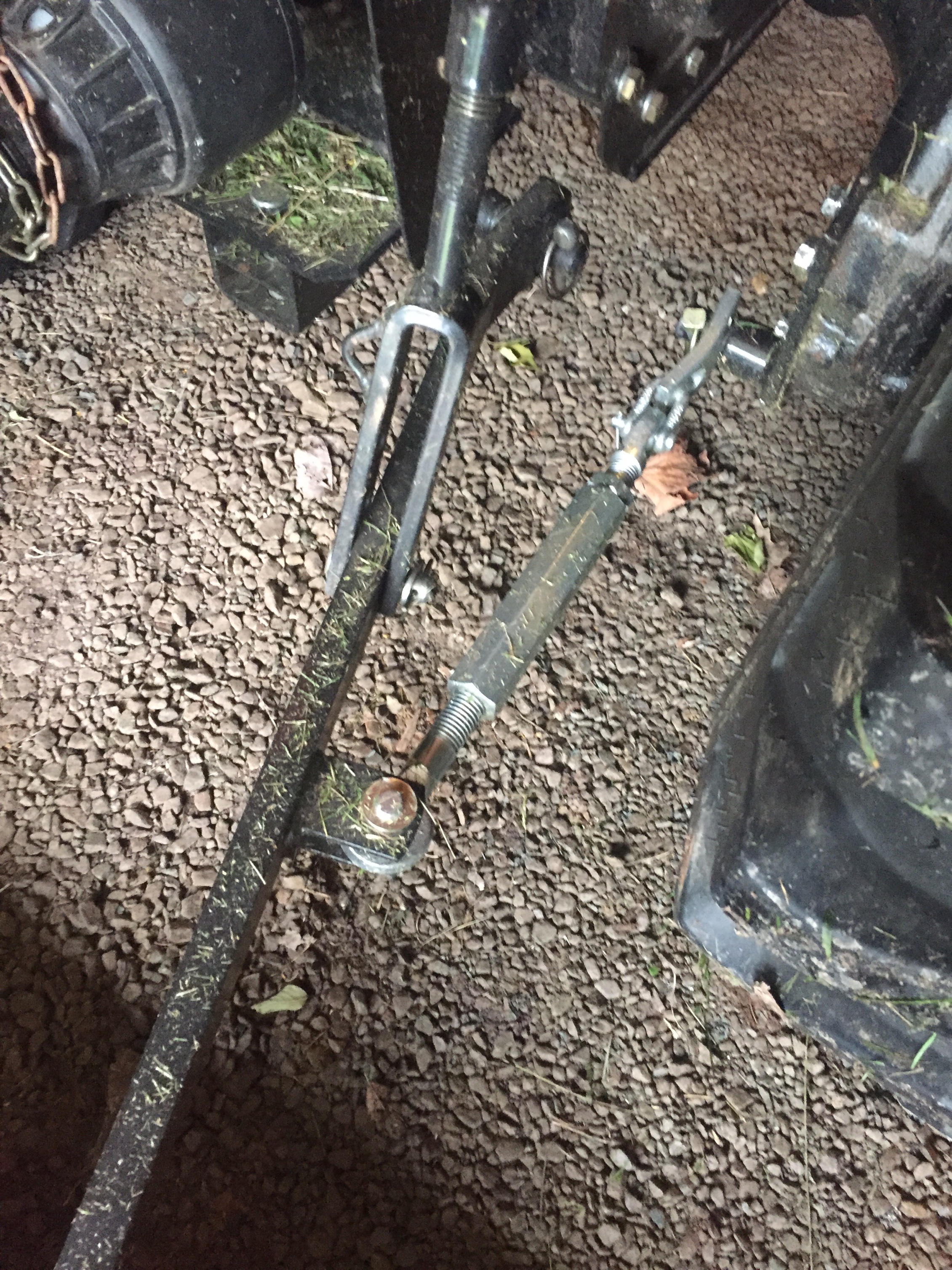

Yanmar was using the same crappy pot metal anti-sway bars when I bought my 2011 LX410. I bent several sets of them, replaced under warranty. My guess is they won't hold up to backing up a bush hog, because that is when I seemed to bend mine. NEVER had that problem with my previous NH tractor that used the same design, so my guess is the quality of the metal is junk. Yanmar probably got them from the same subcontractor/supplier as your tractor.
I finally got them to send me a different type (see link to thread below), and while not as quick to adjust (you have to turn them), I haven't bent one since.
http://www.tractorbynet.com/forums/yanmar-new/333147-some-things-about-new-yanmars.html
