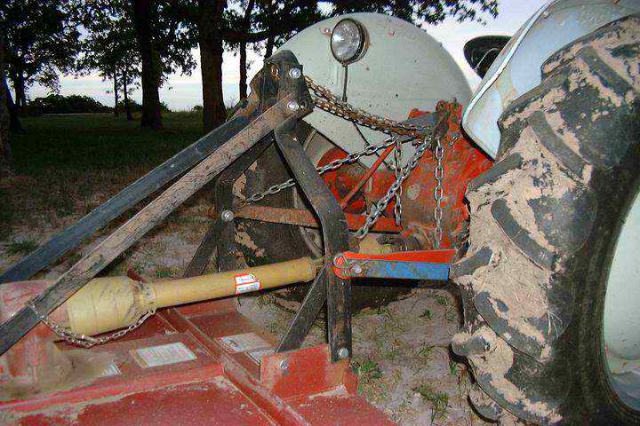

Derek, the old method of adding a stabilizer bar is probably a little stronger than the new method of stabilizer slide/chain attachment. It's a pain, but the long bar extends all the way to the pin on the implement and shares the load more fully than the new (much easier to use) style. Having said that, I've broken and bent plenty of the old style stabilizers and lift arms on my Ford Jubilee. Luckily for the Jubilee, I can buy a replacement lift arm at TSC for around $40.
Also, I bent one of my lift arms on my Boomer, but it was curved down and New Holland replaced it because the metal had been discovered to be too soft. I don't think that's the problem you have.

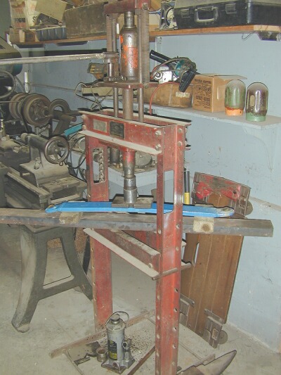

Got it all straightened out. Came out very easy. The arm did need to get pressed past straight because the steel would try to bend back to its bent state. I knew this was going to happen but wasn't a problem. As seen by the attachment a block of wood under each end and it was done.
Thanks for all the comments and suggestions. I will look into getting the slide type adjusters next time at the dealer. Or possibley make my own.
