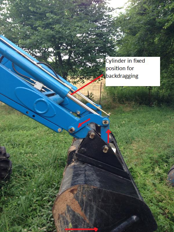

This is how I could see the dogleg getting bent. See arrows in pic as to direction of force.
Please correct me if I'm wrong. It wouldn't be the first time.
1) Bucket is in dump position.
2) Tractor is moved up to a solid structure like a tree with bucket cutting edge touching tree.
3) Operator tries to curl the bucket up, bucket or tree do not move, resulting hydraulic pressure pulling piston in will bend dogleg as shown in previously posted pics.
The loader relief valve should have prevented further damage. With 1/2" thick steel its pretty tough to bend one piece let alone bending two pieces.
Is it possible the owners of the bent doglegs have boosted or turned up their loader relief pressure setting?
The loader relief valve should have prevented further damage. 1/2" thick steel is pretty tough to bend.
Yes that arrow on the dog has to be in compression with the apex of the triangle being pulled by the cyl. ... And, yes that will tend to buckle the dog.
The situation is opposite when backdragging, resulting in the dog being in tension.
Are those a full 1/2" thick?
larry

That arrow on the dog has to be in compression with the apex of the triangle being pulled by the cyl. ... And, yes that will tend to buckle the dog.
I agree. the cylinder is pulling on the flat bar trying to curl the bucket up, if nothing is preventing the bucket from moving the the dogleg just acts as a pivot point but if the flat bar pulling the bucket up cannot move the force is then transferred to downward force (compression) on the dogleg. This asks the question why the relief valve didn't open to prevent damage to the dogleg.

Here's another pic of a loader set to back drag. If the cylinder piston is set to this position and doesn't move while back dragging wouldn't the force be transferred to compression on the dogleg?

No. Putting the arrow on the cyl ram would help clarify. It would be a force applied outward [to resist being pushed in]. So the dog would be in tension.

Yes, in play if trying to curl. But if the curl spool is centered the curl cyls are deadheaded - and what you do with the tractor or lift arms can try to change the curl. And it cant change w/o failure of some sort.
Those 3/8" doglegs and the close pin spacings on the carrier add up to an overstressed curl system. Very little performance margin.
