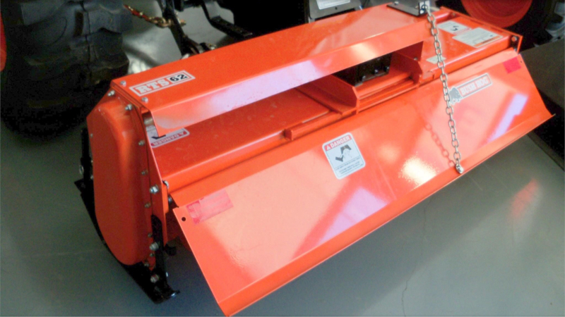

I am making a back shield for a tiller and have a piece of 14" x 60" piece of 10 gauge hot roll material that I need to put a bend in lengthwise. Any thoughts on how to do this without a brake?
Should I just weld some flat bar to the edge to make it stronger?

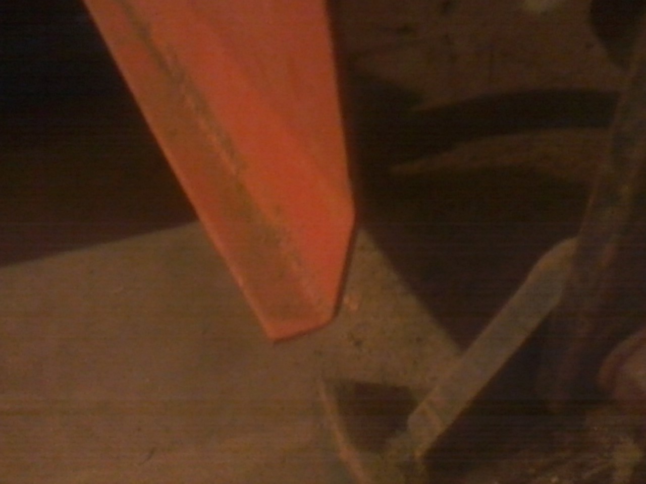

How exact do you want it? There is actually another very narrow bend back to 90 degree after the fold (and that's looks maybe a 25 degree angle) and it's done the same way both top and bottom.
Here's another pic
And against the top edge fold is where the continuous bar stock for the hinge is welded.
Dang they sure are purty looking when they are new :D
If it was me I wouldn't be overly concerned about getting too fancy with it. The rocks found in my soil will pound it out of shape after a while anyhow.
But of course that's up to you...your skill set and/or local shop connections.

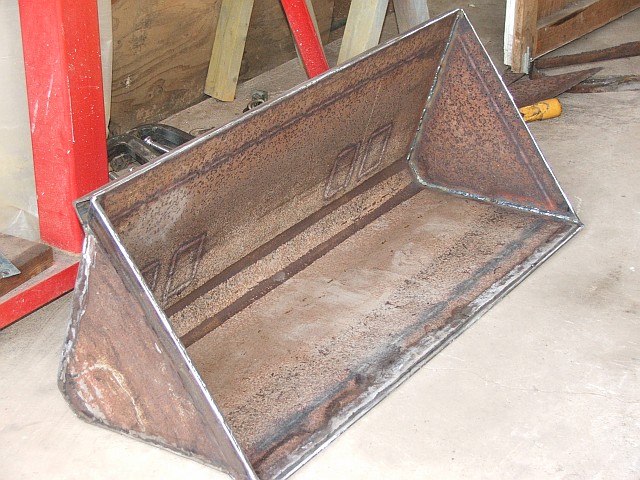

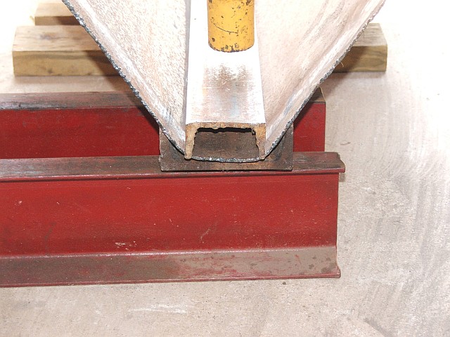

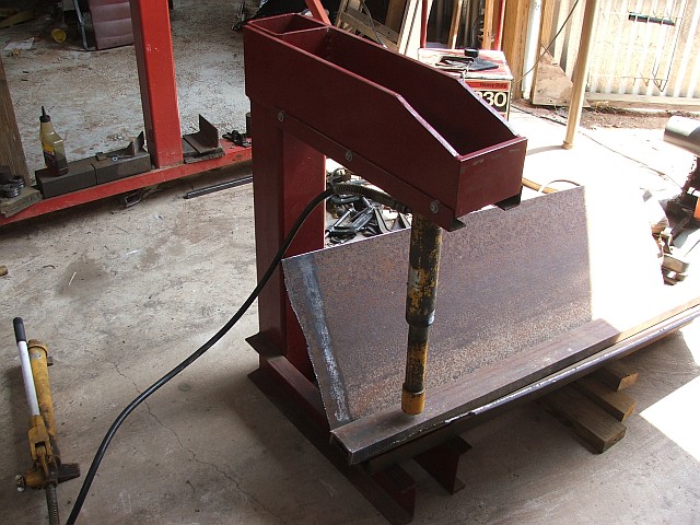

You're not going to bend 60" of 10ga. in a standard shop brake. That will require some industrial sized equipment or at least a shop press with your own dies. When I made the bucket on the Kenbota, I used two different sized C-channels--One facing up and one facing down to put the bends in the rear of the bucket. I bent a little at a time while moving down the sheet. You could do similar by fabricating a V-die using angle iron and pressing with a rod. I've done that too when making brackets with 1/4-3/8" flats that needed a certain radius in the bend.

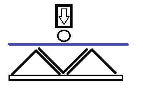

Here's a crude drawing of the way I make my V-dies and press with a rod. The angle iron is welded together then welded to a base.

If I'm not too worried about looks I'll just use the arbor plates and my press to clamp the steel. With the lower arbor plate lined up on the edge I want bent I just use a heavy hammer and bent it slightly. Then it's just a case of moving over and repeating until you get the the other end. Once you do just repeat the process slowly bending the steel further and further until you get the angle you want. It's slow but it's also free. I suppose I could cherry the steel so it would bend easier but usually I'm not in a hurry.
