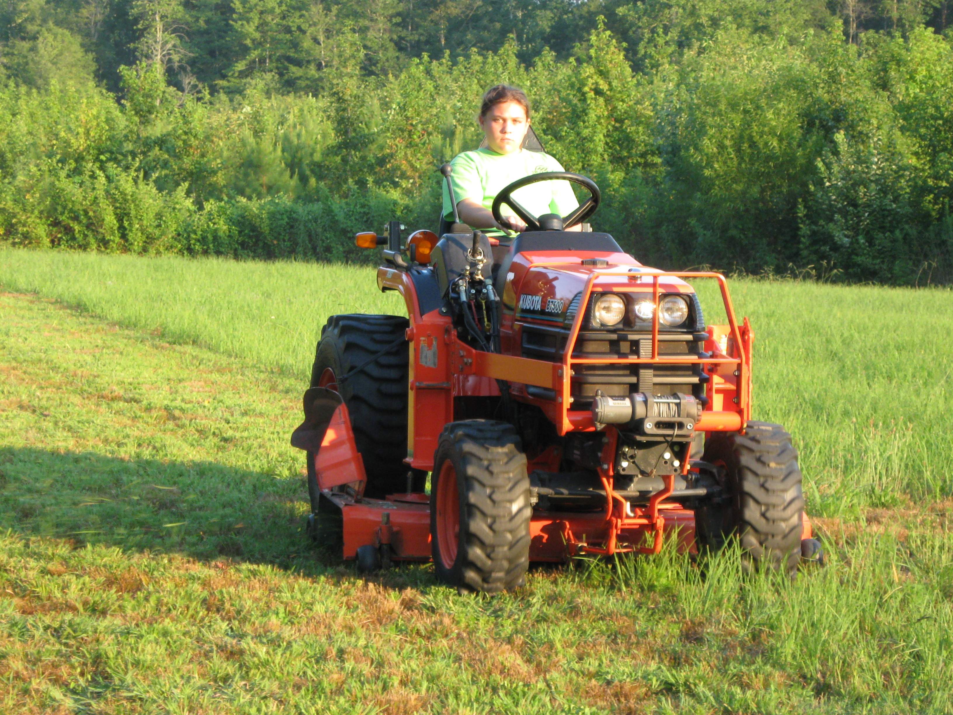

/ Belly mower install #10
I did have a RFM but it was always in the way when I wanted to turn or go around trees.I started looking for a MMM and I looked on craigslist and found someone that had one on a new tractor he bought."It had 25hrs on it"!!!!. I thought well, I will check on this and see where he lives and go look at it.I did price a new one a week before this and it was $2395.00.My FRM was bought used for $750.00.Anyway, I found out that he only lived about 8 miles away.He told me he wanted a RFM because of the humps in his yard.I went and looked at his and it was new. He said if I wanted his he would help me take it off his tractor.He came to look at mine and liked it. Mine did look "USED".Now, the question,how much difference was this going to cost me.He looked at me and said"I cannot pay you any difference" but I will help take it off my tractor for you.I was like """What"""????. I thought I would have to pay him alot of difference.I wanted to jerk his arm off but I was calm and said "I guess that will be OK."So, it was an even trade and I came out on top of this one.I did pay close attention on how it was removed and I had it on mine by the next evening.It's the best deal I ever got.I wouldn't take nothing for my MMM.
Donny
