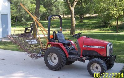

An earlier post here mentioned dragging an old steel bed spring to smooth out rough dirt, etc.
I have pulled one before behind my LGT. However, the pain was getting it to and from where you wanted to use it. Now that I have my CUT and a boom pole, I found a way. This is hardly an original idea. The county has a similar setup on their road graders where they hang a two bladed road drag and drop it when needed. This isn't the fanciest thing, but I only spent about a half hour and about $5 worth of new chain. In the future, I might drill some holes in the cross bar of the boom pole and the front of the bed spring and use a hook and eye bolt setup. But this worked just fine yesterday when we prepared to seed a yard. The nice part was that I could back it up into a corner, drop the spring and drag away from the tight spot.
This photo shows it in the upright position.

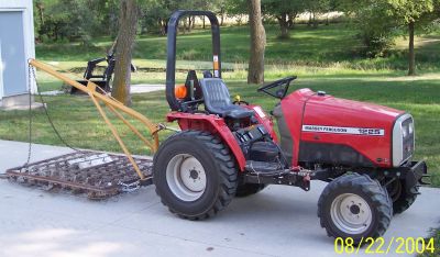

This photo shows it in the "drag" mode. Note that the chains on the front do all of the pulling and the long chain on the end of the boom pole is limp. The white things in the middle of the bed spring are lead weights off of my race car, attached with a big 1/2" U bolt. About 80# total weight, to keep the spring from "hopping" as it is pulled.

</font><font color="blue" class="small">( In the future, I might drill some holes in the cross bar of the boom pole and the front of the bed spring and use a hook and eye bolt setup. )</font>
You might want to rethink that idea, as drilling holes in a boom pole almost certainly decreases it's lifting capacity. It looks like a decent 1000# rated implement now. To keep it that way, you might want to consider having keyslots welded on the underside. Like mine, at http://www.tractorbynet.com/forums/download.php?Number=465827 and
http://www.tractorbynet.com/forums/download.php?Number=465830
//greg//

I tried this with the old mattress off of my waterbed. I must be doing something wrong because it had very little effect on the dirt! /forums/images/graemlins/grin.gif
/ Bed spring drag #12
Great idea. Some of the bear hunters in my area use them to drag old dirt roads, then later drive the roads looking for a bear print. When they find a print, they release the hounds and the hunt is on.
penokee /forums/images/graemlins/smile.gif
/ Bed spring drag #13
A few years back I used a set of springs like that to help finish off our lot after construction just before I threw down the grass seed. Unfortunately by the time we finished there wasn't much left of the original set of springs. They don't last long when you work them hard.
/ Bed spring drag #14
When i take the old box springs we usually just burn the whole then while its still hot dip it in water or spray it. They get a little longer usage and we mist fuel on them to hold off rust. One bad thing about them is I did a job for a fella and he used his bed sprin drag to drag in the seed. Then unhooked it and never got it off the yard. One year later Im bushogging the lot for him and find a pleasnt suprise. I spent 4 hours freeing the drag from the bushog shaft.
/ Bed spring drag #15
yep any OLD pring MATRES usually has some good inside springs set up to use, you can burn them off or just cut & tear them off. also works is a section of CHAIN LINK, no gate needed but the top/bottom rails on the chain link helps add smoothness to the ground, pull with ATV or rider no BIG tractor needed. add a few cement blocks too. they use these methods around the local baseball diamonds to help smooth prior to games. once saw guy pulling a ~8'x8' chain link section with 2 or 3 kids riding on back, man I was mad, if one of those kids stuck a finger down through the link it would be gone in seconds and very painfull way to loose one too I'm sure...!!!
