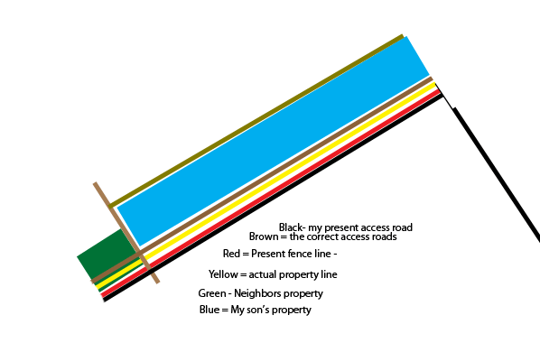

I am having trouble envisioning this. Is this road across your property, and his only access to his property to a public road? If so, he has an easement by prescription, no need to do anything.
Best I can explain it is that the easement or access road to my property should be on the other side of my present fence line. He has access to his property from another access road. I drew a very rudimental drawing that may kinda show what I mean.
/ Beating your bounds. #36
That makes sense to me. Also record that document in the courthouse in land records so it gives "public notice" on what is going on with the boundaries. As far as noting it on a survey, thats up to you. I'm not sure how much it would cost you. If its fairly inexpensive, I'd say yes.
