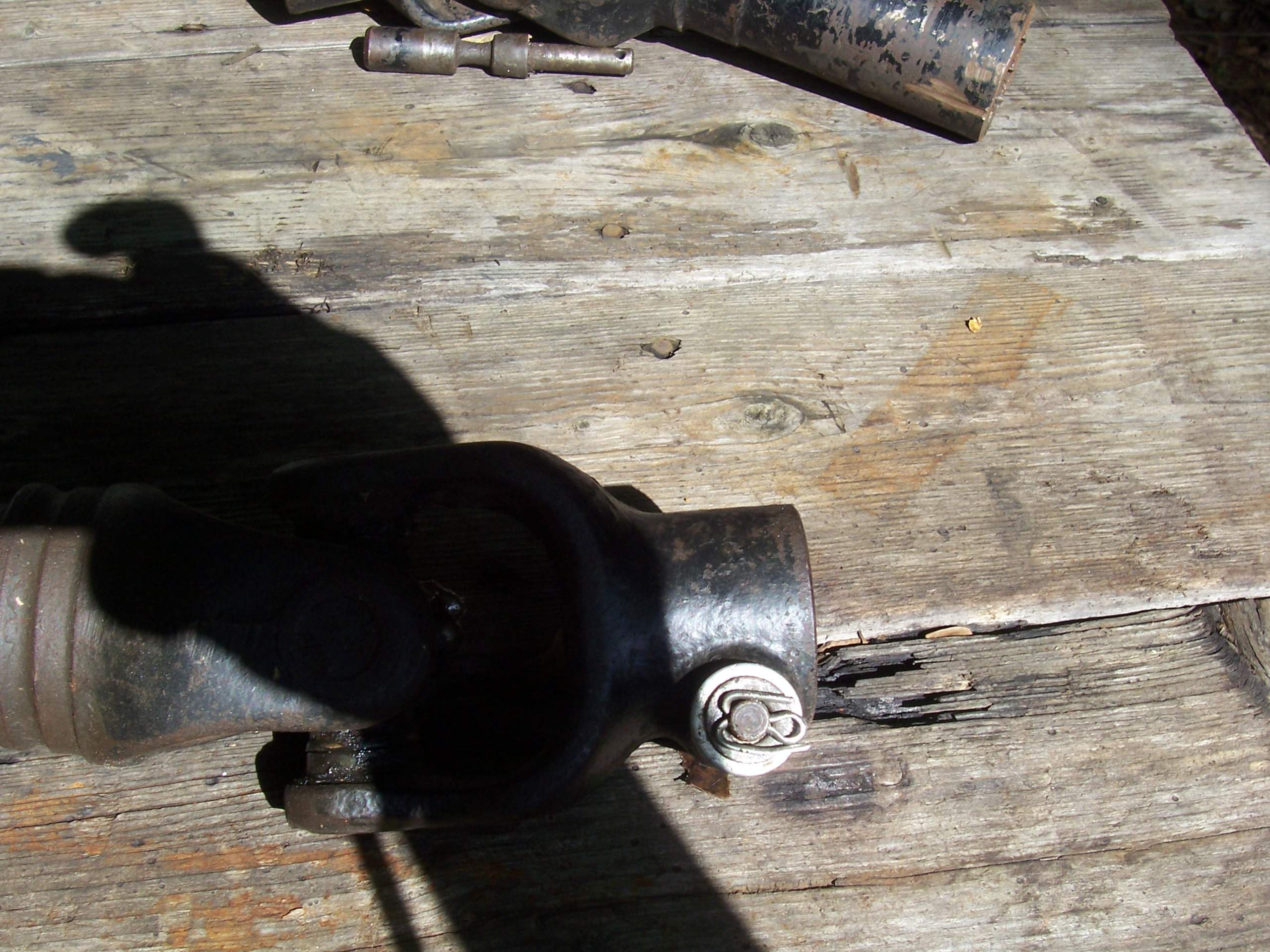

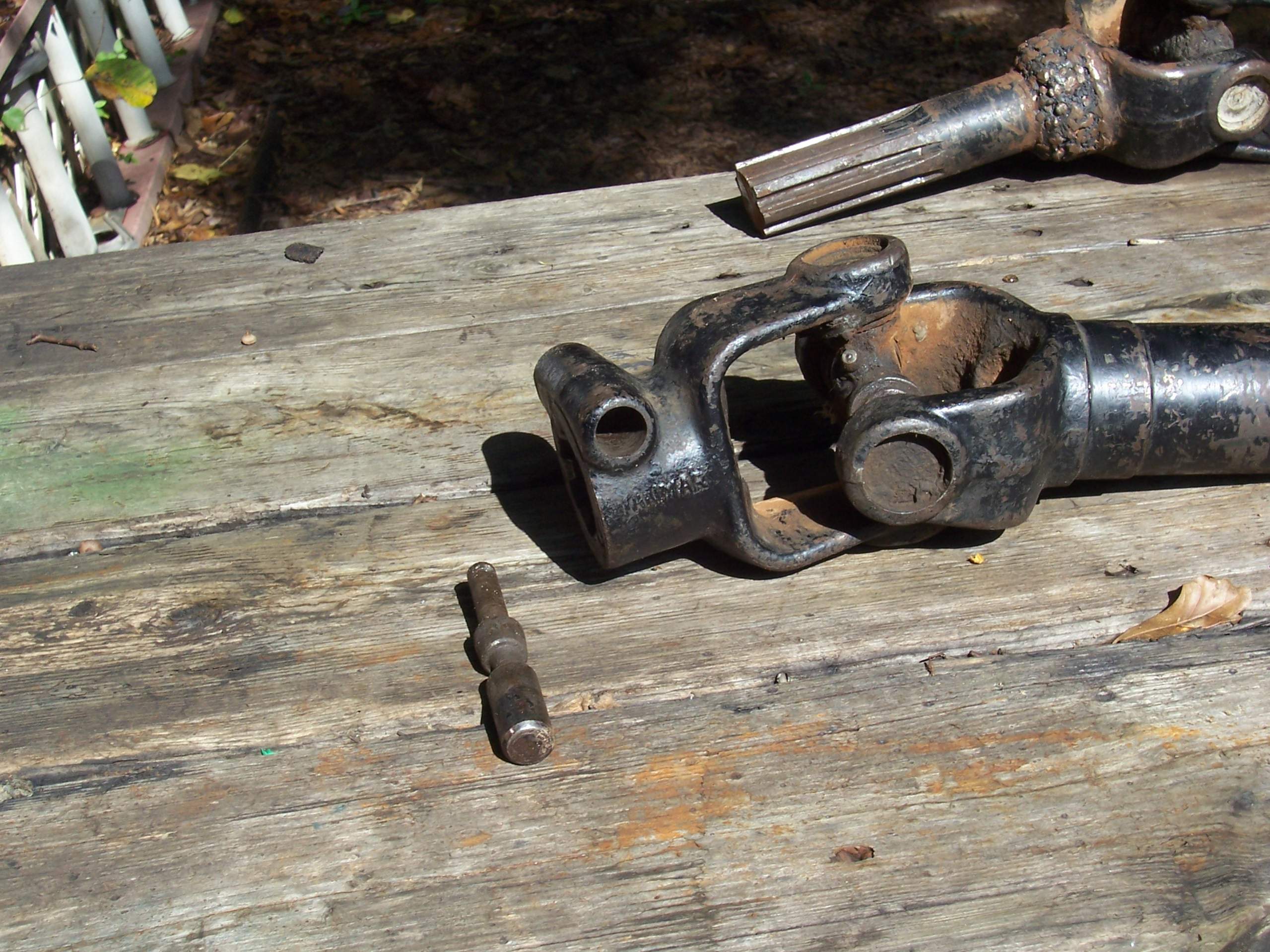

If your bearig is bad than don.t worry about tearing it up any more just remove a couple of ball bearings and your puller should fit. So while I have these old picks out. Check out just how bad the wrong shaft was. I had to remove so much and had to cut out and weld it back together. and if you look hard enough you can see I even had to cut off the female side of the shaft. They finaly gave me another Shaft it just took them 2 Wks. and I got tired of weighting for it and thats how I was able to catch the bearing also. :confused:
