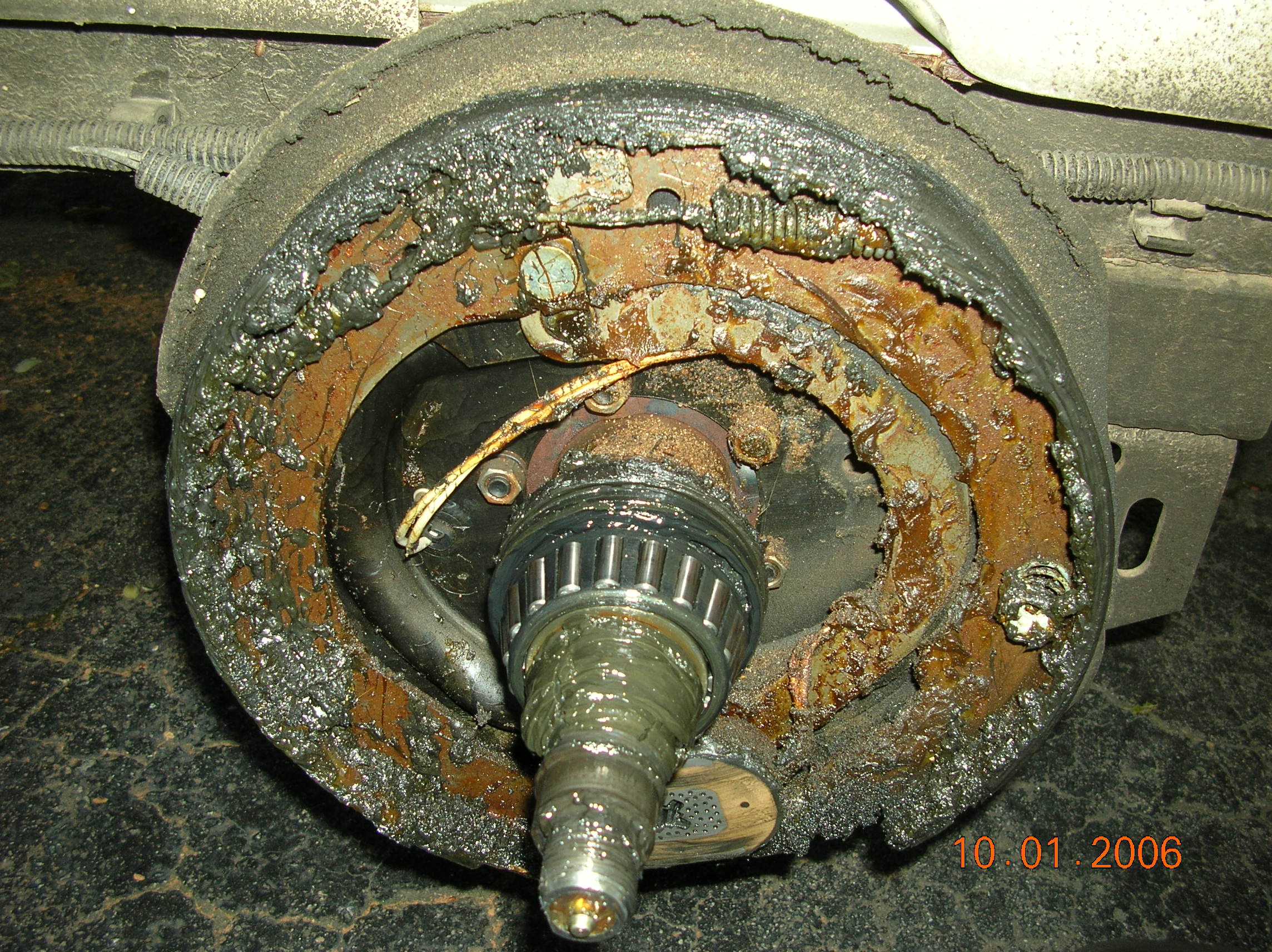

I never grease the Eze-lube axles. They depend on the rear seal to contain and direct the grease.
If the rear seal blows out the grease is pumped into the brake area of the wheel.
You don't want this ... View attachment 339386
