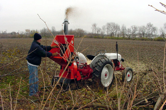

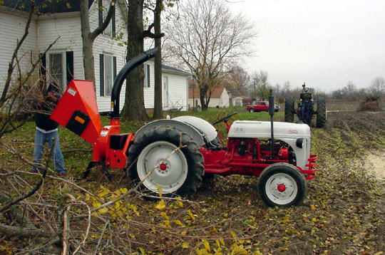

I have had the Bearcat 73454 for a little over 8 years now. It is a self feed, and handles larger branches well. The smaller stuff or the end of a branch with smaller stuff can at times be more difficult to feed. At that time, I usually have to feed a larger branch in behind it to continue feeding. It is a good performer. I thought I saw a Bearcat chipper similar to mine at the farm show this year similar to mine but with a mechanical auto feed system. One thing I really like about my chipper is the high discharge chute. Easy to discharge into truck bed or into fence row. Philip.
