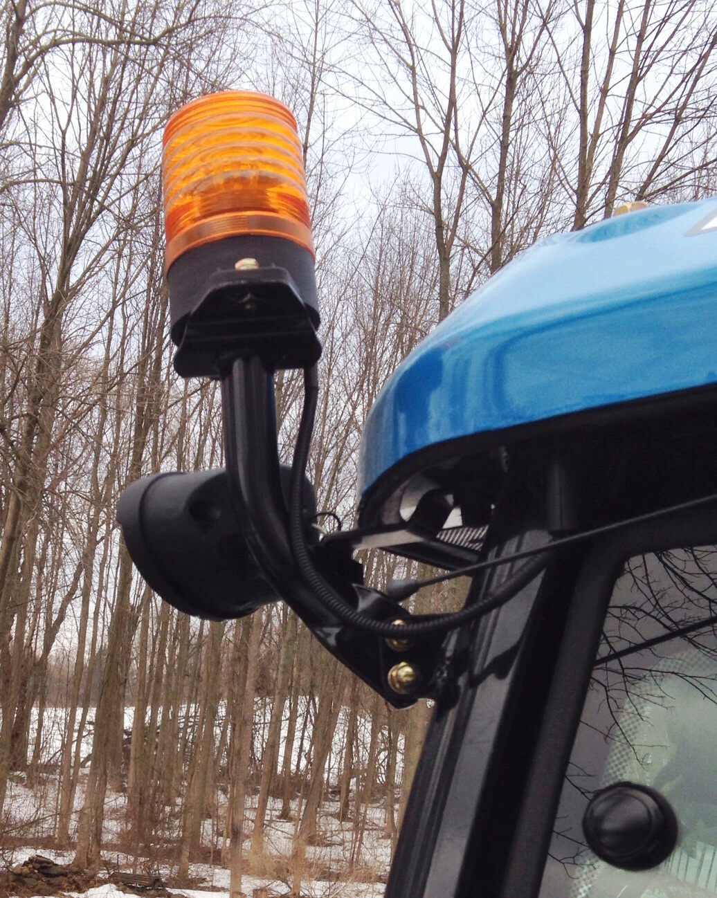

The technical name is a DIN ISO 4165 plug. That might help you find one. AKA Hella plug or Powerlet.
   / Beacon light plug #12
Did it have a special name or description? The one's I've seen at the auto parts stores here are all the standard size stuff. With this New Holland being made overseas, perhaps there are more than one standard size socket that are common in places other than the US. If it has a special name or description, it would help in the search.
The ones here are referred to as 'mini' 12VDC receptacle. Made by Mitsubishi.
   / Beacon light plug
#13
Thanks for all the replies. The "mini" plug that is referred to as the Hella or BMW was the exact info I needed to find something online. The BMW angle means there's (relatively) local options as well.
I'll go shopping soon. If this Hella / BMW plug turns out to not fit, I'll report back. Otherwise assume (during future searches) that this indeed did work.
   / Beacon light plug #14
Power let.com - plugs, wires, and accessories
   / Beacon light plug #16
The cover just flips and you insert plug.
BTW, CNH or NH part 86508819 12v male plug
   / Beacon light plug #17
Thank you all for your help. I found a plug!
Now, a dumb question, which connection is positive? There's no marking on it and i don't want the pump to run backwards. I'm assuming the positive it the middle post and the neg are the tabs around it? Is that correct?
   / Beacon light plug #18
+ in the center
