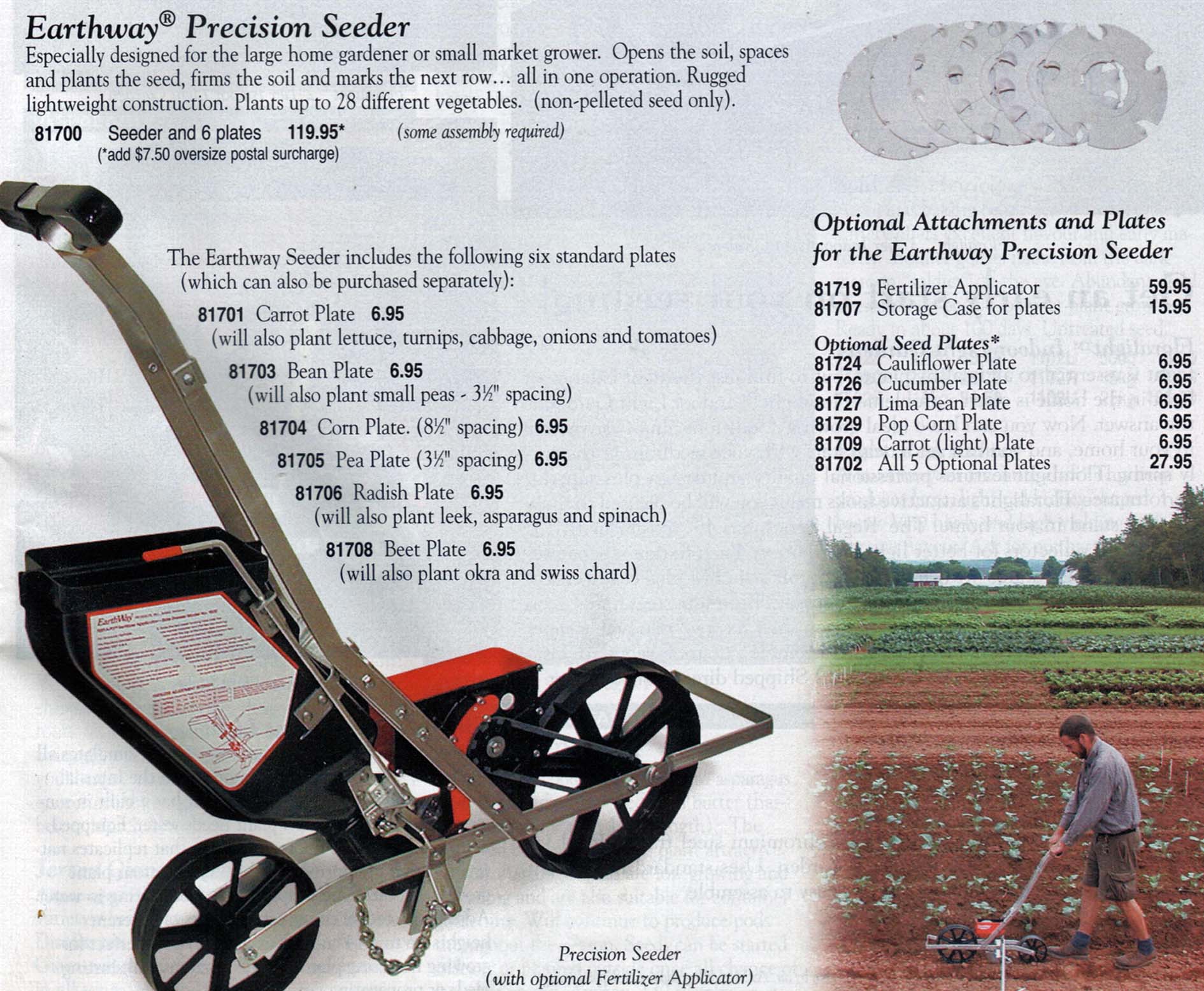

For help you! I joint pict of a small hand seeder. Onion seeds are very small.

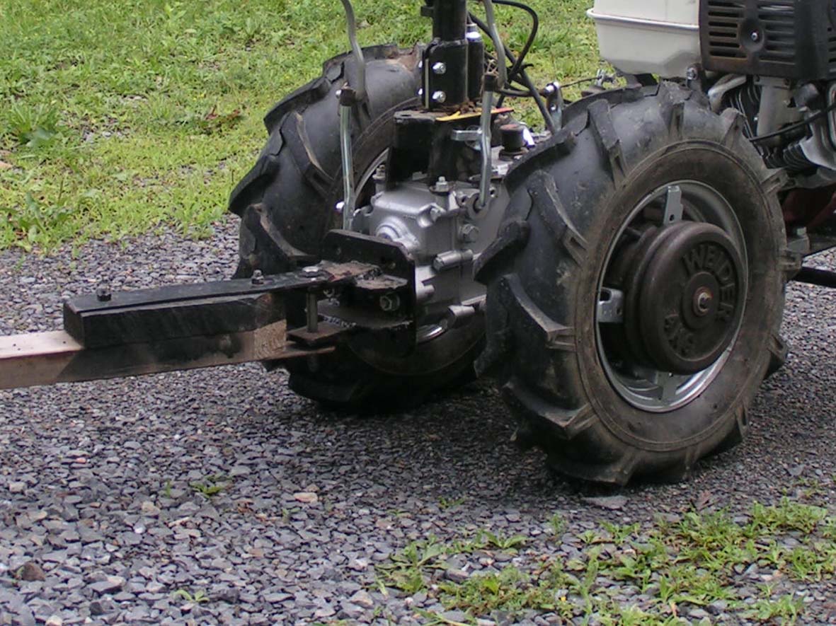

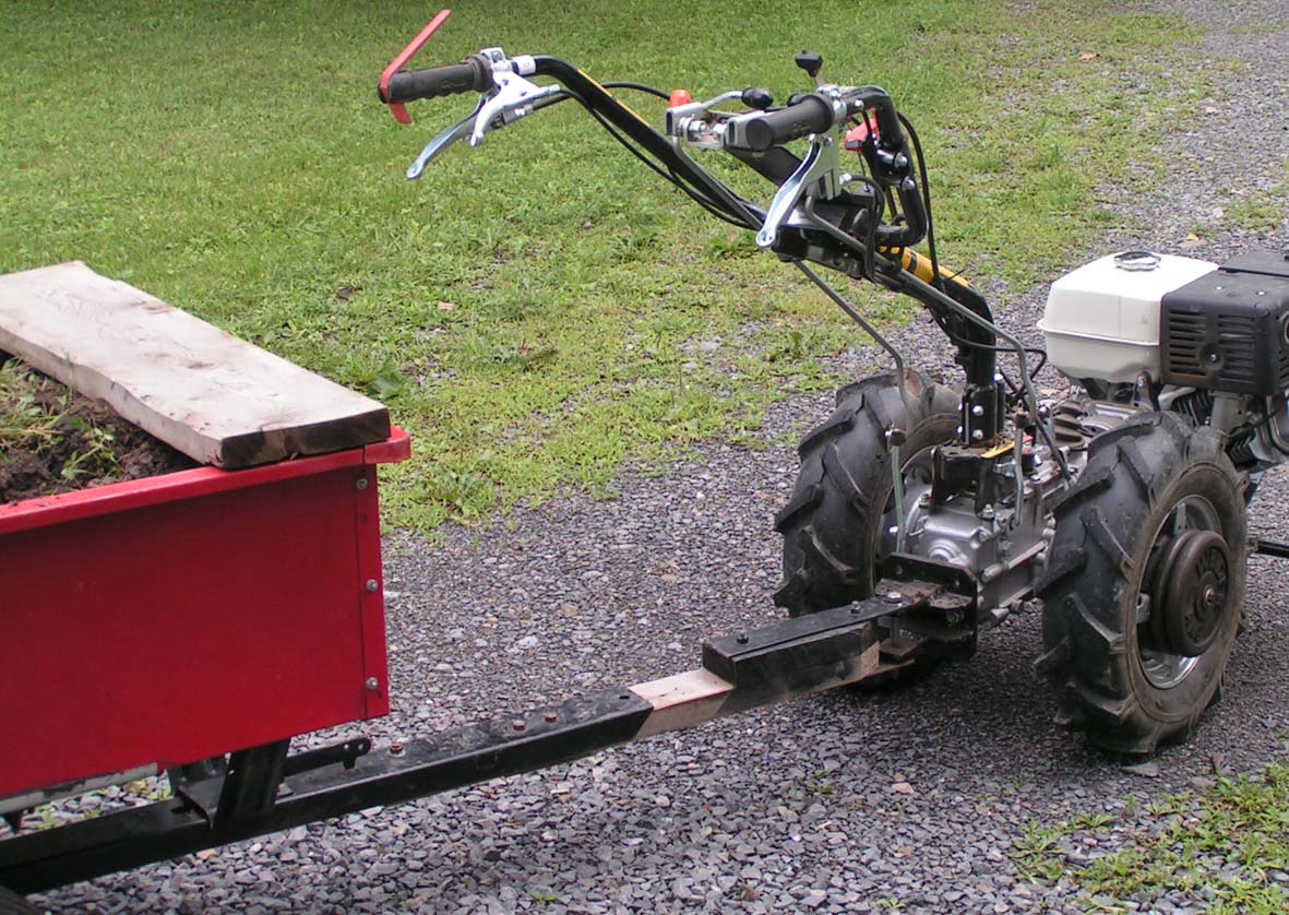

I joint also Picts of Home made trailer Hitch adaptor for my Grillo . Easy to make and work very well. Good Luck! Oldmech
