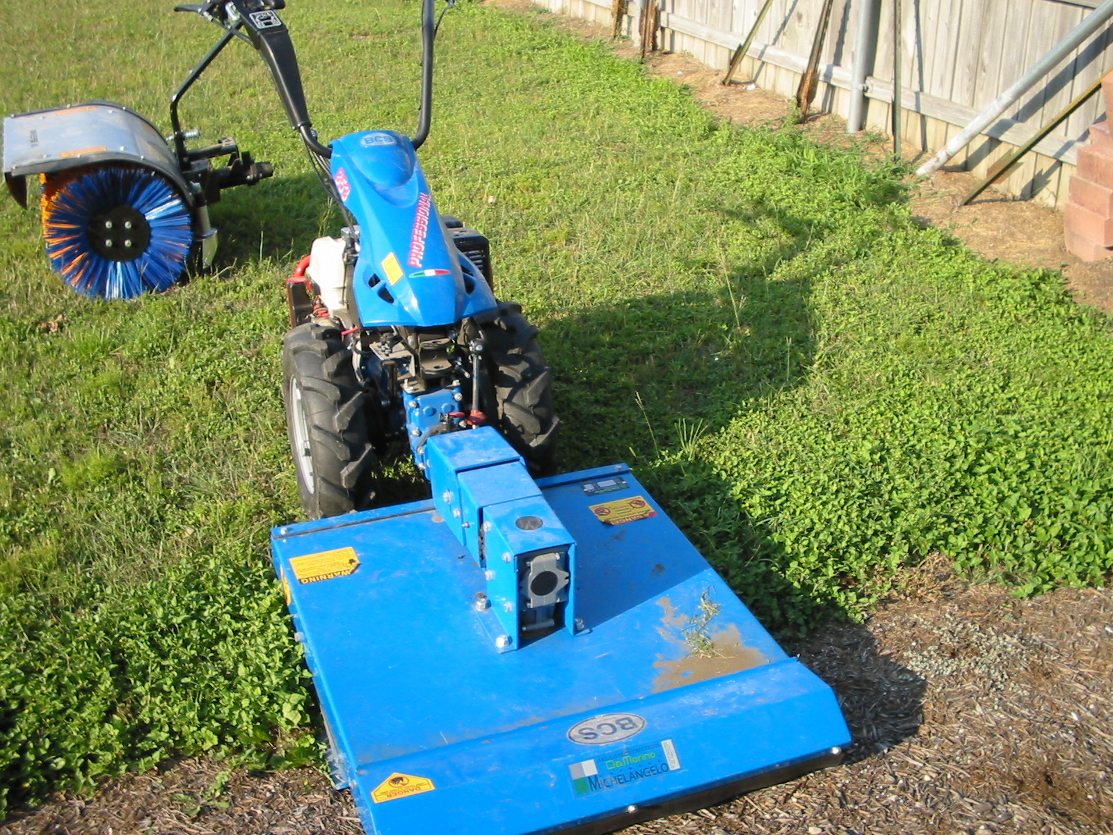

I ended up getting a BCS 853 with the rotary bush mower. So far it's been performing admirably, the brush is really high here, here's a photo of it chomping up 6 foot tall stinging nettle. Can confirm this thing blows through small trees.
Ideally I would have the BCS bush mower, sickle, flail and finish mower for this property... but between this and my lawn tractor I can cover most of my bases.
/ BCS Bush mower questions #17
That's a beautiful sight. If you keep whacking away on a regular basis those weeds will give way to grass down the road. Then you could get a finish mower for places your lawn tractor can't get to. (If you have any such spots.)

I do indeed! I hope to get the finish mower + wheel extensions for some steep spots on my long driveway that are unsafe on the lawn tractor.
I hope to put a big garden here someday, or at least convert it to anything other than a huge nettle patch. :laughing:

ottawarob:
Looks a bit like mine. :)
Hoping you can answer a few questions.
1. Can you attach a photo of the gear oil dipstick? I have a lonely thread here: http://www.tractorbynet.com/forums/2-wheeled-tractors/382066-bcs-853-gear-dipstick.html
2. How easy is it for you to get the mower started? Do you bump the clutch, if so how many times at what RPM? Another thread with questions here: http://www.tractorbynet.com/forums/2-wheeled-tractors/380825-bought-used-bcs-853-need.html
3. Any experience with using a stationary attachment, like a chipper, and keeping the operator presence control engaged? Yet another thread here: http://www.tractorbynet.com/forums/2-wheeled-tractors/382067-bcs-853-operator-presence-control.html#post4808708. At this point it really looks like a rubber band or hook and loop strap is the answer. Pretty cheesy for the cost of these machines... :(
