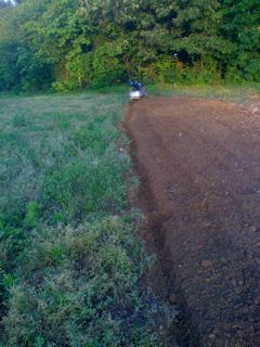

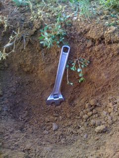

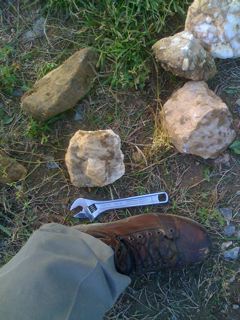

Berta Swivel Rotary Plow (flip over double) in wet and rocky red clay. It rained approx. 1" the night before and would have been too wet for a tiller. The Berta's stone guards were left on as per Earth Tool's recommendation. Large stones are thrown with the tillage. Twice the tractor cut-off with a wedged stone but the stone fell out on its own before restart. The third time a relatively small, flat stone shaped just right wedged tight and had to be removed.
The Berta makes beautiful tillage in this wet, red North Carolina clay and is easier to operate while plowing along than a tiller as it does not require down pressure and there is less bucking and jumping when hitting stones. Notice I said while plowing as this swivel Berta version is more work at the end of the row flipping over the swivel plow. A single direction Berta would be less work for the operator other than more walking. I bought the double direction Berta because of hillside plowing. I ran it at half throttle in first gear while picking and flinging stones aside. It will plow at full throttle in second gear (BCS 853) but the wheels slip because the tractor is trying to move forward faster than the plow can eat up soil. In a looser soil like loam or sand, it would probably move along just fine in second gear at full throttle.
Beautiful tillage and a lot less trouble in rocky soil than a tiller. I can see why the Berta is less dangerous (tiller jump) and less work in previously un-tilled land like a long-time pasture or lawn. The Berta plow is a keeper!
