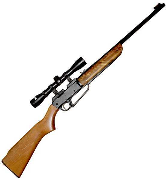

I have a cheap, Daisy model 880 pump air rifle. It holds 50 BBs or single shot pellets. $55 today's price on line.
I put a cheap air rifle scope on it. It is surprisingly accurate.
I use it to scare squirrels and groundhogs out of our garden. Just a couple pumps and pop them in the rump. They jump and run and come back later. I'm sure at 10 pumps and a head shot it would kill a squirrel or rat at 25 yards.
