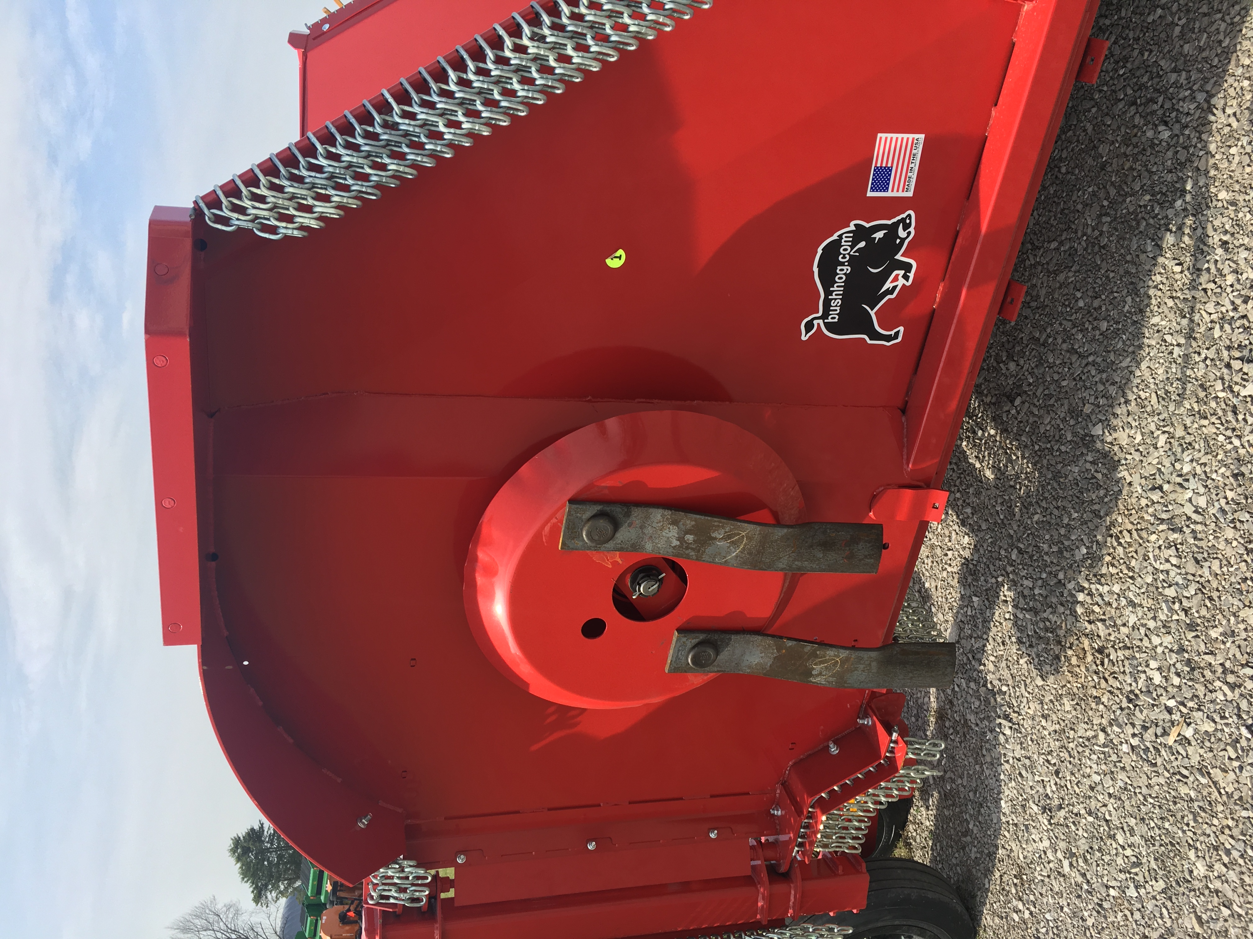

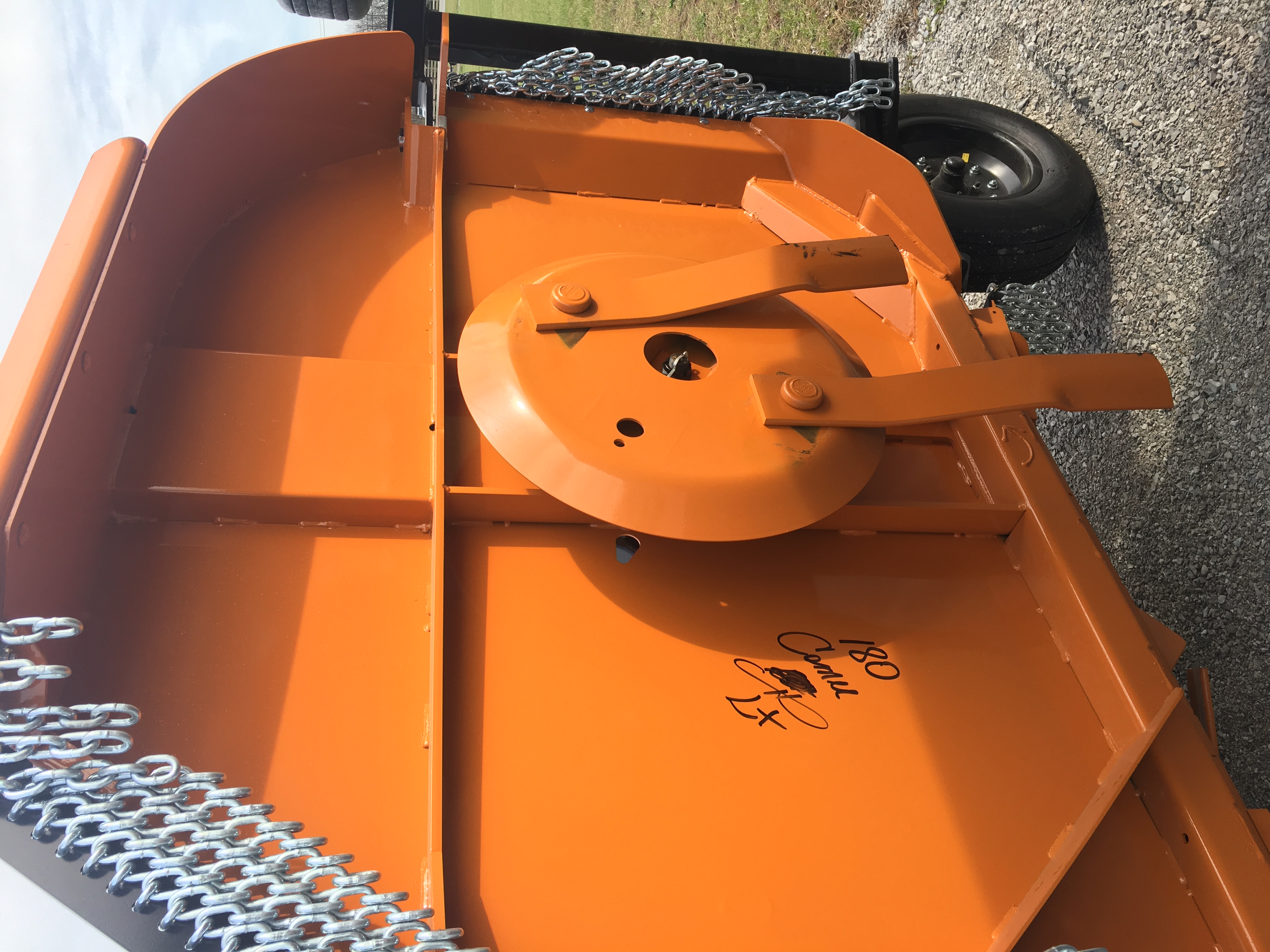

I went out and looked at some batwings this morning.
Woods, Land Pride, a single Bush Hog.
Any thoughts on any of these would be appreciated. I won't be needing these for brush or trees. But for pasture only. I have no knowledge of Land Pride, I've heard of them, and this machine looked decent, but the spindle looked less beefy then the Woods.
One thing I noticed is differences in the underside. Both Land Pride and Woods have several struts, braces, etc "cluttering up" the underside. I think they are calling them baffles, but they are simply structural. The Bush Hog was essentially smooth, with only a single bend. What are your thoughts on cut quality and size of discharged material? I can think both ways and have no knowledge.
View attachment 503402View attachment 503403
And Ken, I'm certainly not opposed to a used machine. I have some things going this week, but if I get a little more clarity, I might come down and take a look. Is it 540? What tires?
We researched several and found some had a smooth deck on bottom while the structure was on top. Some were reversed like the Woods. Bear in mind, seeds and chaff will collect on top of the cutter too. The smooth top helps, but it still accumulates. It would be that much more if the pockets are on top. If you store outside, the structure pockets will collect water and the foilage will absorb it and keep it wet which leads to rust. We use a leaf blower to keep the top clean.
I would tend to think the smooth cutting deck would give a better cut, but I wouldn't know since I don't have one to compare with. Unless your cutting heavy damp stuff, you'll not have a problem. We've cut wet and while it does stick to the bottom braces some, it's not to the point where we have to stop because of accumulation. Good thing with a BW is you raise your wings and clean off.
