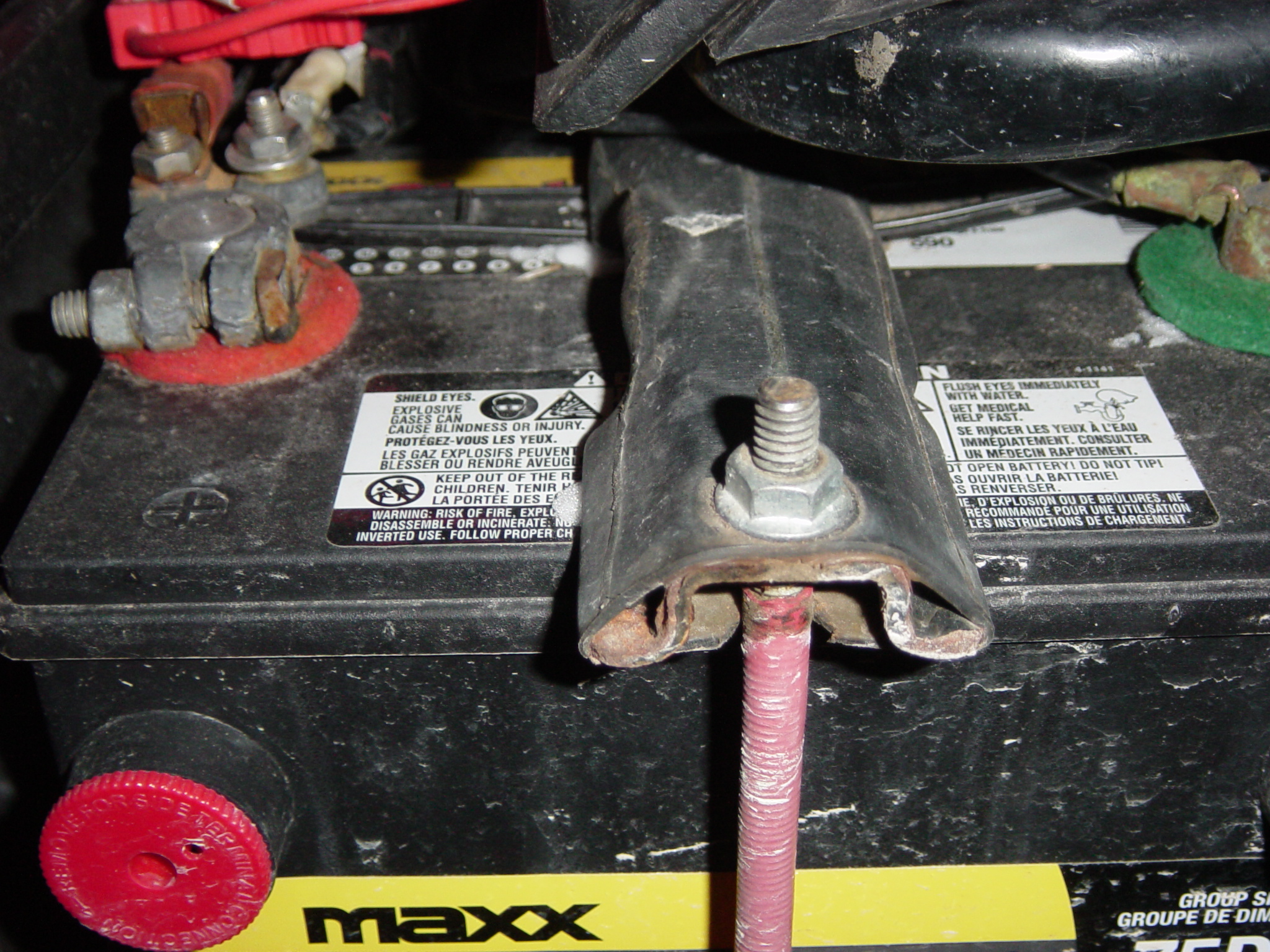

I check my equipment periodically, but this surprised me! The battery is less than 3 years old and I check electrolyte levels every time I change engine oil. There were some signs of corrosion beginning about 2 months ago, so what is causing this? I have the felt washers on the terminals and the red battery spray coating as well. I don't have any problems with the electrical system and it starts just fine. The corrosion is on the positive terminal primarily. There is also some on the battery holddown and very little on the negative terminal. Over the last 6 months there have been many 3 mile trips - about 4 per week, but at least once a week into town which is 30+ minutes and I don't see an issue with the charging system (or maybe I missed it?)
This is of an 2012 F250 diesel with 2 batteries, the other one is not nearly as bad. Any ideas as to what is causing this and what I can do to stop it? My searches on the internet indicate that it is probably a failed seal around the post.

This is typical of out gassing. It will not stop.
Keep an eye on it and keep using baking soda and water solution to wash it.
Then replace with new felt washers and respray with the red protectant.

Based on my limited experience, I recommend finding a good quality replacement for the battery.
On my tractor, the original battery never had corrosion problems. When it needed replacement, I bought something cheap at TSC. It only lasted a couple of years, and I had chronic issues with corrosion. I replaced it with an Optima, and I’ve had no problems for several years.

You don’t specify the type of battery but I can assume from your comments it is a non sealed lead acid battery. Any non dealer lead acid will tend to “leak” or “seep” battery acid as you bounce around in the tractor. It’s the nature of the battery design in conjunction with the tractor itself.
Once a little acid is out of the battery it’s difficult to wash away. You will need to neutralize anything the acid has come in contact with.
I’d recommend replacing the battery with a sealed lead acid at a minimum and and AGM would be better- but not necessary. Neutralize everything around the battery so the acid is no longer causing damage. Repaint anything with damage. Then coat the battery posts and lugs with Vaseline (as mentioned above).
As a part of your routine maintenance (which it sounds like you have a good schedule) neutralize the battery and surrounding area with a home made (baking soda and water) or commercially purchased product.

I forgot to attach a picture of the corrosion. This is the only terminal out of 4 showing corrosion (qty of 2 batteries in the vehicle). So I'll be replacing the battery tomorrow. The holddowns are corroding as well.

And that is exactly why I do my hold downs the way I described. That's nasty! Is it possible, some batteries just develope cracks around the terminals?
You said you check the fluid levels. You don't over fill them by chance?

Have you checked your charging system to make sure you're not overcharging those batteries? That much corrosion seems to me it's indicating way above normal out gassing. Either bad battery, or overcharging (cooking) is what I'm thinking. And my gas powered '12 F-250 doesn't do any of that. It's a single battery setup, and I just put in a new AGM battery last winter when my original OEM Ford battery died.
Random thought added...
Are you *sure* you're getting all the old corrosion off completely before you put on the new felt rings and spray the protectant on the posts? That spray will only work if the posts and cable terminals are completely clean first. There are spray foam cleaners you can use first, to kill the chemical reaction going on, and get all the corrosion off, before you spray the protectant on.

First time this has happened on this truck and on only one of the two batteries. I plan to be sure it's clean down to bare copper. I've got a toothbrush small brass brushes and sandpaper ready as soon as I get a replacement battery this morning.
