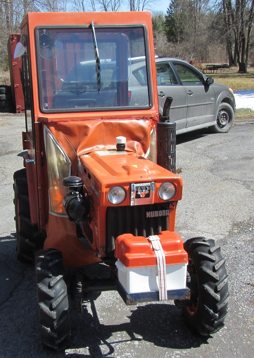

My friend never regretted putting a heavy battery out front on his B7100.
His strategy is to regularly install a new battery in his car and put the car battery in the Kubota.
That way in very cold weather the car always starts. The Kubota is very happy with a slightly old battery with far more CCA's than would be available from a proper battery fitting under the hood.
Dave

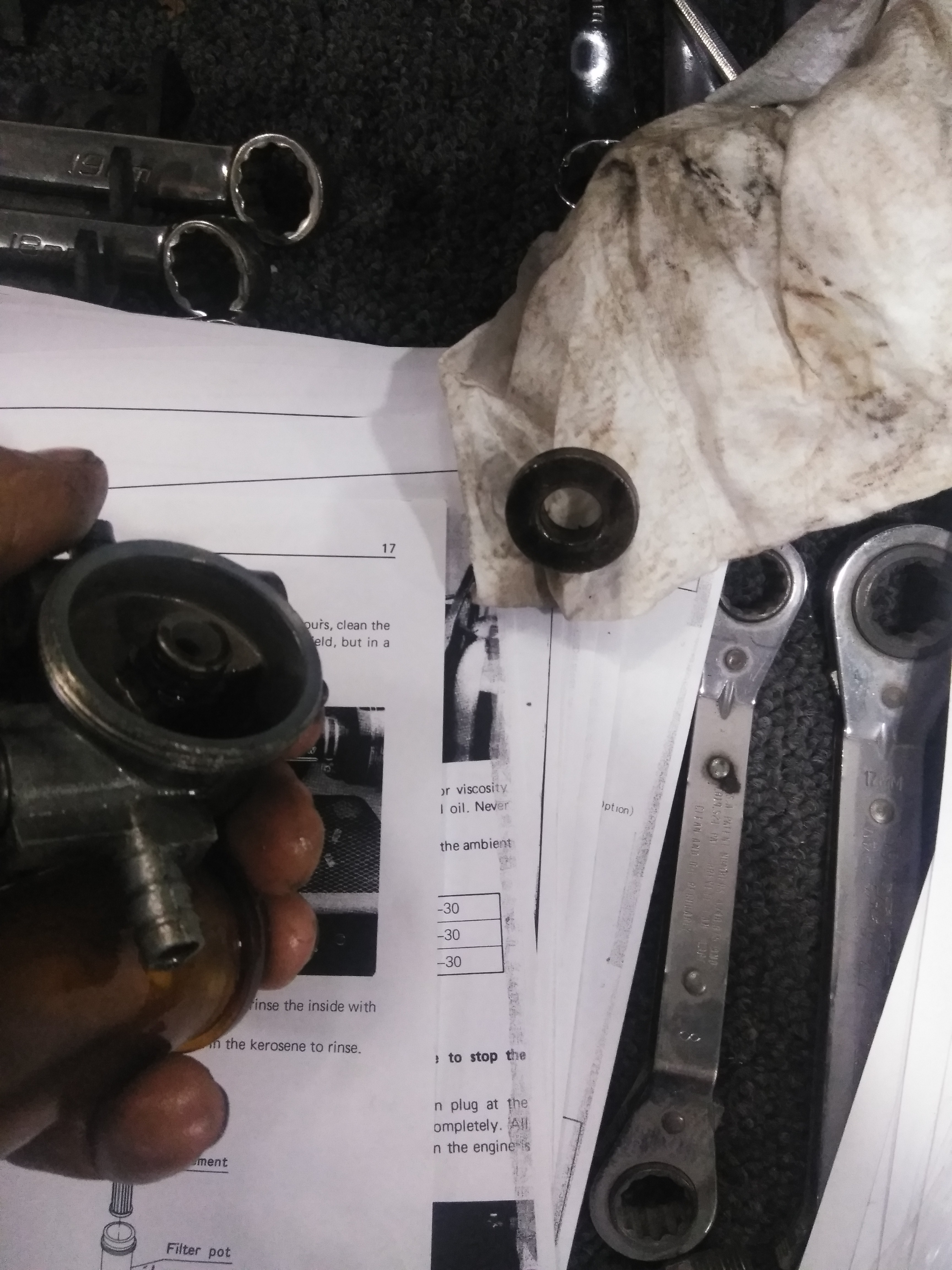

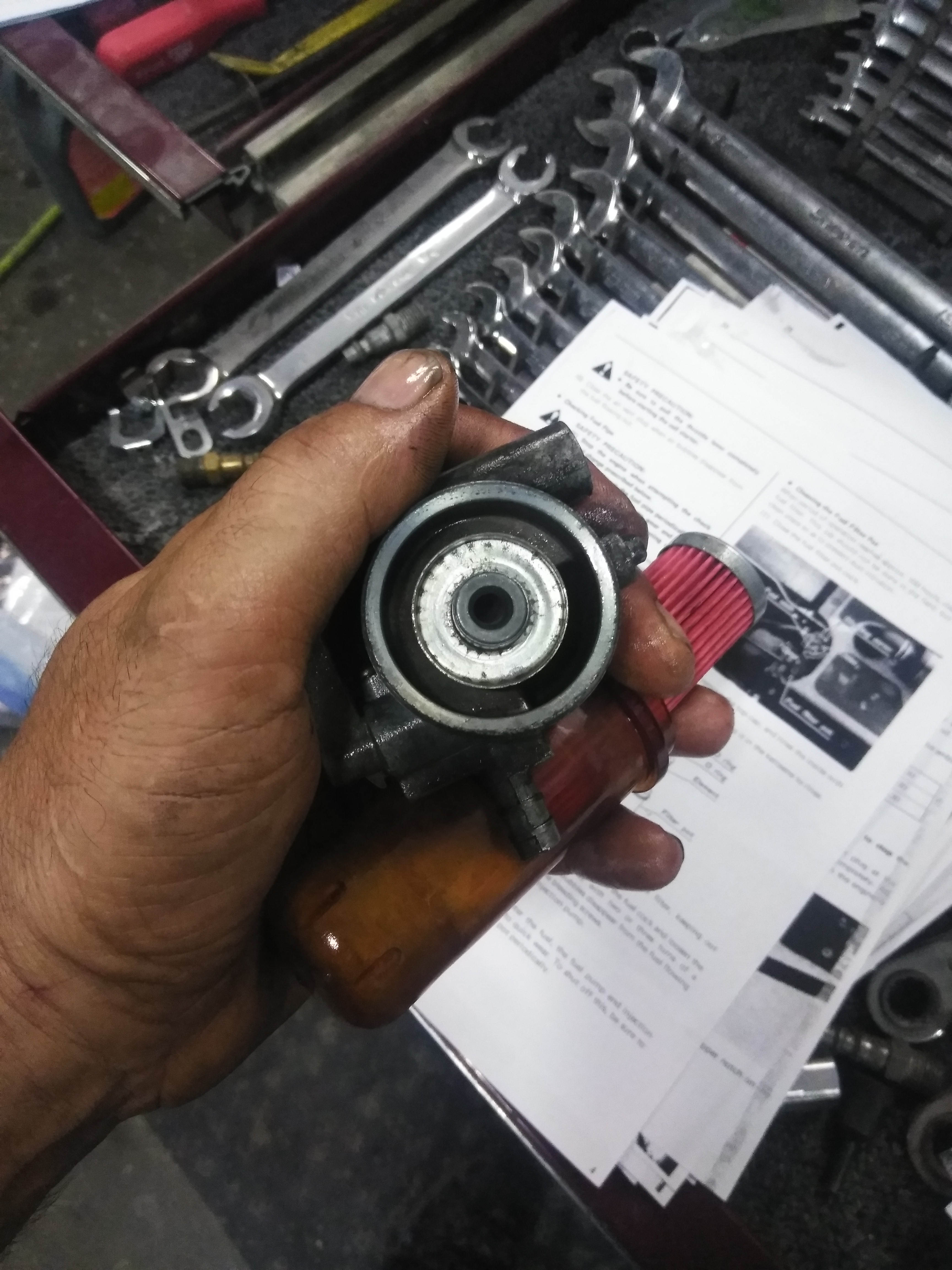

Ive finished doing most of what I needed and should have done to the B6100 when I purchased some time ago, Ive greased everything, changed all the fluids, changed all the filters, got the electrical figured out so all the lights work and even the horn.
It has a hazard switch, not sure how that is supposed to work, it does nothing at this point, I have one aftermarket light on right side that comes on the moment the key is on and I have a left factory tailight that comes on when I turn the lights on.
Not sure how a hazard is supposed to come into play.
One of the fuses had melted itself into the plastic casing so there was no contact with the wire end, after finding and fixing that all is well.
The fuel filter gave me fits to remove ( as in I had to forcibly extract from the fuel bowl ( Im assuming mines been replaced since its plastic )
Someone had left the cap of the old fuel filter up inside of the housing, I didnt figure that out right away myself, the small rubber O ring was shredded down inside the fuel bowl, all this time and for who know how long the fuel system hasnt been filtered because of this.
I also replaced the fuel lines since they were not pliable.
Did a bit of welding repair, the draw bar housing was broken in two where it contacted the diff and the fuel filter housing bracket was split nearly in two as well requiring repair.
Lots more was done that Im sure Im forgetting
Anyway I still have more questions, Ill make another topic and put them there all together. Thanks to everyone

I need to add that is one great looking tractor, Id like to see more pics
