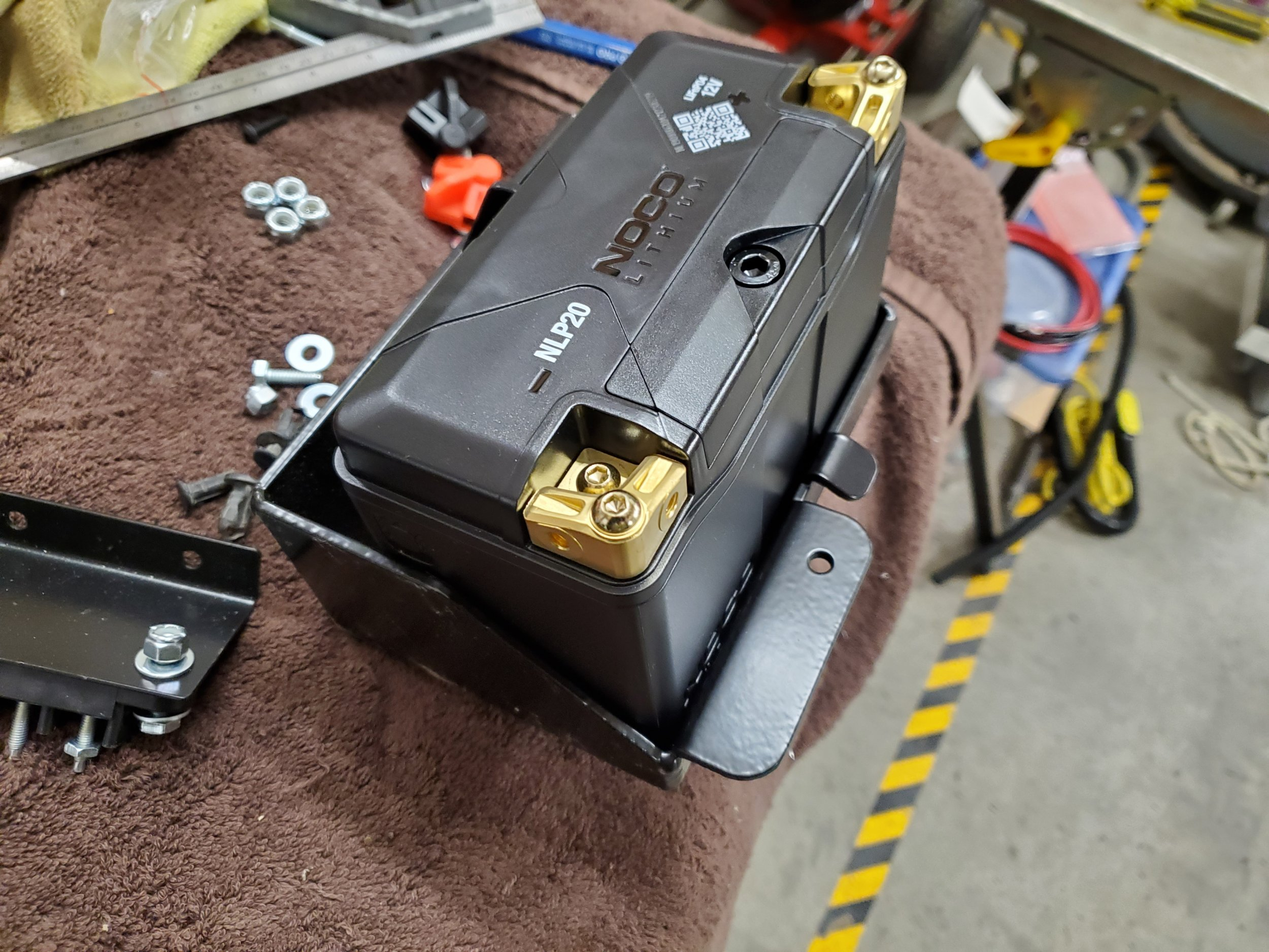

I've installed the QuadLogic battery relocator kit for bigger battery on my '16 Polaris Sportsman 450HO and would like to know what the "bigger" battery size is. Has anyone done this? I'd like to go with a SLA/AGM battery with more power than the OEM battery. Maximum battery size that will fit is 6-7/8" long x 3-3/8" wide x 7" tall. I can't find a battery that size.

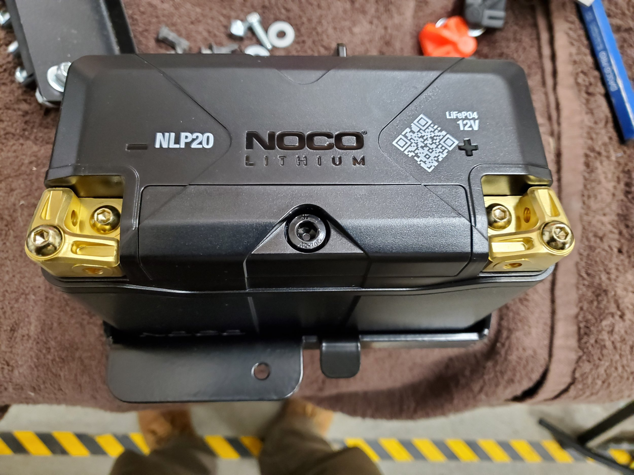

Well I guess either there are no experts out there or no one has tried this. So here is the answer for any interested parties - it's a group 20 size that is the "larger" maximum battery size that will fit this application. Instead of going the SLA/AGM route I opted to try the NOCO lithium battery. The specs led me to believe this is too good to be true, so we'll see.

I've done a little homework on this. Yes, they do take a special lithium charger for quick charges but they are 100% compatible with regular vehicle charging systems. It has built in battery management circuitry with cell balancing, something that isn't in SLA/AGM/flooded cell batteries. It weighs just slightly more than five pounds. The mod takes the battery from under the engine to inside the left rear fender, up out of the way and easy to get to. The kit allows for the much larger group 20 size battery of any type. This battery boasts 600 amps of starting power, but I don't know how fast that drops off. Lithium batteries aren't rated with CCa's. They are also rated as a class B fire, so my compact ABC fire extinguisher is good. But as I alluded to, the jury is still out.
