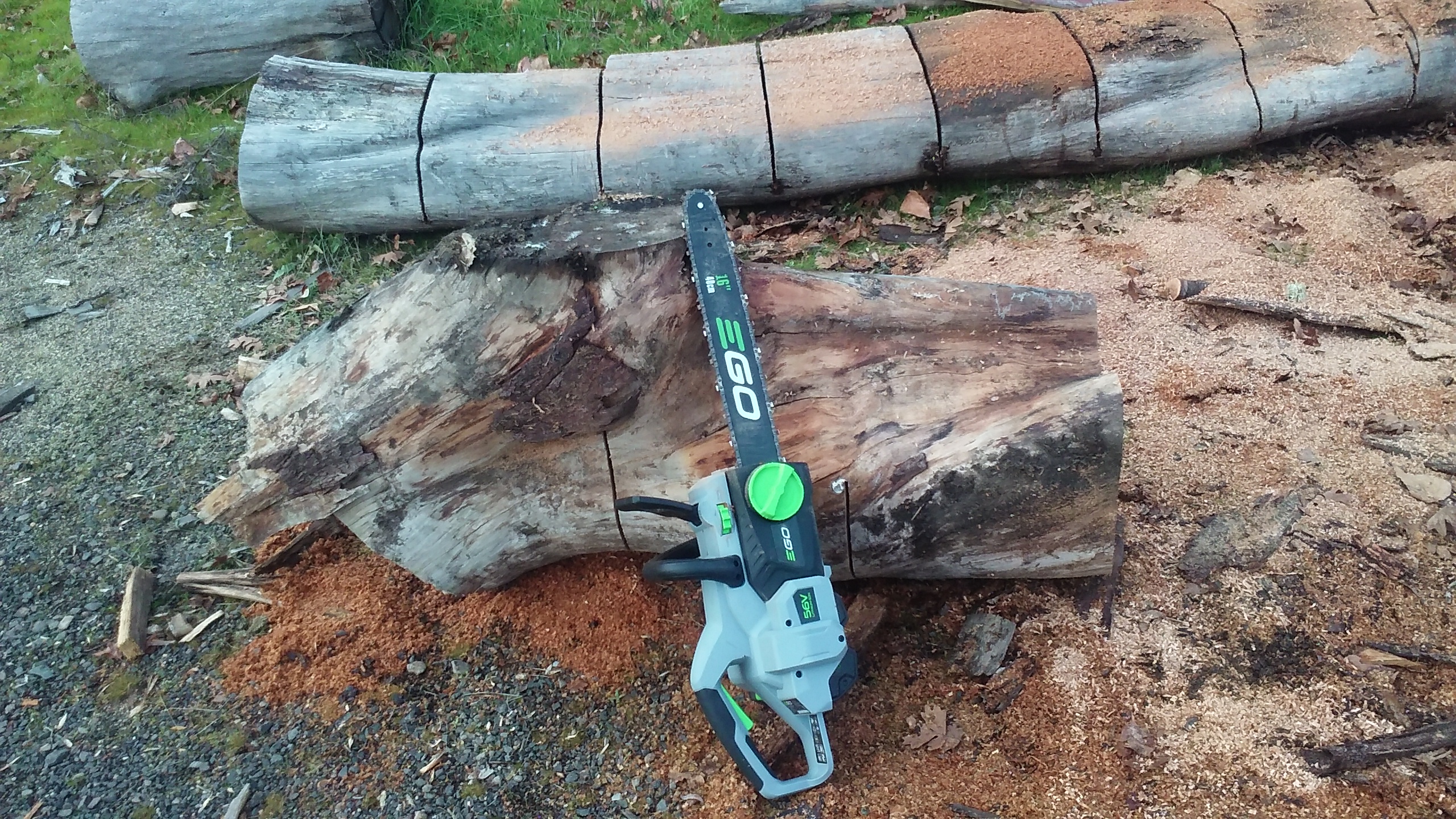

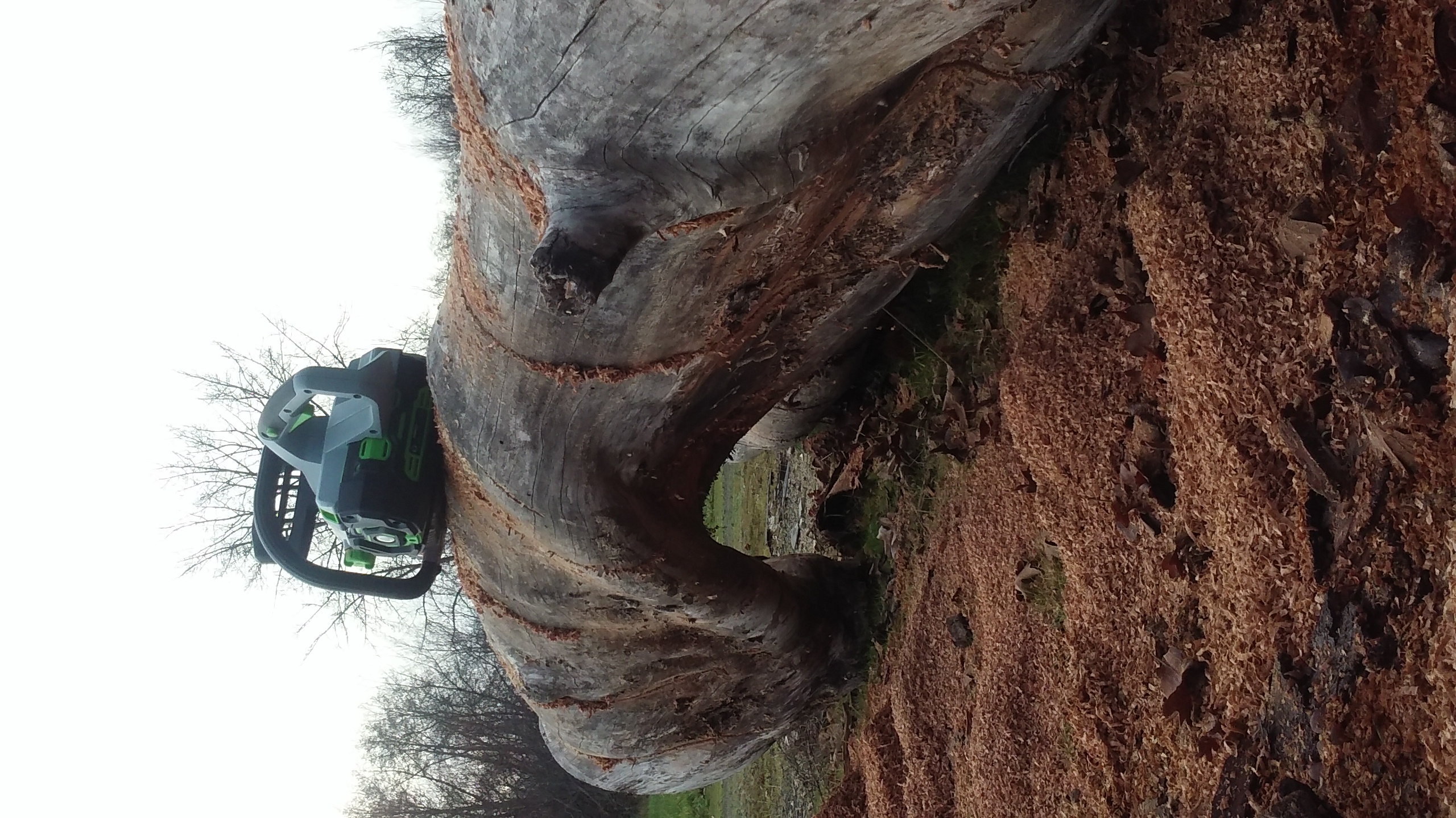

Ordered an ECO 56 volt chainsaw in 2017 - a return on Amazon including extra chain for $120. After I used it for a while, bought another returned one from Amazon for about the same price. Both still working well. I have cut down and cut up several 5-6 inch trees on a single battery charge. Admittedly I'm not a heavy user but live in a forest and have electric to handle downed limbs in the yard or mile-long drive. I do cut down some trees every other month or so. No issues for the electrics at all and am pleased I got them cheap since I've always had good luck with used and returns for expensive equipment. BTW, I have a Stihl Farm Boss for any really big trees, but use it only once or twice a year. Biggest challenge is keeping it able to start.
