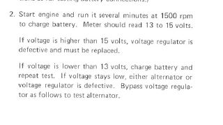

Today while running the disc for a food plot my battery suddenly exploded ! This is the second time I've had a battery explode in this yanmar.
Anyone else had the issue with exploding batteries ?

I've never had a battery actually explode but I know from experience that a defective voltage regulator can overcharge a battery and make lots of nasty eye-watering fumes. From what I understand those fumes contain hydrogen and are very explosive if they are able to pool somewhere.

Definitely sounds like an overcharge issue, especially if it's happened before. Hose the whole area down and douse it with baking soda, if you haven't already to kill the acid.
I just fixed that issue on my pickup (before any battery explosions), as numerous voltage regulators would still give me up to 18 volts at the battery. Turns out a corroded connector wasn't allowing battery sense voltage to the regulator; put a wire splice in to bypass the connector and am getting proper charge voltage now.

Just FYI, the old-tech mechanical contact VR's can sometimes 'go erratic' .... showing 'good' output for awhile then 'whacky' for awhile, and back again. Even if it 'tests good' I'd pull the cover and inspect for signs of worn/burned contacts, corrosion, etc and R&R if the visible evidence indicates.
Yes, a battery generates explosive gasses. An ignition source is required to ignite, often an arc at loose terminal connection when hit with the heavy starter load (the vented gasses ignite externally and that runs to the gasses in the confined battery headspace = battery explosion). Another reason to ensure that post connectors are always good-n-tight.
More unsolicited FYI ....
The solid state VR sold by Hoye is definitely a quick and easy and modern-tech (long lived) replacement.
The mechanical VR can still be found by google searching the (likely Hitachi) PN on your defunct VR (~$20 vs ~$70).
IF for whatever reason you need/want to replace both the alternator and the VR, it's very easy to install an Internally Regulated (solid-state) Hitachi 35A alternator to do the job of both (eliminate the external VR completely) for ~$50 (or less with a widely available RockAuto discount code). That assuming your 3110D / 3T84 uses the same alternator as the 336D / 3T84A-N. Let me know if you'd like the details on that swap/upgrade.

I just replaced the battery and checked the readings . Got out put of 16.50 volts output @2500 rpm's
I'll have to check my manual after while to see if that is within range, or if the output is too high
   / Battery issues #10
It seems high to me. I would not expect to see anything over 14.5 volts while charging.
