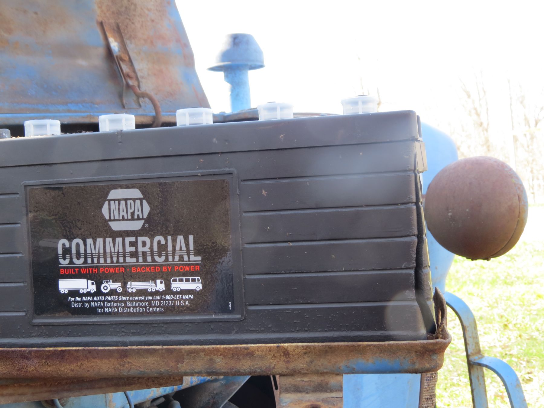

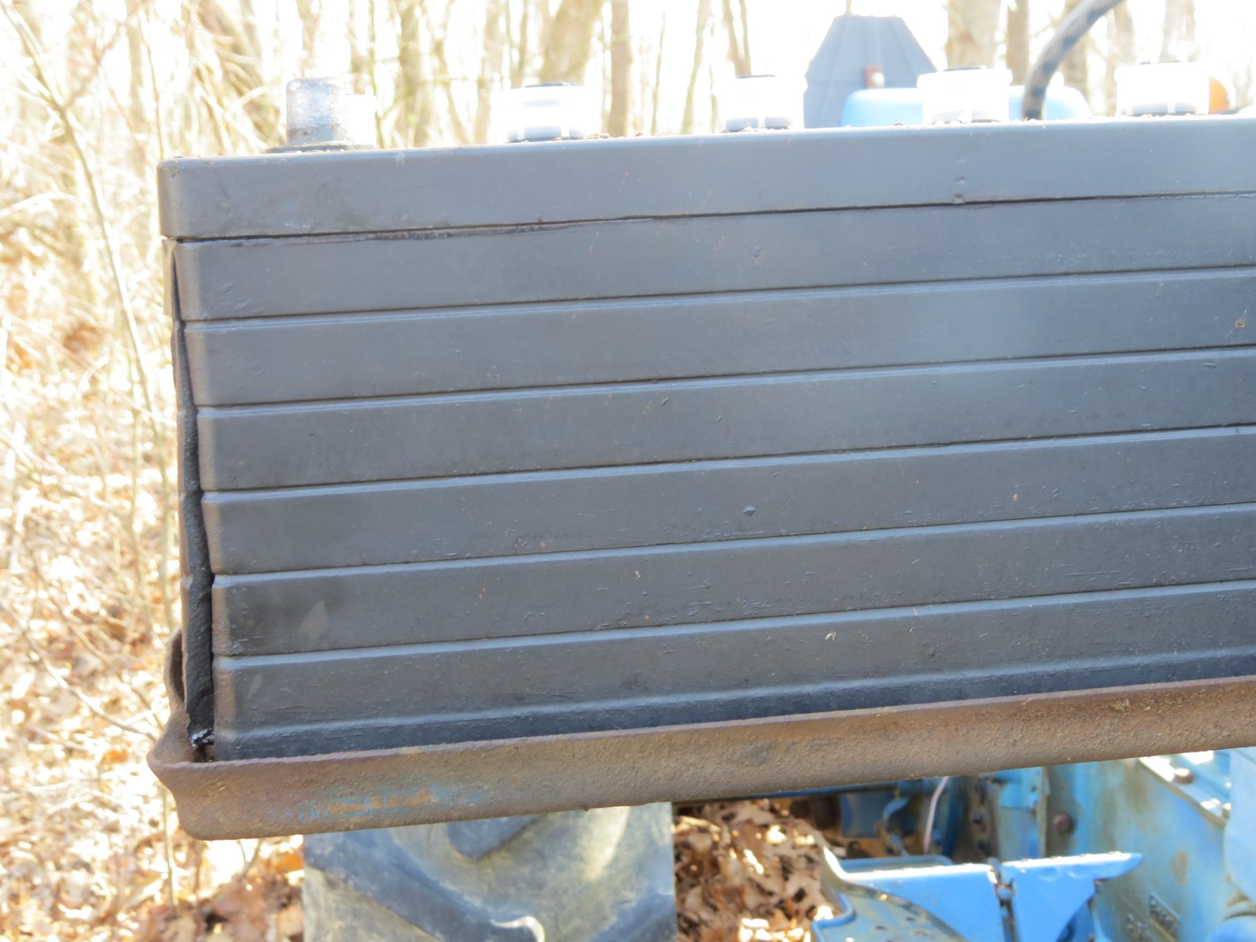

I went to start my Ford 3000 this weekend and the battery seemed completely dead and would not jump. I had not run it since December, I believe. I was removing the battery today to take into Napa to try to recharge it and noticed that the casing on one end was cracked and pushed out. I will attach pictures. The last cell next to this area doesn't show any electrolyte -- the other cells look OK. So what has happened here? Is the battery likely finished? Its a new battery bought last summer.

Froze over the winter.......
   / Battery damage #3
Yep, frozen.
A fully charged battery will not freeze, except in extreme conditions. (minus 76 degrees)
So, the lesson here is: Charge the battery, or run the tractor every now and then.
   / Battery damage #4
Yep, frozen.
Battery Minder, or Battery Tender.....much cheaper than new batteries!
   / Battery damage
Thanks guys. As I suspected from the appearance, a frozen battery. I didn't know batteries could freeze -- hadn't happened before and I've had this tractor 20 years. Expensive lesson learned. Next winter the new battery comes inside perhaps with a Battery Minder attached.
