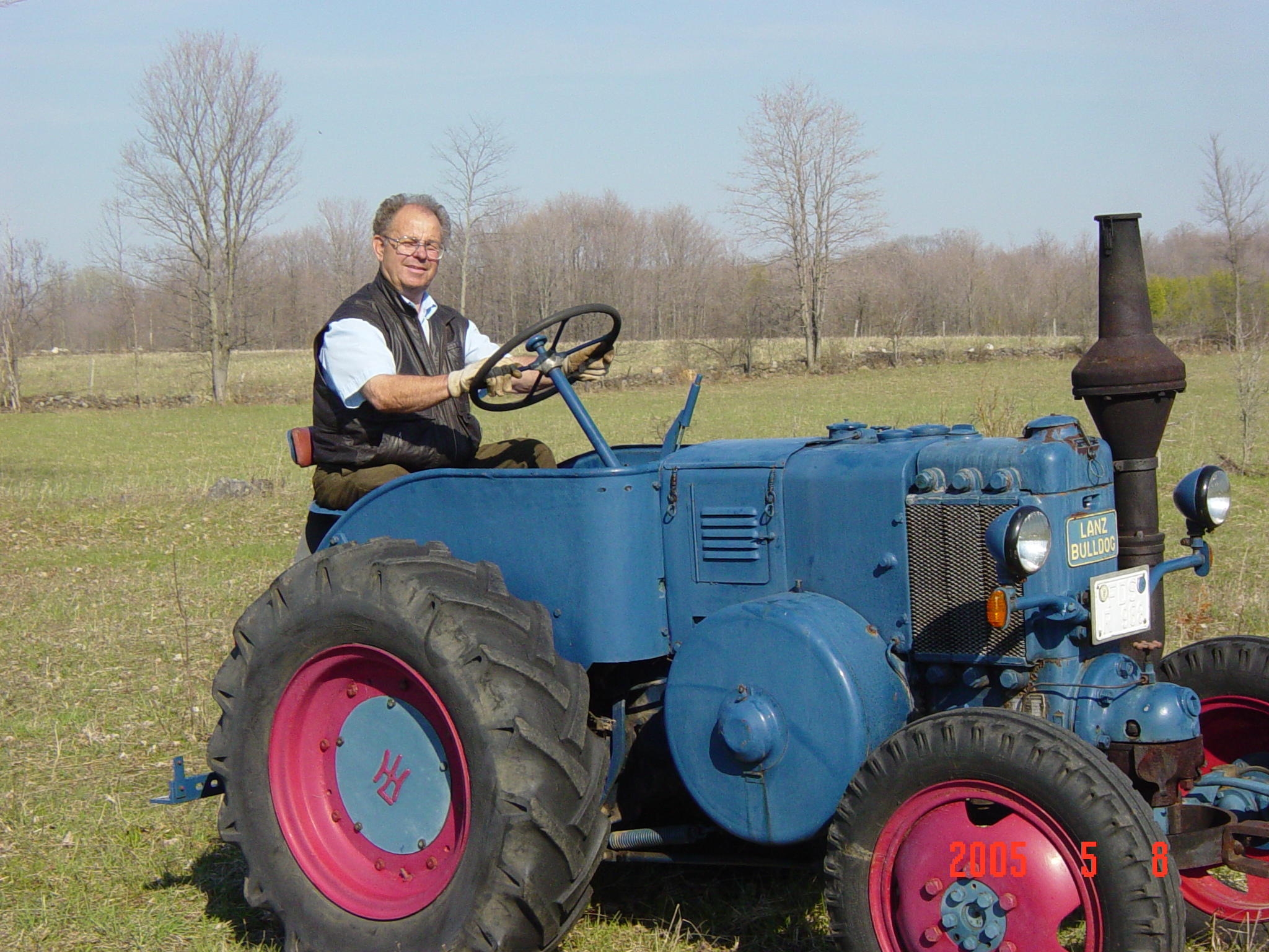

My dad told me of the starting procedure for a Lanz Bulldog long before the internet. Major preheat.
/ Battery Condition #45
I Know. A friend has one.
/ Battery Condition #46
Sweet, one step up for two steps forward, single that big must jump on every revolution.
