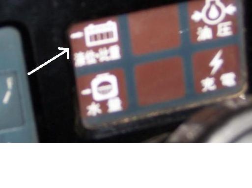

hey all, thanks for the feedback. lotsa good ideas to check... now, just to make sure what i'm talking about, here's a pic of which lite is glowing intermittently. The lite which glows, has the white arrow to it.
after verifying this in both my ym180 and ym169 owners manuals, neither of these tractors even have this warning indicator on their panel. If I guess correctly, this lite is warning 'bout a bad battery?!? maybe? The battery is new, has adequate water in it too. The only thing I can check for is specfic gravity since I don't have a hydrometer (right?). Also, I still haven't had a chance to hook up a test to the battery.. maybe tomorrow, it's raining like CRAZY tonight... Thanks again. -arthr

That's a low battery water indicator. Japanese batteries have a low battery sensor with 2 wires going to it. there should be 2 loose wires ending somewhere near the battery. Short them together, tape them up, and the light will stay off.
