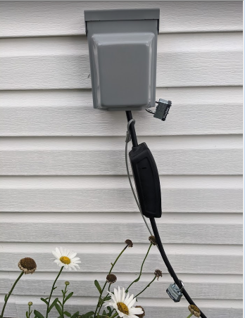

Nice! Can you take a pic of your wall charging system?
It's a very simple charging system. We bought this enclosed 50A receptacle from Amazon (30A-50A is the same receptacle) connected to a 40A breaker. The Model 3 already come with a NEMA-14-50P adapter for its charging cable so that's all we required. Wired a #8 3 conductors (red, black and white + ground) wire from the breaker box to the receptacle. We were already renovating/repainting so make holes in the drywall at the junction of the ceiling and the wall to pass the wire wasn't an issue. Distance was 85' so #8 wire was the recommended size for that distance.
Here's what it looks outside. Notice the lock on the box and around the adapter so it and the cable doesn't get stolen but can easily be removed if we need to bring the cable with us. The 20' cable connects into that adapter.

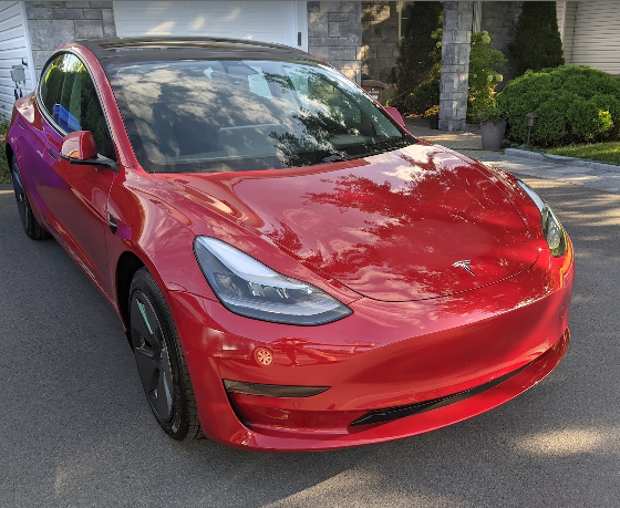

That is beautiful. I'm not sure I am brave enough to drive a red car but I would consider it or the dark blue.
Why is that?
Why is that?
I don't know. :)
I love the Nissan Leaf Deep Blue Pearl color that was new in 2016. The $2000 Tesla Red option is beautiful but having never owned a red car not sure that it would be a long term preference. Any new Tesla I think I might have it wrapped for protection but don't know the pros and cons or cost.
   / Battery based electric vehicles of today and tomorrow. #4,416
LOL, I thought because you meant red cars attracts more cops' attention than other colors. I did look for a protective body wrap and around here, it's 1,800$ for a full front body wrap.
