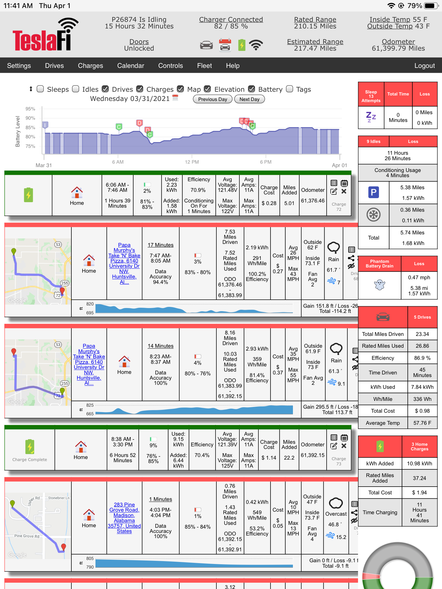

I'm curious about the math; this implies that on his drive, which sounds like about 36-45 miles (assuming that pickup got 10-15mpg), the Tesla is using about 4kWh.
The Teslas get about 30kWh/100mi according to the epa (+/- depending on the model); at that rate, 4kWh would get you about 13 miles.
So, I'm missing a factor of 3 somewhere.
24-30 kWh/100 miles from the power grid for Model 3. My Model S is 38 kWh/100 miles.
In-car display will indicate power drawn from battery, about 85% of what was put in.
Teslafi (a 3rd party subscription monitoring service) will try to tally cost.
