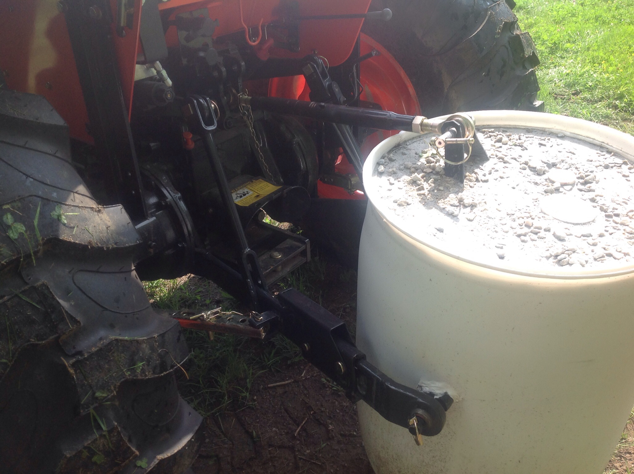

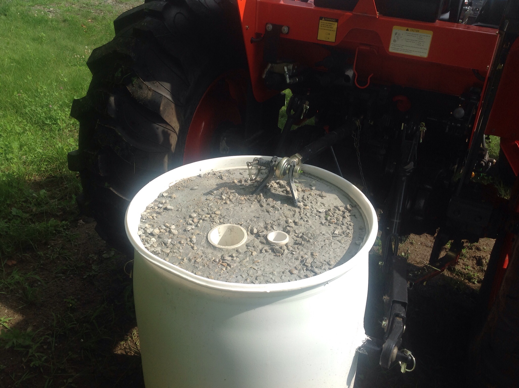

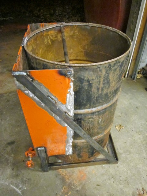

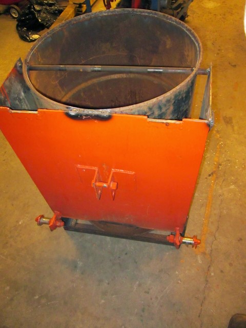

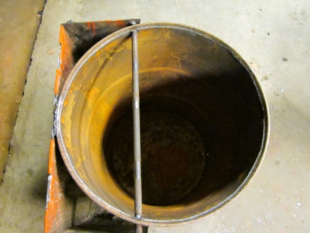

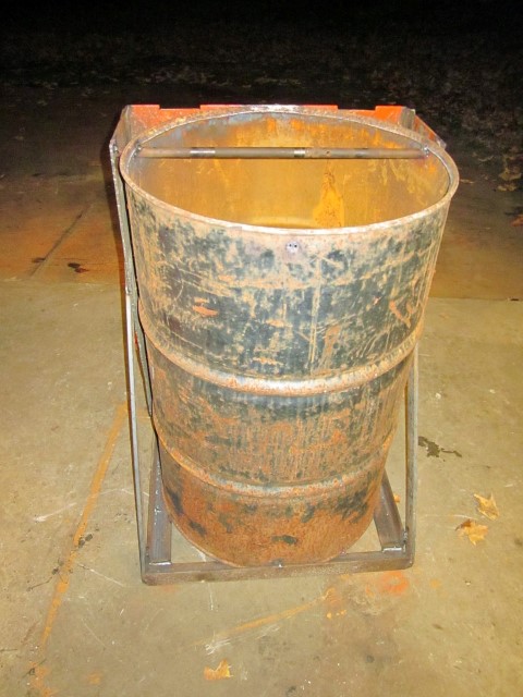

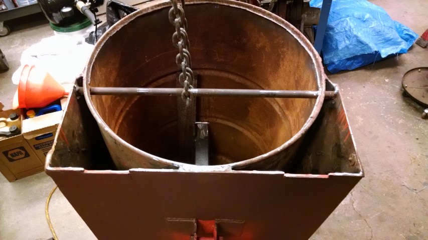

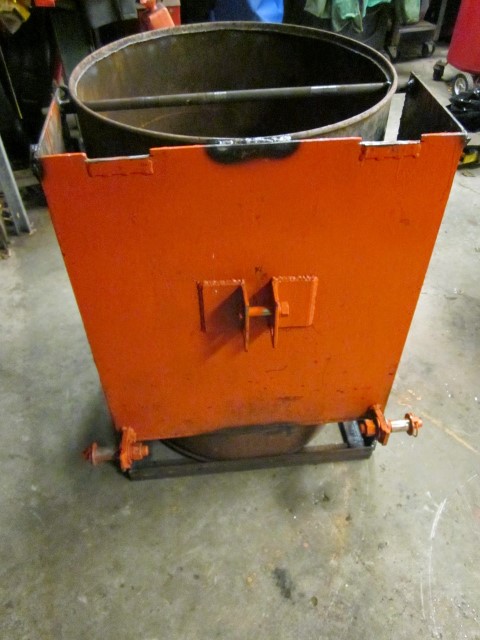

Converted a smaller rear ballast box that came with my old tractor (Kubota B7510) for use with my new one (L3800). I cut out the back of the box and make a support for the barrel. My plan is to fill it with steel and cement to get it to about 1000lbs. I think that's the recommended weight that I've seen from reading some of the posts.
I've looked through a bunch of old posts and will most likely put some tubing to hold tools and a rear hitch on it before I fill it. Any recommendations or suggestions before I start mixing the cement would be greatly appreciated.

I'm guessing that your 3pt will reach that low even when your tractor is sitting on top of a foot of snow or ice so there will not be any issues getting it hooked up in any conditions?
A Californian only thinks like that because he formerly lived north of the border. ;)
I'm always thinking multi purpose use so I would think a concrete filled barrel on its side in the form of a 3pt roller would have some additional utility.
Just thinking out loud, your too far along to want to redesign it probably.

Id throw in some rebar or scrap steel into the concrete to stiffen everything nice.

The 3 point on the tractor lowers to about 2 inches above the ground so I think (hope) that it should be enough.
   / Barrel Ballast
will do. I have some wire mesh from an old slab pour that I will put in before I fill it. thank you

If you can add a receiver to it you will find it handy.
L2800 w/FEL - 72" Land Pride rake
   / Barrel Ballast #9
Exactly, thank you. I have a quick hitch so the weight will be a little further back.
My hacked in top link was not high enough, adding some links to extend it 6 inches or so, so check your geometry, i guessed on mine
   / Barrel Ballast #10

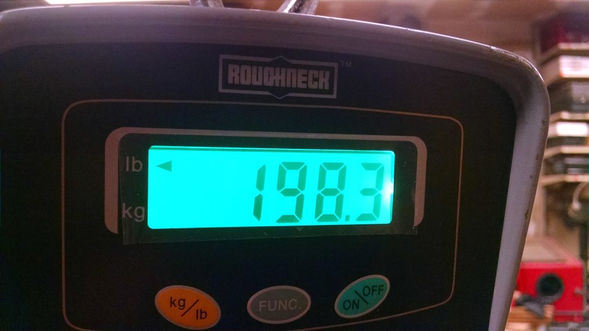

I put some rebar and 3pt mounts in a 55 gallon drum and filled it with concrete for my old IH2500b. It weighed nowhere near 1000#. I could tip it over on its side and then I could tip it back up on its end by myself and I don't consider myself a strong man. Concrete weighs a little over 100# per cubic foot. Steel weighs around 500# per cubic foot. So be sure to put enough steel in it to make it worth the effort to construct. ;)
