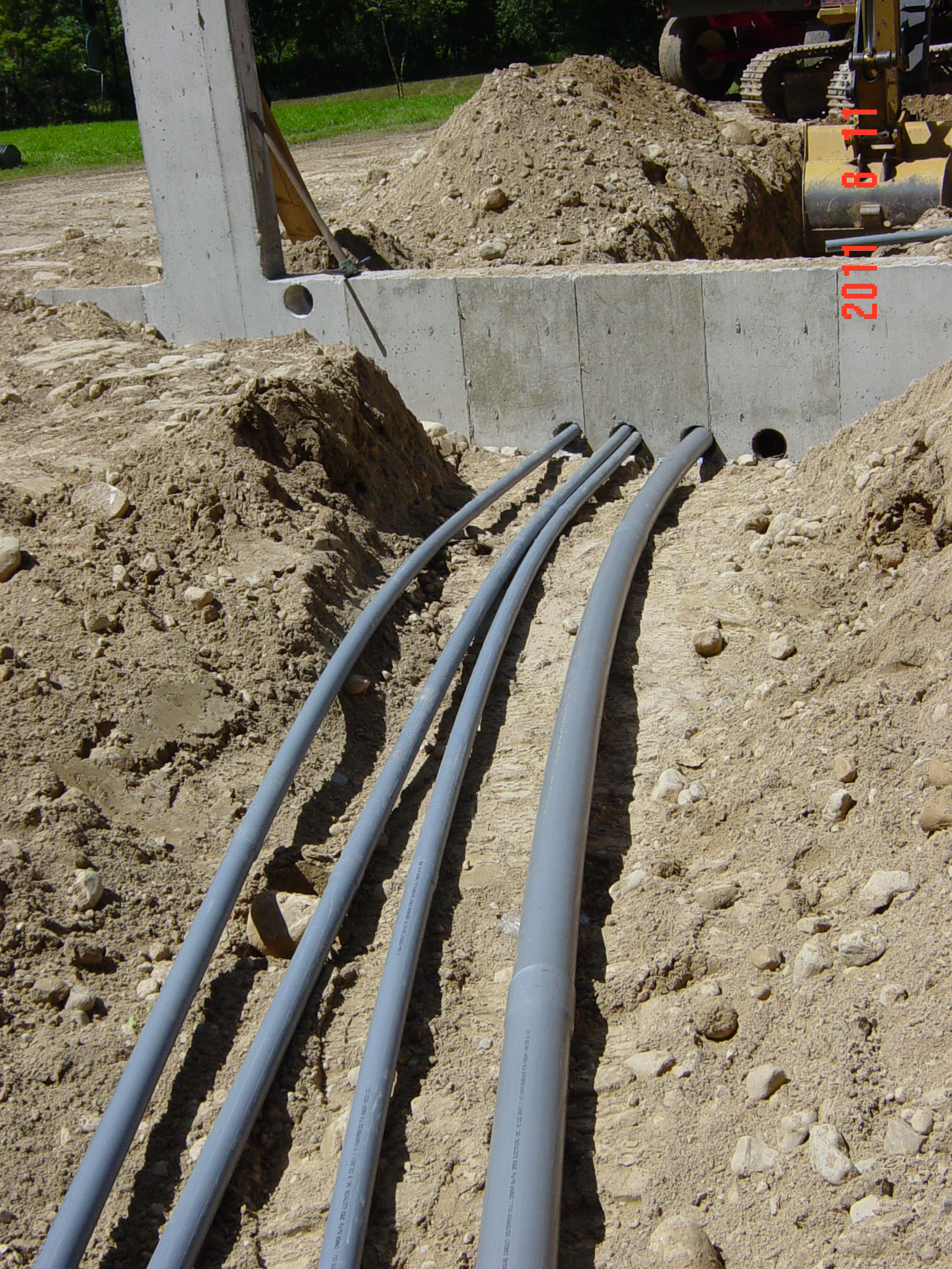

   / Barn: Stub-out planning before the slab goes in... #2
Power
3 phase 600volt
Com
Air
Heating (The biggest pipe)

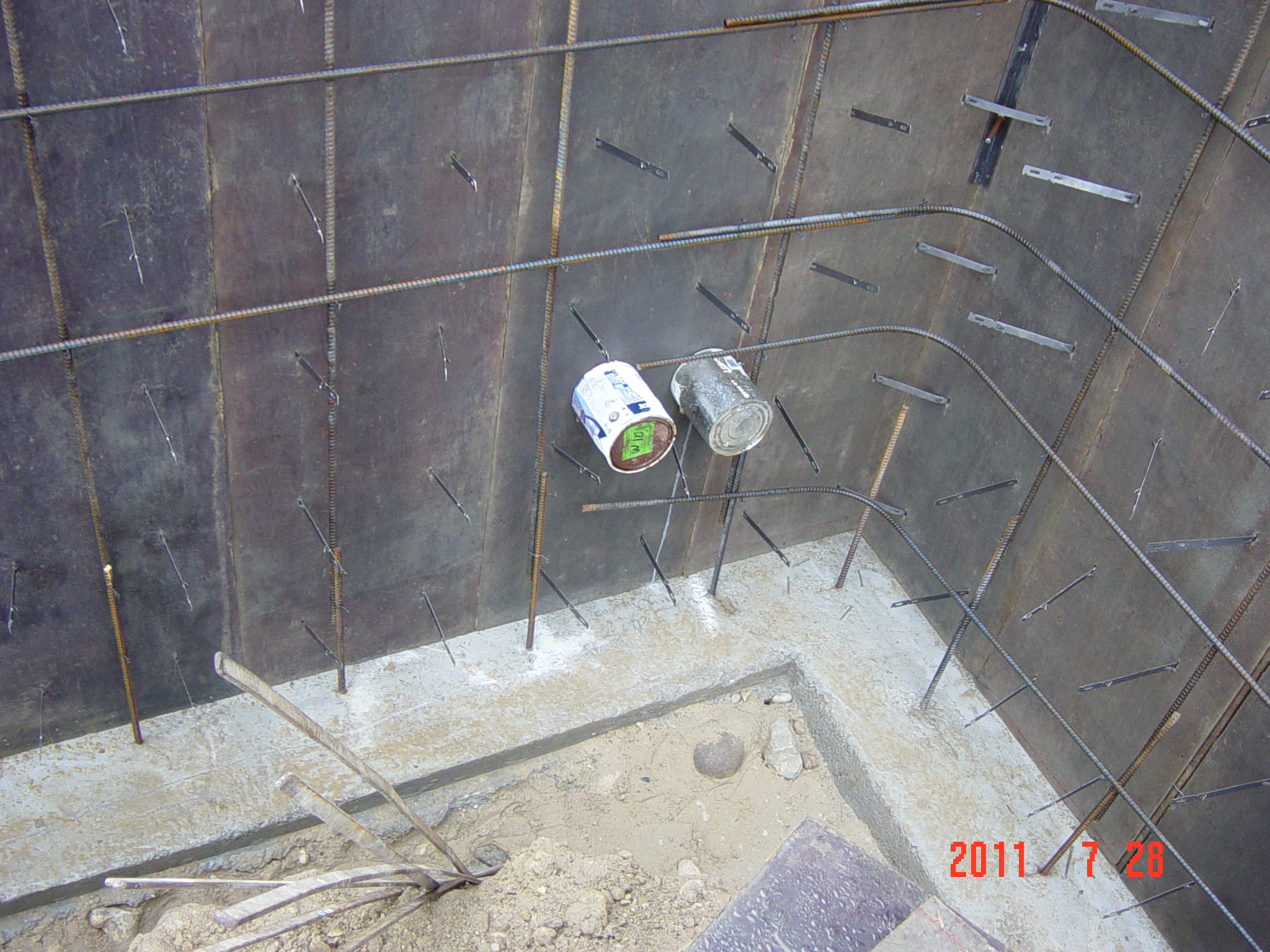

Old paint cans were used to make openings in the foundation wall below grade.
Oh, I forgot water, drains, and a floor drain.
Then some extra pipe for control cabling for the (possible wood boiler) heating system

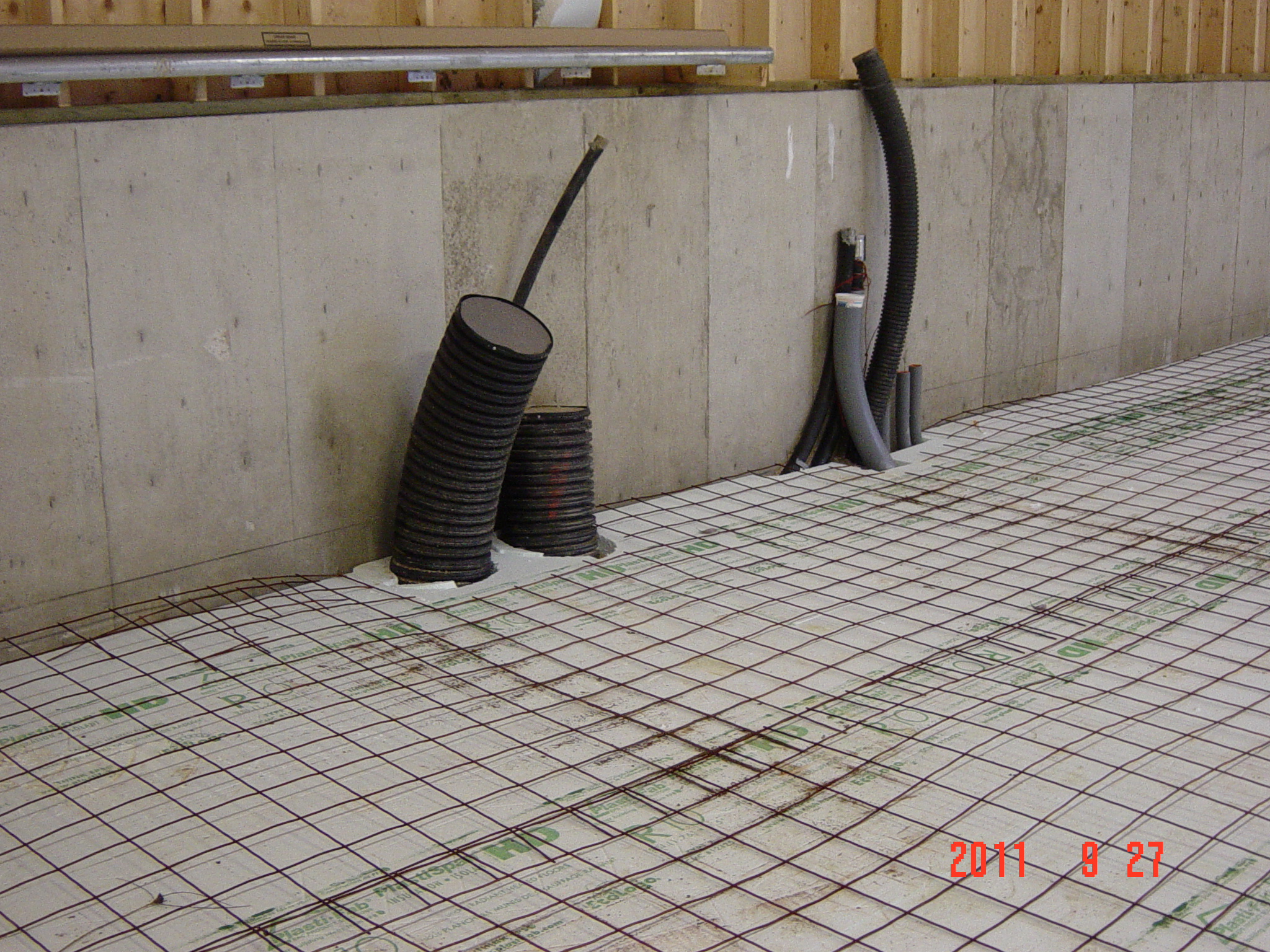

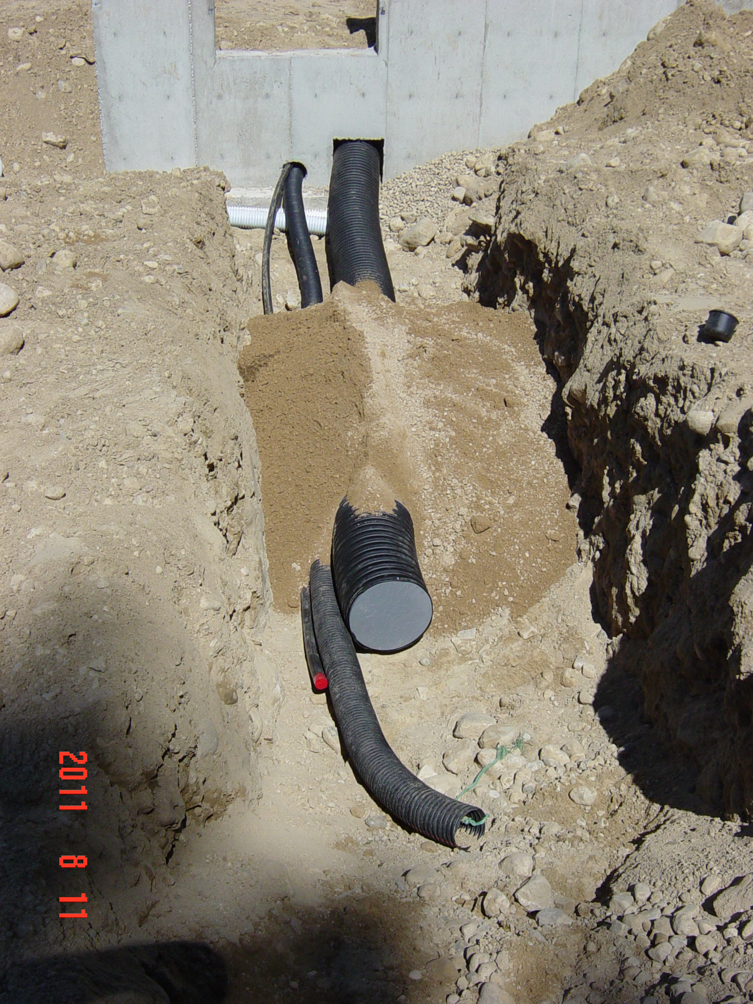

   / Barn: Stub-out planning before the slab goes in... #3
And, how some of the services looked before the floor was poured.
