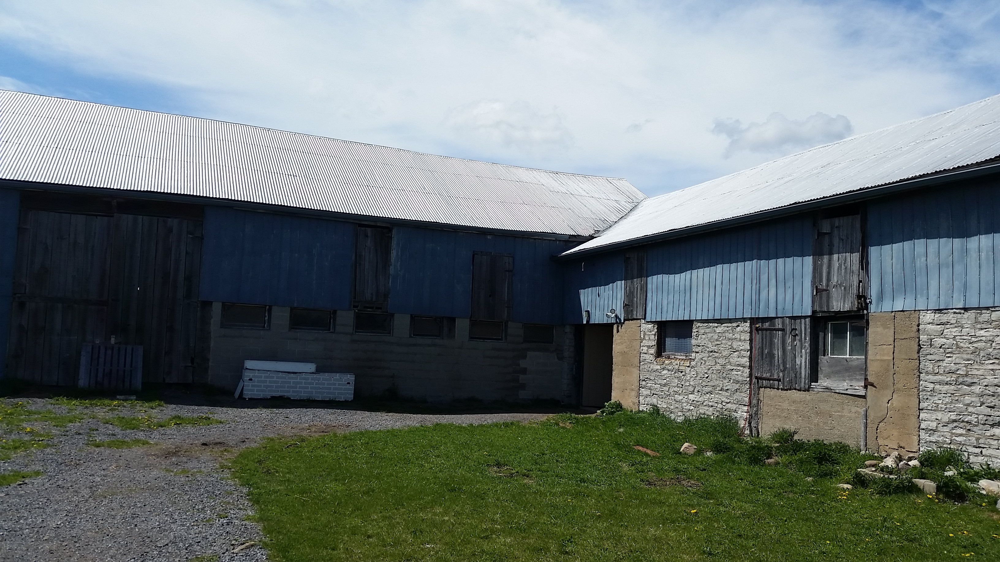

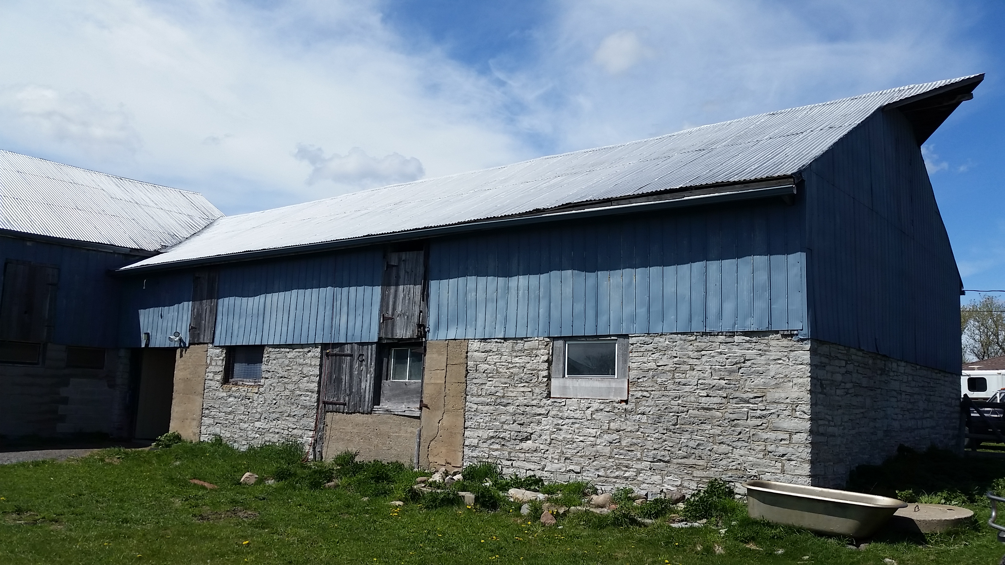

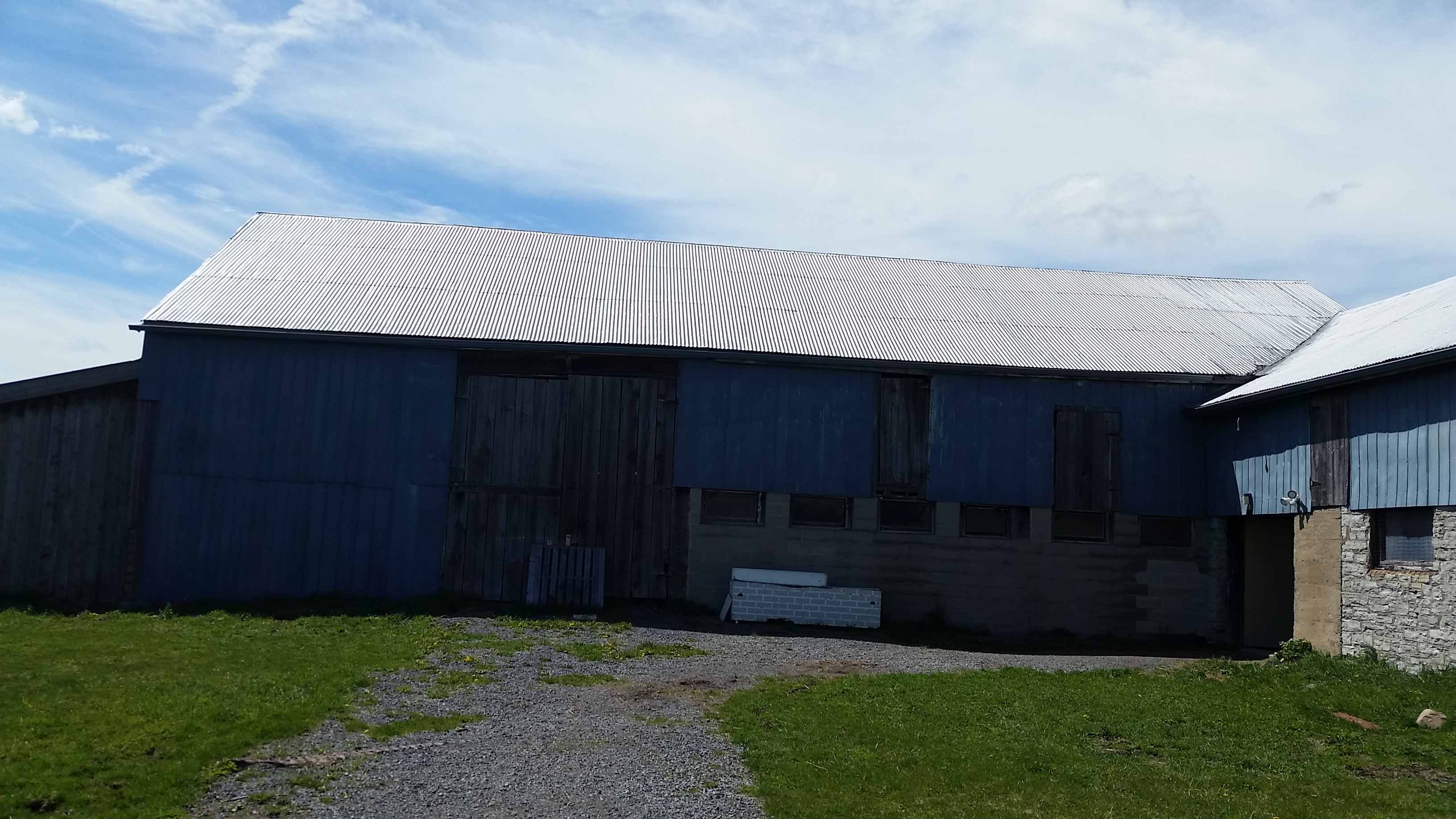

I have a 350-400 sq ft steel roof on an old barn that has numerous leaks. I suspect the leaks are coming from the washers around the nails have degraded.
Unfortunately it is very hard to identify where exactly the leaks are coming from, seems like its different every rain storm. Also I am not a huge fan of climbing up there.
My plan of attack is to go up on the roof with black jack ultra white (BLACK JACK White Ultra Roof 1 18.9 L White Roof Coating | Lowe's Canada) , some leak seal, some caulking, some new roofing screws and of course a safety harness
Some of the worst areas, I intend to cover all the screws with a dob of blackjack, replace any screws that are obviously messed up and caulk and leak seal as needed.
Any other tips from anyone out there??

Had a similar issue to you last fall. I just called my insurance carrier, contracted a roofer experienced in standing seam metal roofs, paid my $1000.00 deductible and had an entire new standing seal metal roof installed. Easy peasy and no effort on my part. I'd rather pay a grand and let a professional handle it. Not about to get up there and fall and get hurt or dead.
