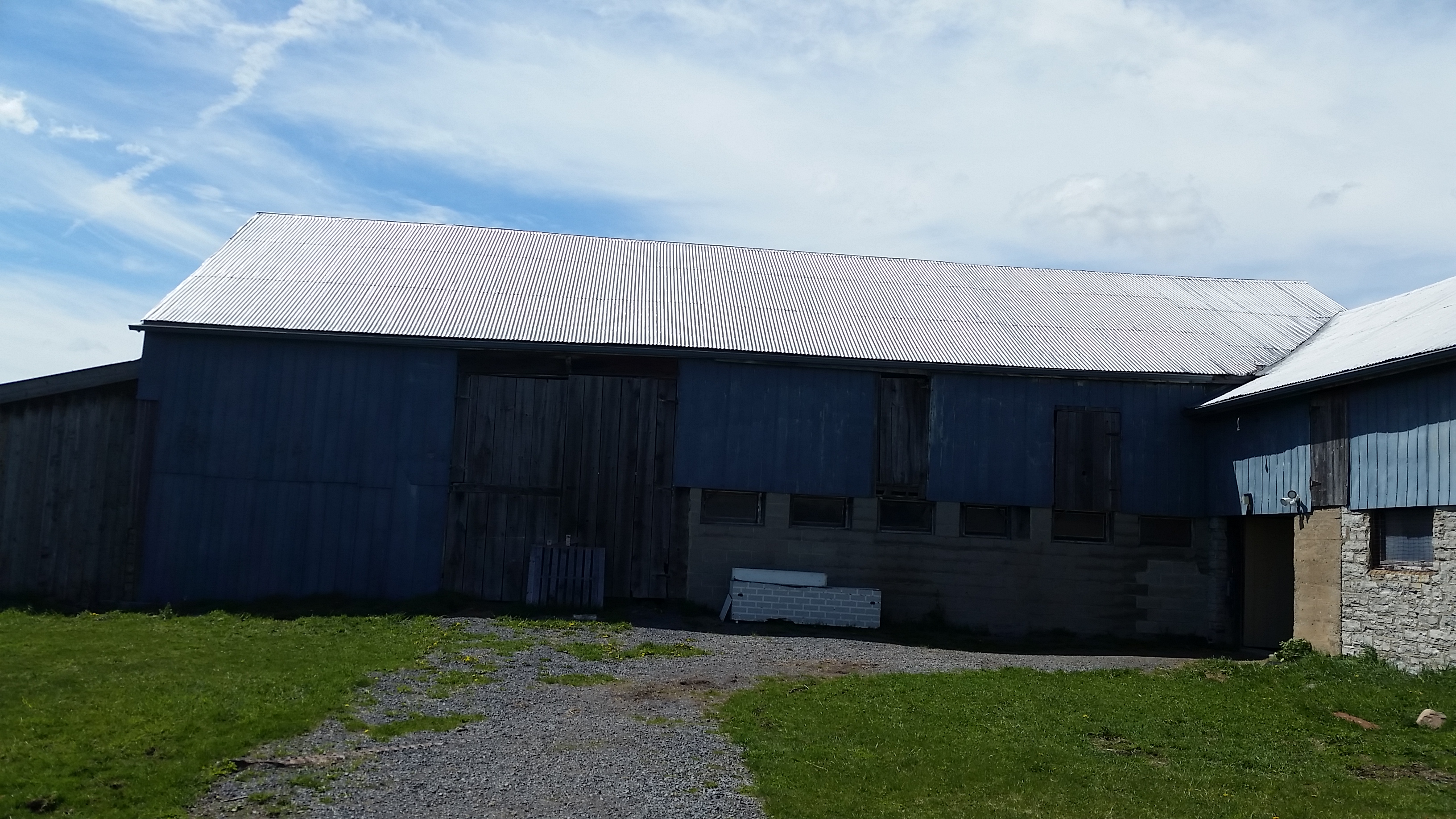

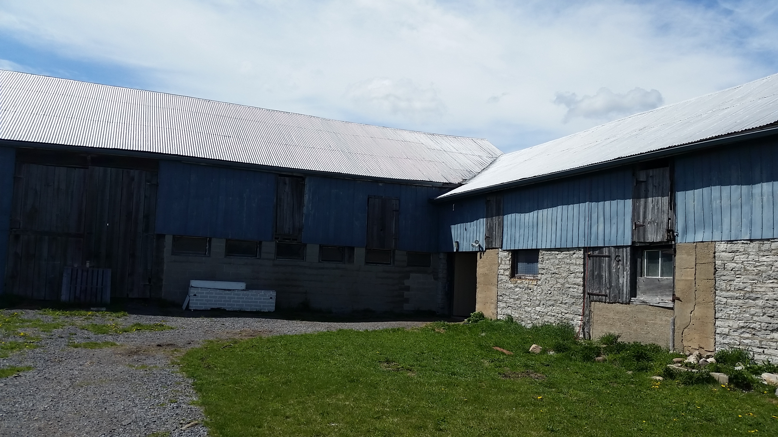

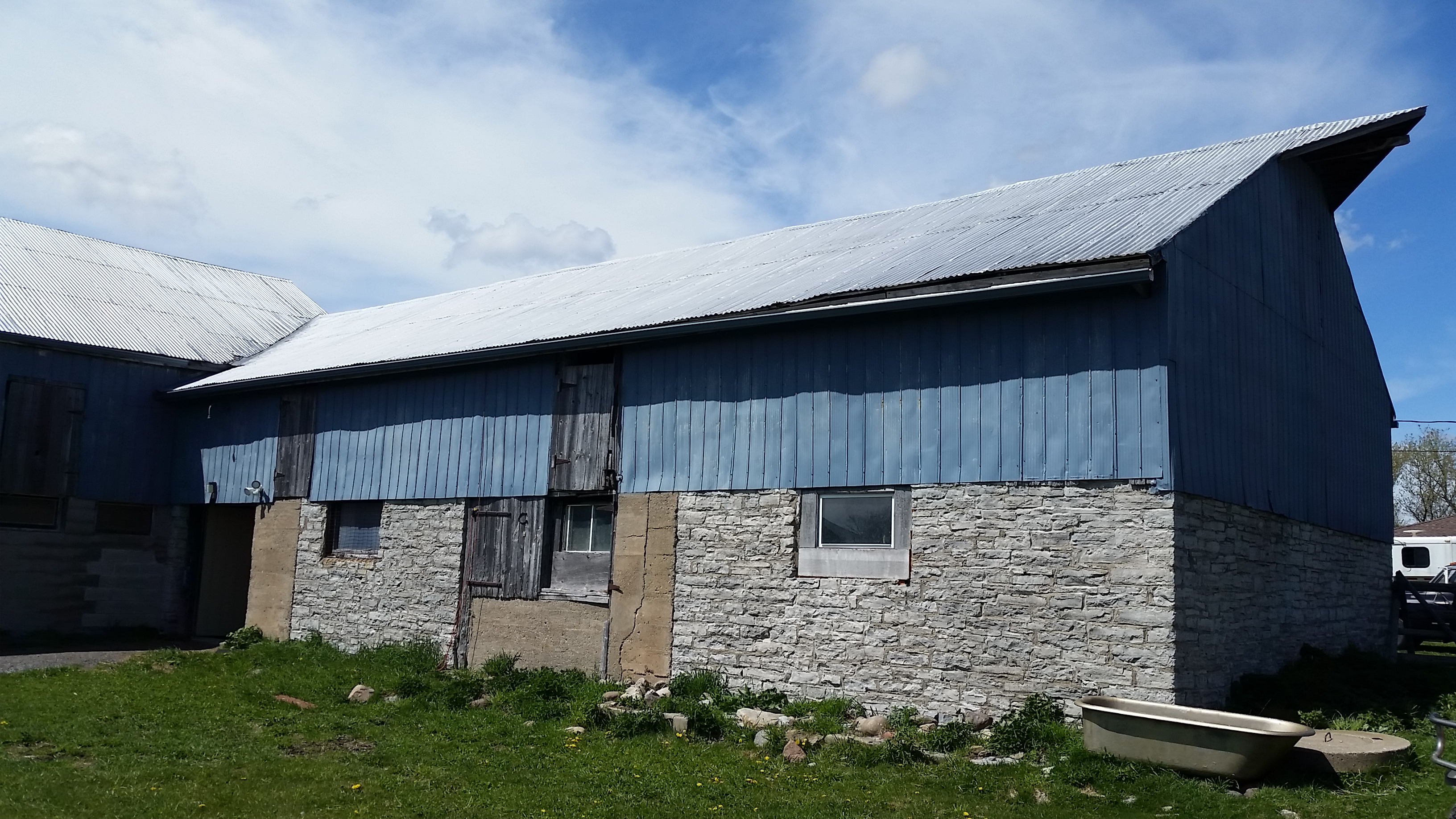

I have a 350-400 sq ft steel roof on an old barn that has numerous leaks. I suspect the leaks are coming from the washers around the nails have degraded.
Unfortunately it is very hard to identify where exactly the leaks are coming from, seems like its different every rain storm. Also I am not a huge fan of climbing up there.
My plan of attack is to go up on the roof with black jack ultra white (BLACK JACK White Ultra Roof 1 18.9 L White Roof Coating | Lowe's Canada) , some leak seal, some caulking, some new roofing screws and of course a safety harness
Some of the worst areas, I intend to cover all the screws with a dob of blackjack, replace any screws that are obviously messed up and caulk and leak seal as needed.
Any other tips from anyone out there??

The thing to do would probably be to replace the nails with screws. But that would talk along time. A metal roof really shouldn't need caulking, unless you have something on it or through it, and then, caulking is supposed to be secondary, but often is primary.

I think you are wasting your time with the roof coating. More then likely, the leaks are caused by the fasteners holding the roof in place. While it could be the gaskets, it is also very likely that over time, movement in the roof has loosened the nails and allowed the roof to move during a storm. If you do not stop this movement, nothing will seal it.
You need to remove the nails and install screws. This is a very slow, tedious task. It's not very expensive, but the learning curve to get the nails out and install the screws quickly is going to take some time.

I just replaced a metal roof that was nailed. The best technique was to use a pry bar and a claw hammer. Use the hammer to tap the pry bar under the nail. Then place the hammer head flat between the roof metal and the pry bar. This saved the roof from damage and provides a good angle to remove the nail.
Definitely replace with screws.
