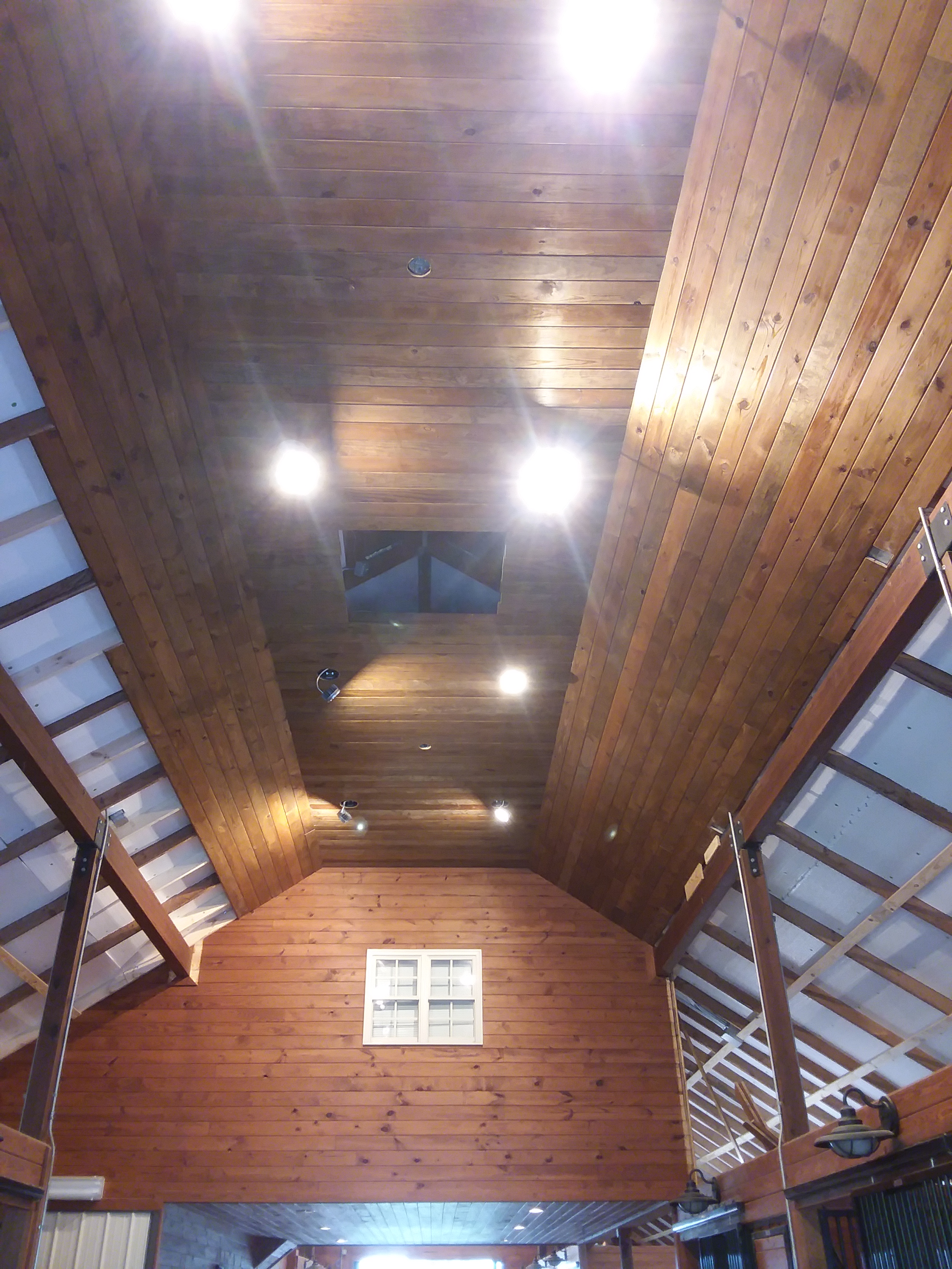

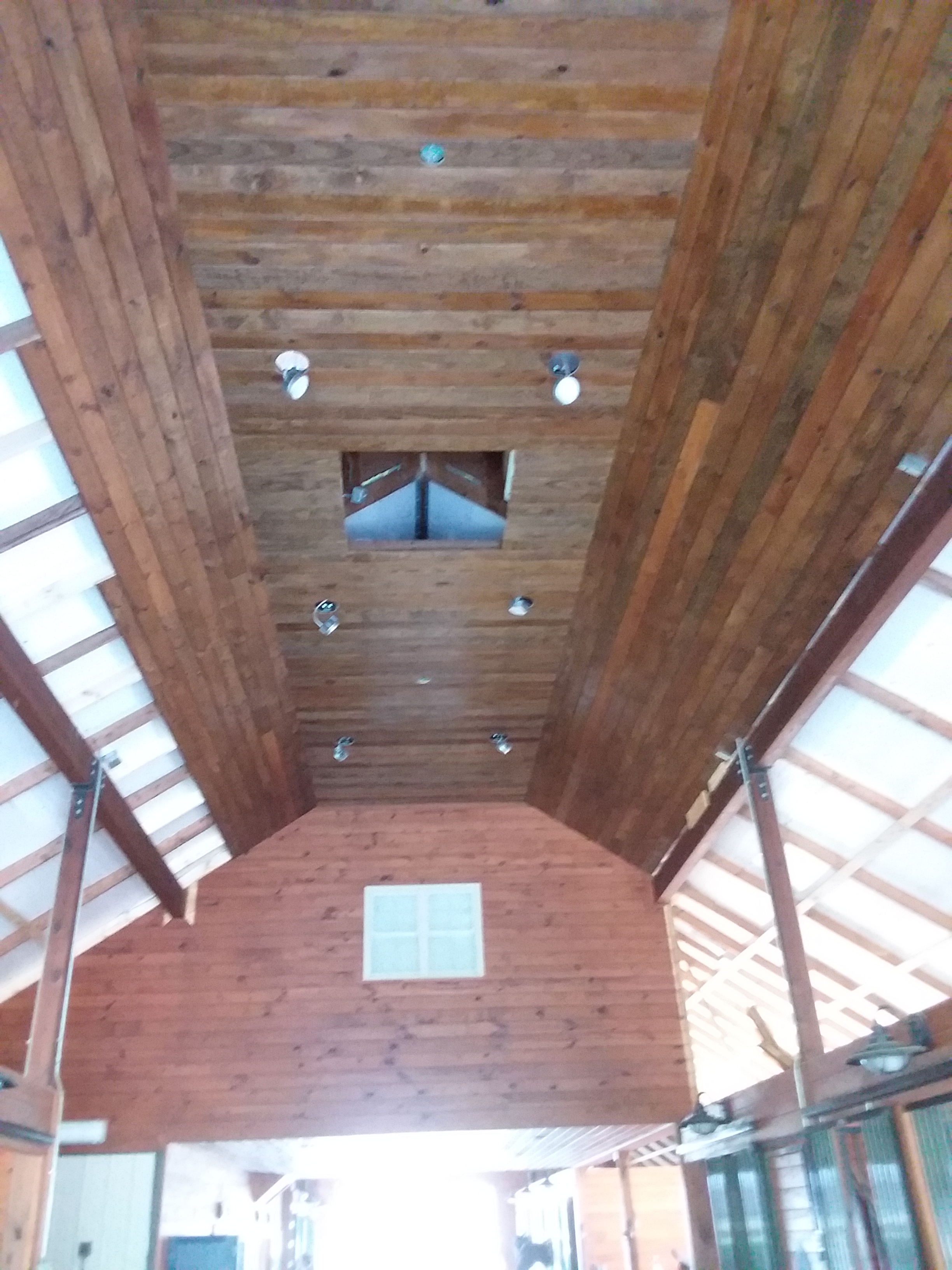

This has been a slow process. The heat hasn't helped. New LED can lights are awesome.
   / Barn roof insulation #66
That’s more like I would have expected to see inside originally the first time I viewed the outside pics. Nice job.
   / Barn roof insulation #67
Looks really nice. Are the boards bought already stained or are you doing that yourself before installing them?
What did you use to keep moisture off of the boards that forms under the metal roof panels?
#68
We put insulation under the roof below the purlins. I hope it works. Thats how the customer wanted to do it. I tried to talk them into removing the roof and putting down rolled fiberglass but the didn't want that. The barn laborer stained the pine.
