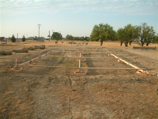

I'm working through plans to erect a barn and there is something I haven't been able to "get a handle" on. I'm thinking of setting PT 6x6 posts on concrete piers as footings. How can I set the concrete piers or forms in place and be sure that the PT posts will all sit in perfect position, such that they will all be plum and aligned? I know how to "square up" a footing and align the holes for the piers, but it seems nearly impossible that you could fill tubes with wet concrete, insert post brackets, and have everything so precisely aligned that all of the columns would be perfectly plum when finished. If I set concrete piers like this for a large barn (say 28 x 40? with metal receptacles for the wood posts embedded in the concrete, I cannot image achieving the kind of precision needed to avoid having to tap the columns into plum.
Am I missing something here?

Normally you would do it with batter boards and string. If you square up your strings, remove to drill your holes and then reset the strings to set the brackets you should be there.
There are differing opinions but...having the poles in the ground contributes greatly to the racking resistance and up lift resistance of a true pole barn. If you are planning on tin siding keep in mind it really offers little to make a building ridged where with a house the ply sheathing forms a ridged unit to resist movement. Poles on brackets are a hinge point for movement so be sure to include a lot of diagonal bracing.

Marks right, put a string on everything. They make 6x6 brackets that have a leg that goes into the wet concrete:
6x6 Elevated Post Base-EPB66 at The Home Depot
There are many variations and prices, so shop around. Once up each post will need to be braced to the ground at 3 points. Get the two end poles straight and level, put a string on them, then bring the others up in line with that string. Once all posts are up, check for square, them make adjustments if needed.

Ya I guess I can see how this would get pretty precise... running string across the center of all your tubes, maybe a black "tic mark" on the string marking the lateral position of each post, and planting the brackets under the mark.

You say that you know how to square up footings and such so put that good knowledge to use so take your time and pour the four corner piers first using batter boards with strings set at the hold down's top elevation or higher and offset as MarkV suggested. After they have set up, run your string from the four corner hold downs and finish the rest of them in between. That should give you peace of mind and make the job right from the start.

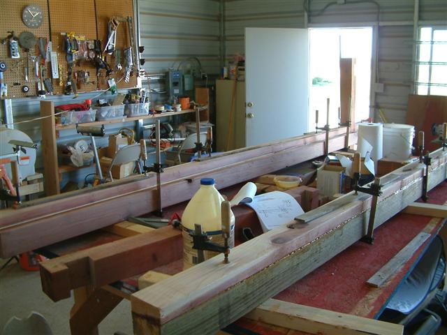

I am also "toying with" the idea of using laminated posts (i.e. using three or four 2x6s to sandwich together my posts. Any thoughts on that? It would make construction more managable for someone working alone.
