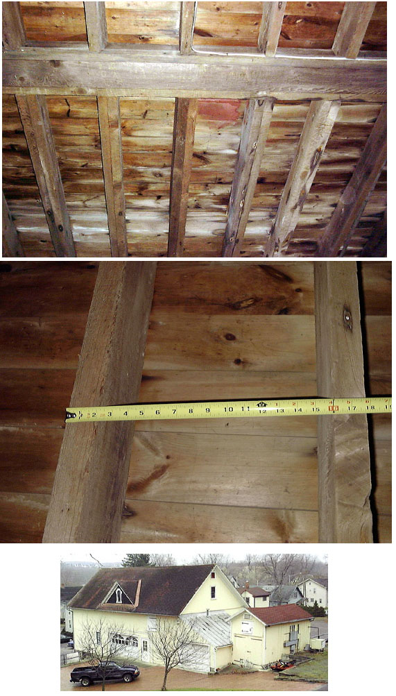

Here are some photos of my barn that was built in the mid 1800's. The floor is white pine 2"x6" TG and the joist are 2" x 8" on 16" centers. It has held up to all the horses and I have had my jeep in it as well. I think most older barns have wood floors and they seem to all be standing. With what little weight you are going to be putting on the floor, wood will be fine.
/ Barn Floor #23
And it looks like the 2x8's shown in the pic are notched out to sit on a 2x2 ledge (lintel) on the main beam, which means they are just 2x6's holding up the load. So, wood is still good. Just do the careful design needed, and work to keep the wood dry so it will not rot.
