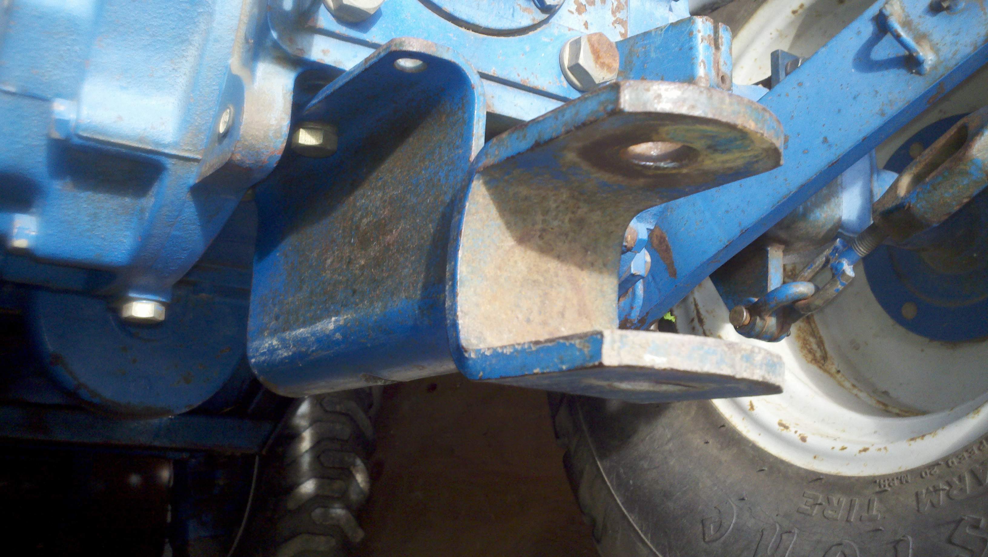

With my 1710 the drawbar is way to short so I bought a drawbar for the 3pt and hooked the mower up there. This works except that I do not have any down pressure on the 3 pt and since the mower is very tail heavy I have to chain the 3 pt down to the drawbar which is a big hassle. Any suggestions?
   / Barn Find - Sickle Bar Mower #47
a picture or 2 would be nice, but I don't have any easy suggestions. Short of some cutting, fab and re-welding the mounting frame.
   / Barn Find - Sickle Bar Mower #48
Why wouldn't you just attach it to the drawbar? Why use the 3-pt hitch?
Because the drawbar is way too short - by about 12". It is not a quick detach and a longer one would be in the way of other implements.

It does have a conditioner hitch that I am planning on taking off which will help but the only other option I can think of is adding weight as you suggested. The right tire on the mower is a long ways forward to have room for the break away feature but this puts the pivot point too far forward as well. Basically in front of the tires is just the drawbar and the PTO shaft. The whole drive mechanism, cutter bar, break away mechanism, gearbox, etc are behind the pivot point.
I never thought about this when I bought it. We did not have this problem with the JD37 and IH 1100 we had at home when i was growing up.

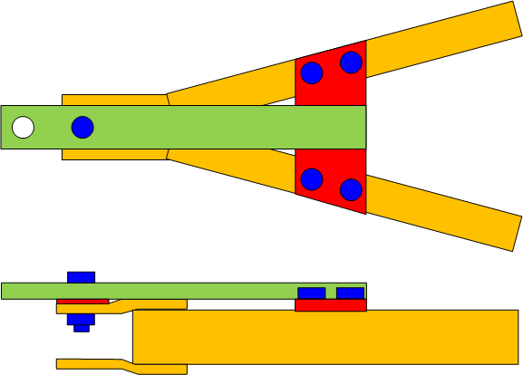

   / Barn Find - Sickle Bar Mower #55
I tried hooking it up to my Ford 1710 this evening and it is obvious the drawbar is too short. .
From the end of the (tractor) PTO shaft to the centre of the drawbar pin there is a correct distance that trailing PTO machines should be hitched at, the machine
manufacturer or dealership should be able to tell you this.
Often the tractor drawbar is close enough, if not a special hitch may have to be made for the tractor to obtain the correct distance.
Altering the length of the drawbar on the machine will not work.

The drawbar is way too short. I put a bar in the 3 pt and then locked the 3 pt down as it has no downforce and mower is tailheavy. This made it all work. It is kind of a pain to hook up but other than that it works fine.
