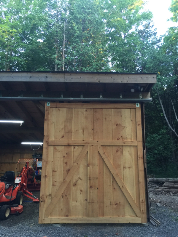

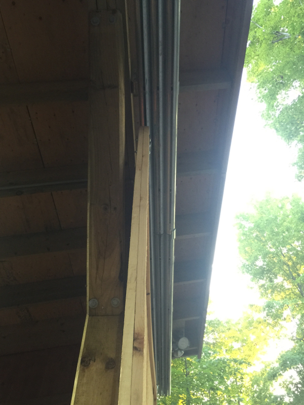

Your train of thought aligns nicely with what I am building now: a triple track for 3 overlapping doors, each 9.5 feet wide x 11 feet tall. I had a steel shop make up 3/8 thick steel brackets bent at 90 degrees, 24" centers that hold the three tracks. So far so good, though I still have the 2 other doors to build.
Wood is 1" x 12" rough cut pine with the "back" being simple vertical boards (with lap joints rabbetted into the wood so there is no gap or light shining through) and the decorative 1x 12 ripped to 6" glued and screwed (from behind) on the front.
Tracks are round and wheels are round and made out of some slippery plastic.
