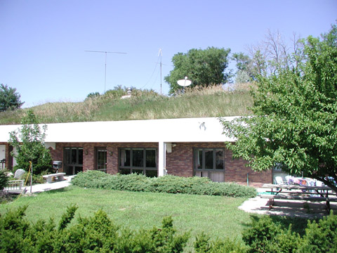

CS, here is an image of my earth home. The franchise it was built under is Terradome out of Missouri. Wally
Link www.terra-dome.com

WOW, man!!! Looks like it's time to clean your gutters, eh? They're full clear over the top of your house!!! /w3tcompact/icons/grin.gif

Isn't there supposed to be a goat staked out on the roof?/w3tcompact/icons/grin.gif
I checked out a couple of websites linked to the site Ozarker gave.... very interesting concept. I bet your heating and cooling bills are low. Is soil erosion (roof erosion?/w3tcompact/icons/smile.gif) ever a problem?

Well actually I'm glad there are no more gutters to mess with and it's not as steep as the image shows. On top there is a battle between crown vetch and brome grass with the brome winning slowly. The vegetation on the roof is part of the insulation scheme for built in shade and holding snow cover. For a year it's about 600 gallons of propane and I have had a $98 electric bill in the summer. The living space is 1568sf and a 28 ft square garage.
