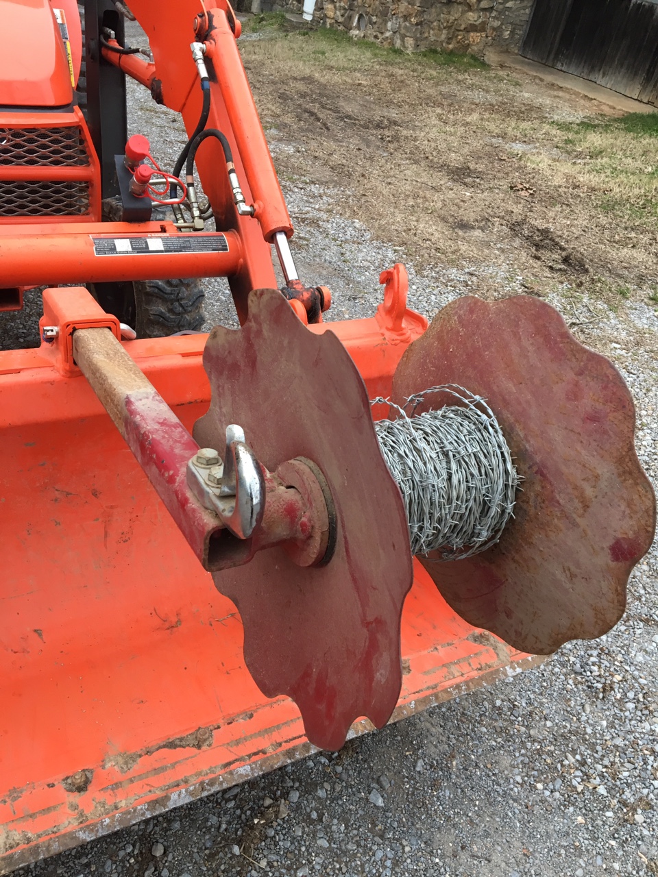

Barbwire hitch unroller.
   / Barbwire hitch unroller. #1
Smokeydog
Elite Member
Jan 20, 2019
3,210
Knoxville, Tennessee
Kubota B26, M59, M5030DT

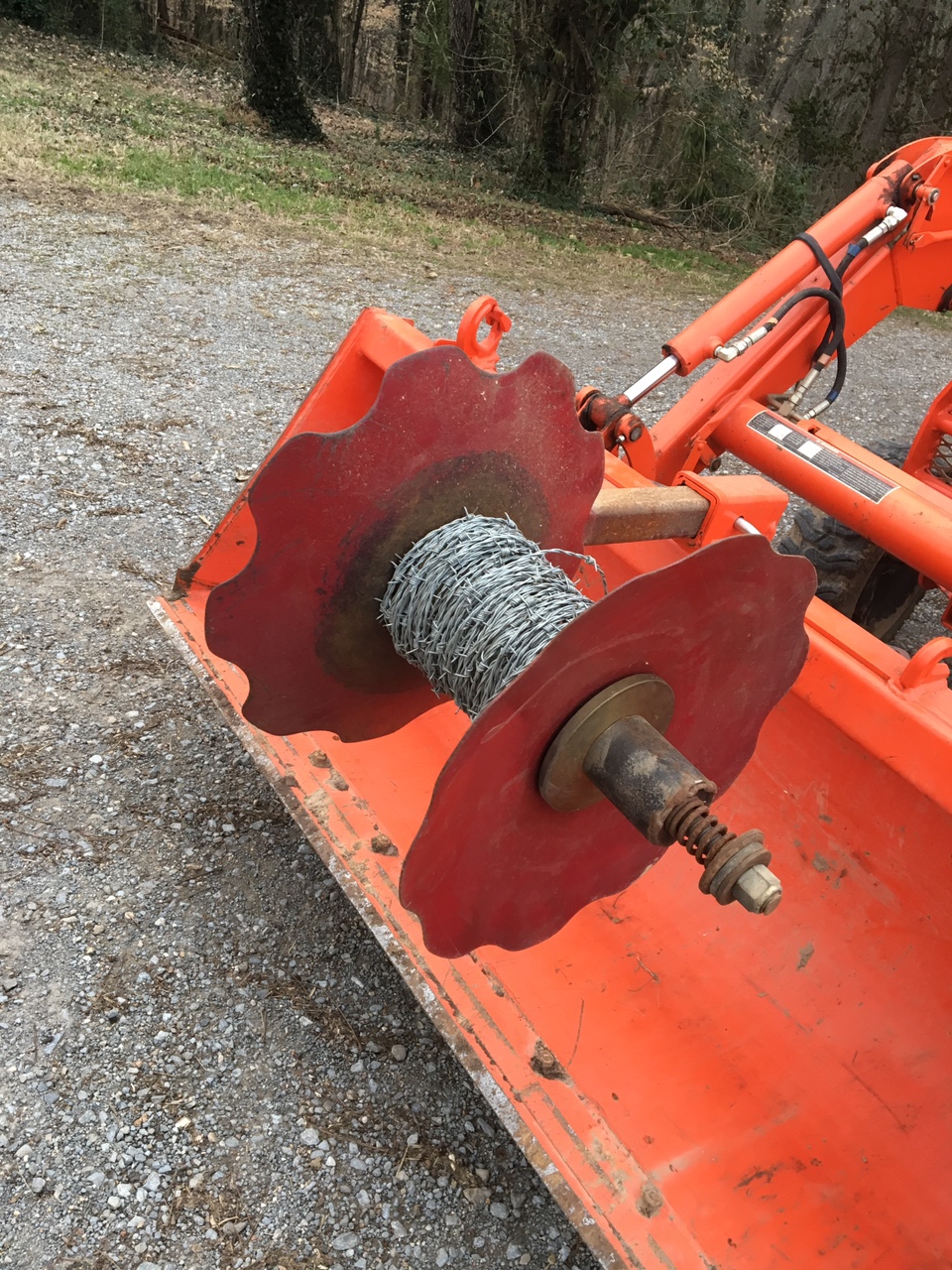

Disk blades help guide the wire off and keep the spool off the ground when using by hand in tight places. With a wire gripper tied to the hook often can stretch and position with tractor while securing to post. UHMW, brass washers, compression spring and nyloc nut give adjustable tension while unreeling. Helps keeping wire off the ground between stretcher posts.
   / Barbwire hitch unroller. #3
That is a good ideal !!
