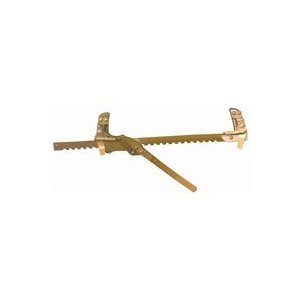

Like this stretcher used with a come a long, tie one end of come along off to H-brace end, pull strand tight, tie off and nail staples in.
Tuf-Tug Wire Clamp for Power Pull - 3832406 | Tractor Supply Company
For repairs I like
SpeeCo Fence Wire Stretcher - 3600312 | Tractor Supply Company
Both are work good, just preferrence.

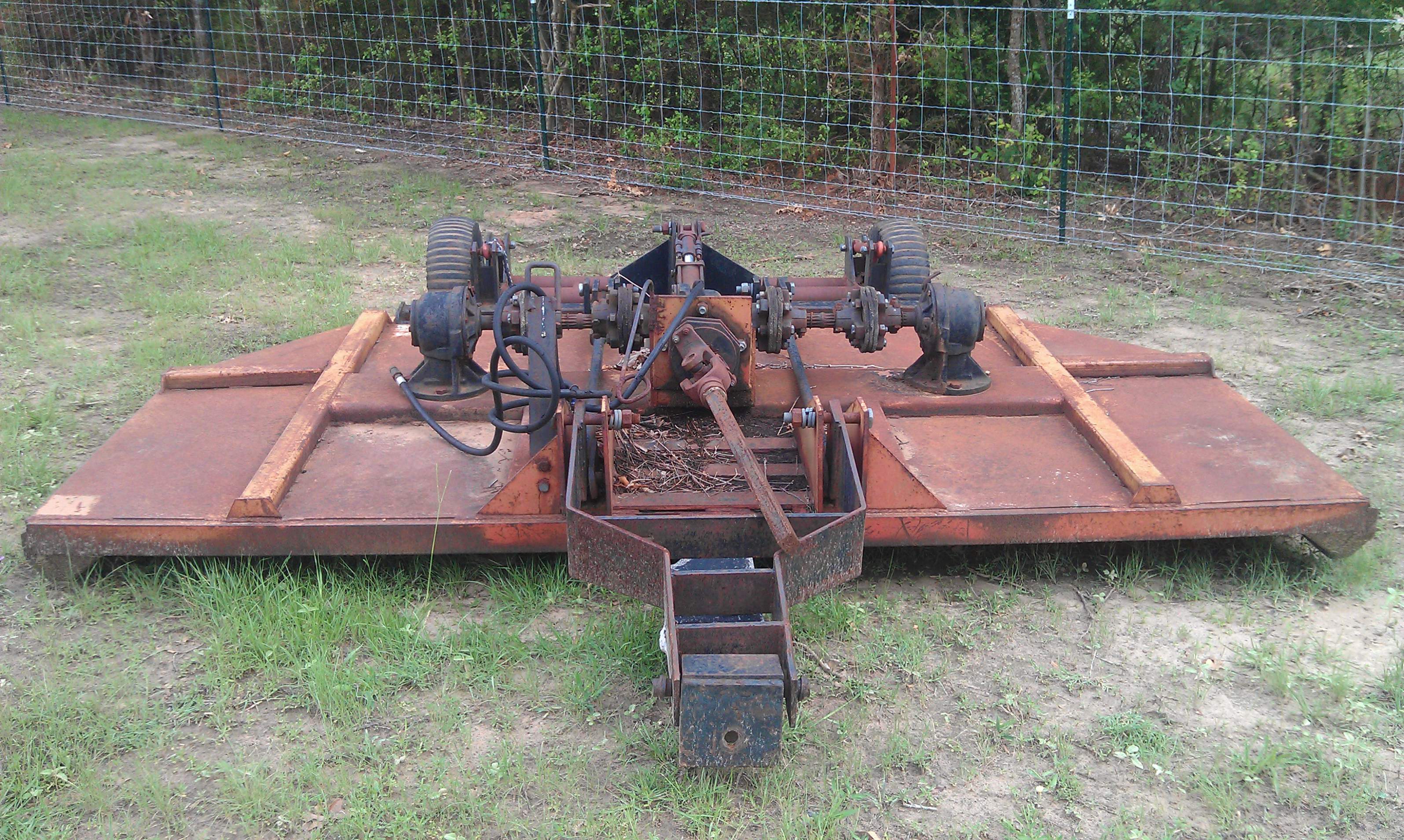

Have fun driving them t-post:laughing: I have 2,000ft to start in march,so dont feel like to loneranger:D shredder 3.jpg
If you click on photo you can see the fence I built around my place,picture was taking while i was working on it,so doesnt have center wirer yet or some clips.
