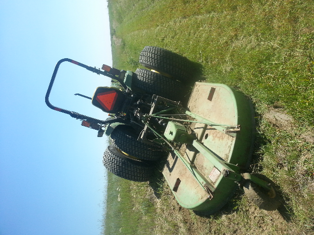

Would this idea work for you? Unfortunately I'm not skilled enough to rotate the image but I'm on about a 45 degree slope with no danger at all of tipping.
