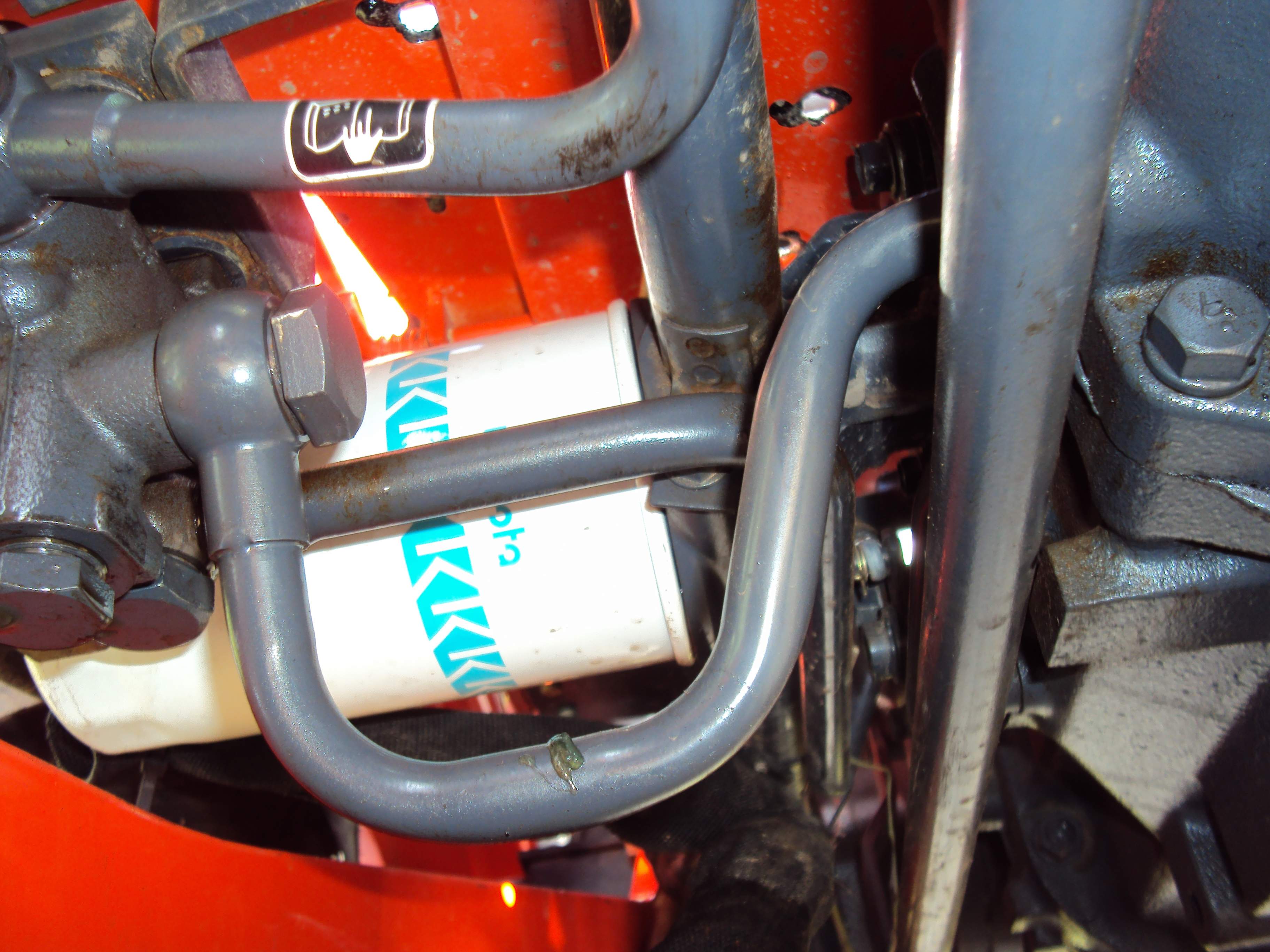

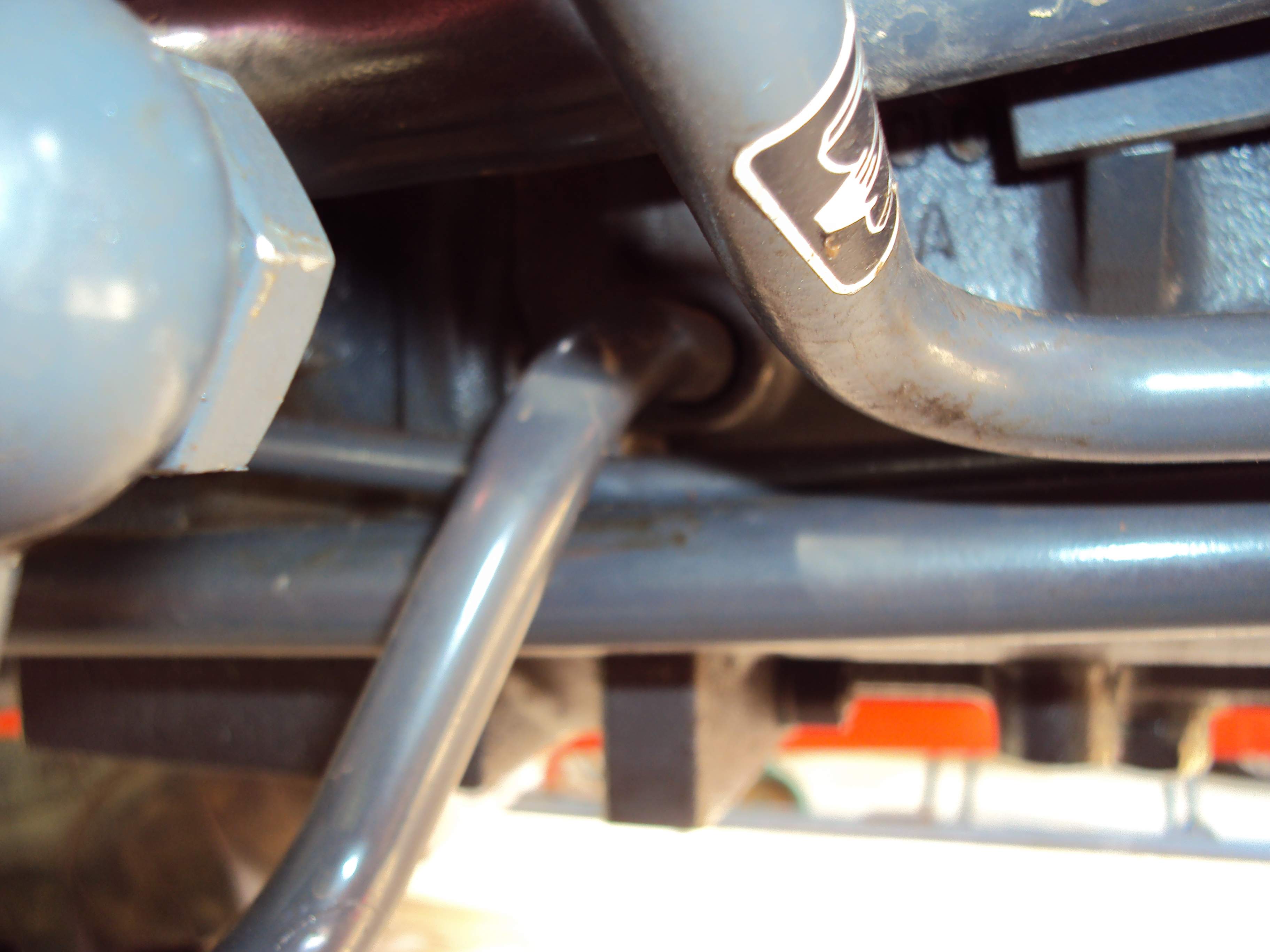

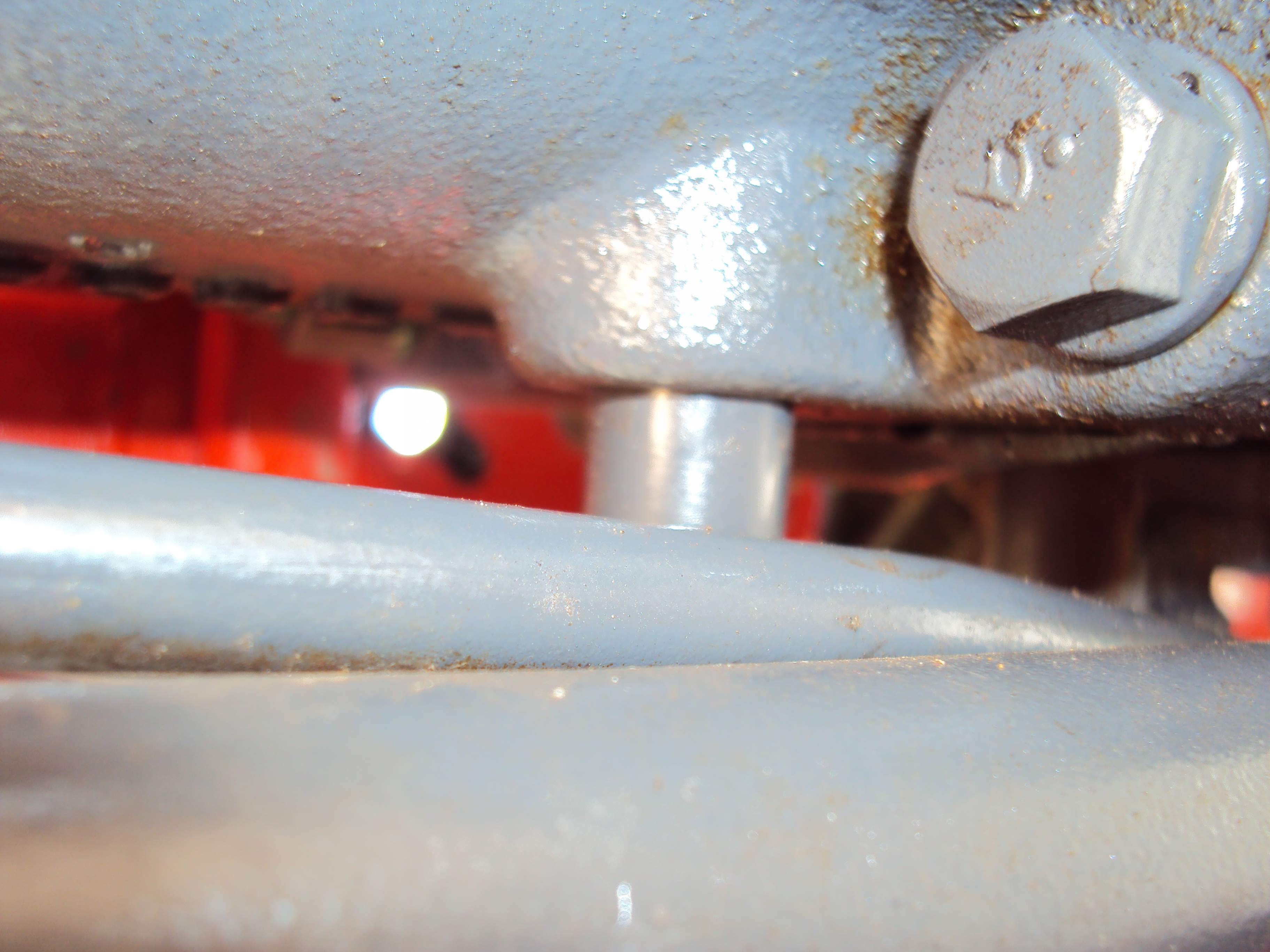

I have a Kubota L4400, with 52 hours on it. I am a few days over the one year warranty. There is a banjo fitting that comes out of the auxiliary block for the FEL, and goes right into the transmission case, and it is leaking. There is no visible mechanical connection to the tranny case, unless it is in the case. I was wondering if anyone has had a similar problem, or knows how big a deal this is to fix. I don't have any pics, because this happened in the field, and I had to leave it to get to work. I won't make it back up there till Saturday next. I called the dealer, he was very vague, about the cost. Since I am due for my 50 hour service, I will let him do the service, and fix the leak, but I don't want a "bill of goods." I got to tell you, this guy would not give me a price for the service. I kept asking for a "ball park price," and he kept saying "well its a 2 and a half hour job, and we will flush the system." I asked him to please give me an Idea of the price, and he would not. Am I crazy, or am I getting the world class run around? Any help you fellows give me will come in handy.

According to the mechanic at Marshalls this is a press in fitting. The end that goes into the trans case is just pressed into the case, it has a rubber o ring. the end that goes to the accessory block, has the standard bandjo fitting, with a crush washer

Can you post a pic? Can you get a parts breakdown? I used to deal with a guy there named Dave. He was in parts then went into service, real good guy. Maybe he can help. Something doesn't sound right.

I just got my tractor back from the dealer, and I could not be happier. The service Manager at Marshals (Bill,) Showed me the damaged part. The very end of this metal tube,with the o ring was egg shaped. Bill agreed that there was no visible damage to the tube from the outside, and wrote it up as a warranty repair, he figured it was Friday at the factory, in Japan, and they bent it putting it in. The punch line is that the tractor was technically out of warranty, but they fixed it anyway. Since I had to bring it in for this repair, I had them do the first service. I already had the transmission filter, and the oil filter, they replaced the fuel filter, inner, and outer air filters, engine oil, and transmission oil. they checked the front axel oil, and said it was good, greased it, and washed it, for $440.00 including tax. I also admit that I gave this man a very hard time, because of the way things went in the beginning, I still can't understand why he would not give me an estimate (give or take a hundred dollars.) However the price I got for the service, beat the other dealer by $200. I will post a picture of this tube later today, I could not get the old tube, because it is being sent to Kubota, But I think you guys should see this, because I still cant believe that this tube is just pressed in by hand.

Here are the pictures of the pipe that was leaking. this is the new one. it is the one in the foreground, that has a dab of grease on it. You can see in the next pic where it enters into the case through a cast hole. There is no mechanical connector in that hole. there is only a flange, with an O ring pressed in hand tight. As far as I can tell the only thing keeping it in place, is the force of the auxiliary block it is connected to with the banjo fitting end.
