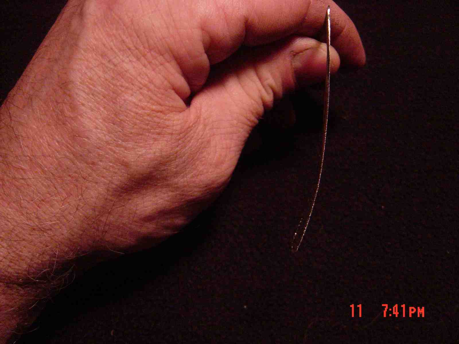

I've been very pleased with my Ellis saw.
