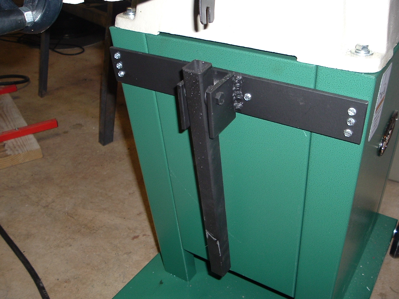

I recommend a horizontal/vertical saw. Mine is used most in the vertical position making non-precision cuts on hose, tubing, wood, rubber and whatever else that I can hold that needs cutoff.
Yes, that is one feature I really like about my Grizzley. I made a little table for it to use when it is vertical. I also added a folding handle to move it around better with.

Nice job on adding that handle! Looks like a great saw.

Thanks, I have enjoyed having it. Before I got the band saw, cutting consisted of either a hacksaw or my sawzall with a metal blade or the jigsaw with a metal blade. Not that those things are bad, just not the best for making accurate repeatable cuts. And you can cut angles in the steel, even bevels on the ends to facilitate welding. It is quiet and clean and if you put a magnet in a sealed plastic bag then place that in a larger sealed plastic bag you can attract most of the "chips" and make them easy to dispose of in the trash. Just open the outer bags seal and reach in and grab the magnet bag out and let the chips fall in the can.
