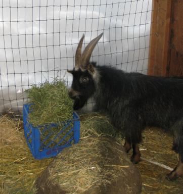

Have you done any band dehorning? We always dehorned when the animal is young. But! We recently acquired a buck. We had to rope him because he was never handled, didn't even have a name. He will eat from our hand now but we haven't petted or washed him yet. Wife wants him dehorned. I have seen pictures of band dehorning and read a bit. If you have done this yourself I'd like to get a few pointers. Sure wish I could give him a sedative,it would be easier to clip the hair round the horn and roll on the band if he were at rest.

Can you band horns that size? Never used banding on horns but have for castrating calves. Seemed to work well also.

I have seen pictures. The bands are "castrating band". In about one month the horn sluffs off. I have never done it or seen it in person. I would like to be in contact with a first hander when I do it.

Roy it does sound like it would work better on the bottom side vs. the top side does it not.

I,ve seen pictures of horn being sawed off then carterized. I don't want to do that or have it done that way. The sinus will be open on goats too. I don't look forward to it but it seems the only avenue open. I'll have to order a band spreader and bands. Maybe I'll do that now, we are in the middle of a snow storm at this moment, so I'm inside feeding the wood stove.

I ordered the expanding tool and the bands as well as the spray. I'm not looking forward to it. Been talking to wifey as to how we will do it, that is how to secure him while working on the horns. I don't think that rack will fit through our stanchion, maybe that would be best to use if he will fit.
