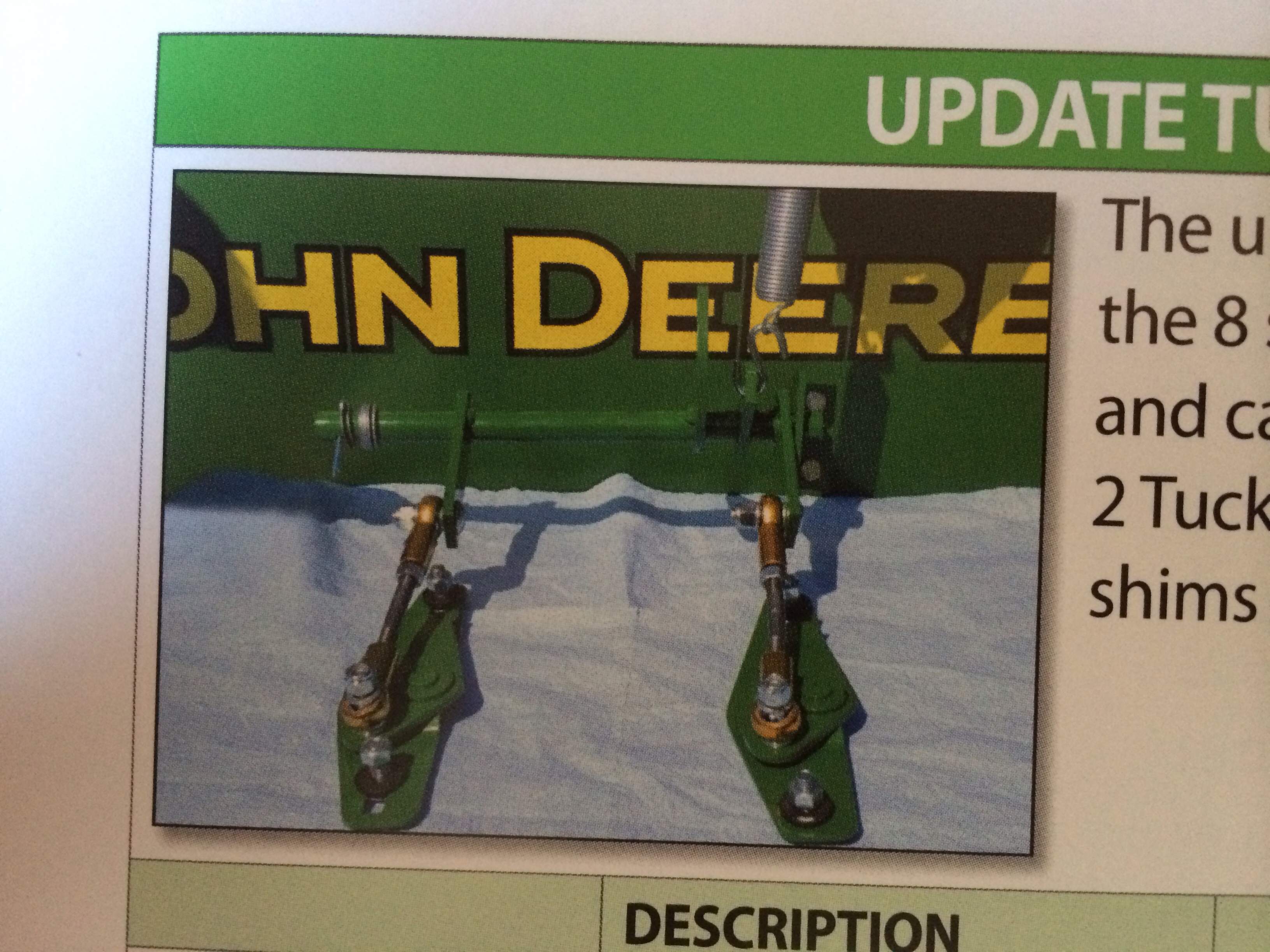

image.jpgimage.jpgI'm going to buy these at the end of the season my neighbor bought them he said they have worked flawlessly. They are $248 from finger lakes equipment they are a great source for new and rebuilt baler parts. In ny 585-526-6705 they are very knowledgable and friendly and know JD balers inside out. I can't figure out how to post the pics sorry. The picture is of an update tucker shaft&finger kit. They have ball joints like the 8 series baler so there will be a lot less play
