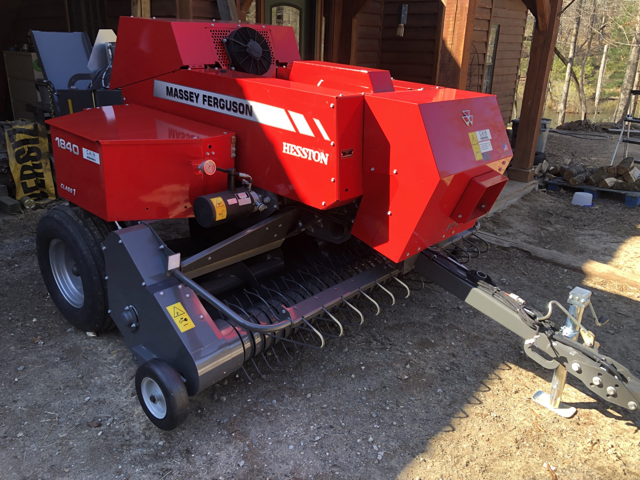

At my age chasing women would be similar to a dog chasing a car or pickup. I wouldn't know what to do if I caught a woman:eek:!
Who stated I was making any profit($$$$)?? I just do it out of habit. This yr in the "Texas near desert" it's difficult to make any profit in agriculture
