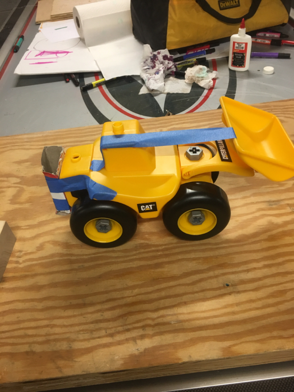

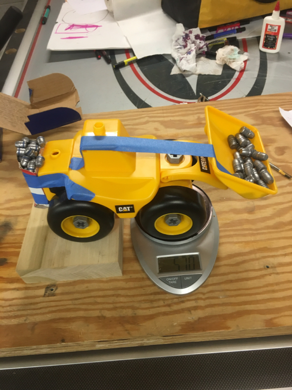

Here's a quick experiment using a toy loader with a cardboard box strapped on the back to represent a ballast box on the back. I attempted to use a rubber band to represent hydraulic strength but that didn't work and I had to just measure tipping load. The weight of my toy loader was 500 grams. The fairly proportional ballast weight was 158 grams. I zeroed the scale with the front axel on it and added weight until the loader tipped. The front axel weight was 417 grams when it tipped with no ballast. I added the 158 grams of ballast and this time the front axel weighed 850 grams when it tipped. Then I added more ballast in an attempt to reduce the front axle weight to where we started. I was unable to do that before my ballast box filled up, but at that point the ballast already weighed a completely un proportional 750 grains. I was only able to reduce the previous axel weight to 570 grams with the extreme amount of ballast. image-275787588.jpg image-1477990059.jpg

I have said it in many many other threads that ballast BEHIND the rear axle INCREASES the load on the front axle....but only up to the point that the rears remain planted terra-firma.
From THAT point forward......any additional amount added BEHIND the axle is INDEED reducing front axle load.
How much so depends on just what the ballast is (how far back) and what the wheelbase of the tractor is.
If the wheel base is 6'....and your load behind the rear axle is 2' back......thats 3:1.....meaning ever additional 3# of counterweight reduces front load by only 1#.
Longer is better for the "counter weight" effect....but sometimes not the best because alot pf people choose a counterweight because of short compact package to maneuver in tight areas.
Thats why any time these "how much ballast do I need " threads come up...I cringe at some of the low numbers people are suggesting. Because its clear they have no regard for lightening front axle load and only worry about stability. The numbers I suggest are often double what others suggest.
I'll use my old L3400 for example.
Bare tractor + loader is ~3800#. FEL is capable of ~2000# ground level. But absent any ballast.....could only muster 700# ground level before rears would hike up in the air. So that 700# lift + 3800# tractor and loader was putting 4500# on the front axle.
Loaded the rears and added 400#.....so bare tractor now weights 4200# with loader. That increased my lift capacity up front to 1200# before rears lifted. I now have 5400# on the front axle. A 900# increase vs no ballast at all.......just by simply filling the rears (which is so highly recommended on here for loader work)
I hang a 700# rear blade off the back centered 5' behind the rear axle. Now I weigh 4900# and can fully max out my front loader lift of #2000....but just barley. FOr all intents and purposes.....ALL the weight is on the front.....4900+2000 = 6900# on my fronts.
Now as i said....from this point forward....more weight or weight further back reduces that load.
I hang my 1100# bushhog......with COG a good foot or two further back than the 700# blade. My total machine weight is now 5300#....can can still max out my 2000# lift. But an additional #400 more than the blade......and hanging further back......rather than having 0 weight on the rear tires.....I can maintain 1000# on the rears. So 5300# machine + 2000# load - 1000# kept on the rears......front load is 6300#. Which is LESS than with the inadequate amount of weight that the blade provided.
So yea....its not just about having ballast for stability. Its about having ENOUGH ballast to be effective.
Many thread about guys with similar sized L3400's and people saying 600-700# is enough.....NO ITS NOT.
And many threads of people with similar machines to my MX5100, saying 900-1000# (in the form of a close compact box) is enough. NO ITS NOT. I have a 1620# woods DS96 that has a COG a good 4' behind the lift eyes of the 3PH. It keeps me planted but more would sure be better for the front axle.
