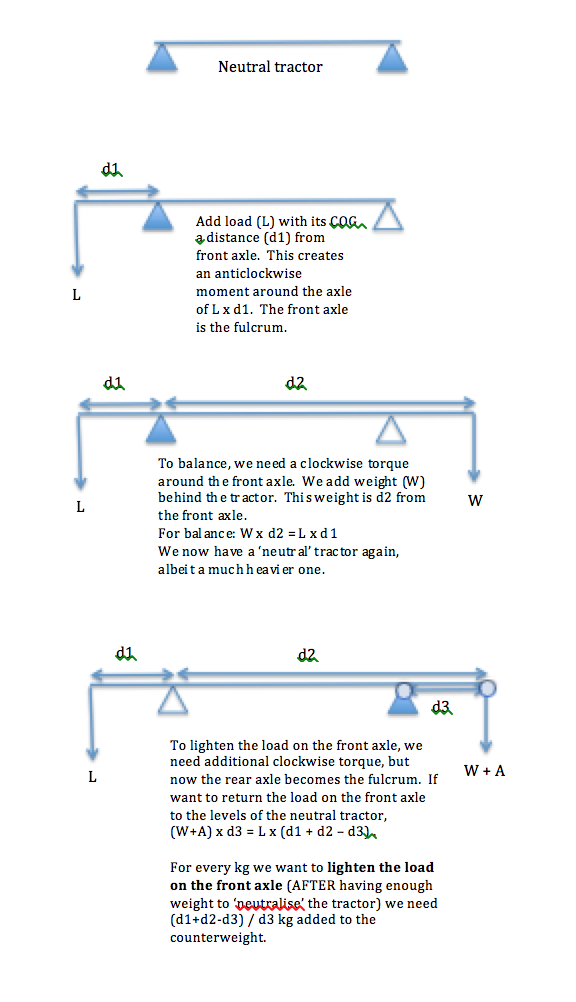

   / Ballast weight - how high can I go? #84
I have thought long and hard about this and think I may have worked out what is going on with calculating the mass and position of the ballast. Both mass and distance are critical. We are effectively dealing with torquing forces.
As far as I can work out, the weight of the tractor is irrelevant. All you need is for the tractor to be large enough to handle the total of the weight on the front end and the weight of the counterweight. The only specs of the tractor we need are the distance from the COG of the load from the front axle, the wheel base and the distance from the rear axle to the COG of the counterweight.
I created a Word document illustrating my thinking. Unfortunately, I can't find a way to upload a PDF to TBN, so I have had to resort to a screengrab, which obviously is not as clear as a PDF would be.
All comments welcomed.
Ken
