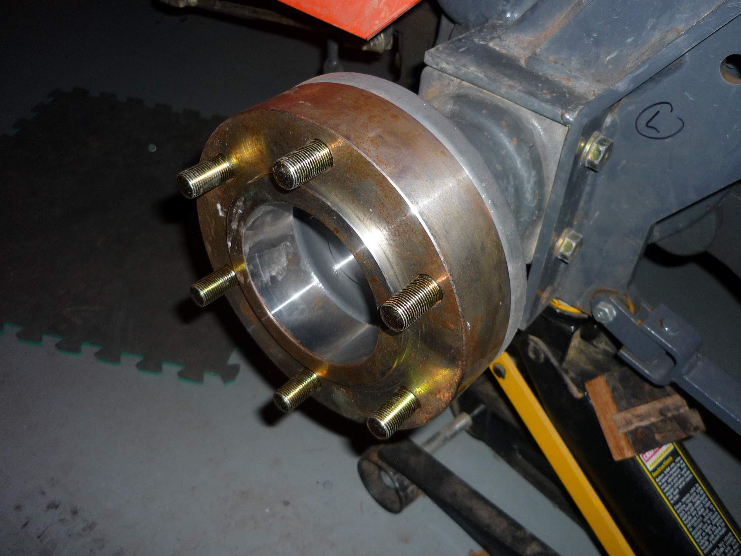

I think the OP should consider getting some wheel spacers-a wider track is about the only way to improve side to side stability.

I agree with Will_C. A wider stance on the rear axle is a definite need for slopes.

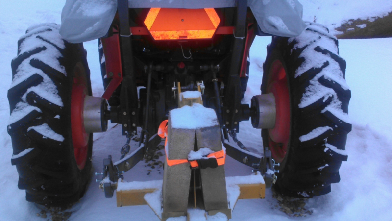

Properly sized and shaped ballast will make an enormous difference also to sideway stability. An L-shaped concrete weight has it's main weight lower than the rear axle and inside the rear wheels. Please draw that force diagram and you will see that it will take a heck of a slope to get that cog outside of the rear wheels.
Filled tyres is NOT enough ballast for serious loader work in modern CUT/SCUTs where loader capacity has been increased a lot in comparison to machine weight.

I wouldn't lift much of anything without some ballast on the back. Mains reasons are weight distribution and breaking. If possible, I would add wheel spacers and a ballast box with the weight down low, both will help a bunch. Just make sure the spacers are compatible with your mower deck. Check clearance to the rear anti scalp wheel in particular. Might not be able to space out the front wheels because of the drive over deck.

As far as the 54 inch mower on my B2601 is concerned, the wheels on the mower are just ahead and further out of the back wheels, so looks like anyway, that 2 inch spacers would put the rear tractor wheel/tire edges around a inch or so behind the mower tires. Hopefully that's not to close. I am contacting Bo-Tec now on spacer price and thinking about buying the $335.+ $30. shipping ones on e-bay, but hoping to find some cheaper ones that come with studs. What kind of spacers is that in the picture you posted?

Thanks for the Cut/Scut definition. I would have got the BX too if I was going to mostly mow hillsides. In fact, I would have got one anyway had the B2601 not come along. So far, hillside mowing is working out and expect to get better when my rear wheel spacers show up.

They are Bo-Tec 4" spacers. 200 hours on them and no issues. I contract mow right of ways with a lot of slope work. They are well worth the money. Make sure you torque the bolts to specs and put red lock-tight on them.
