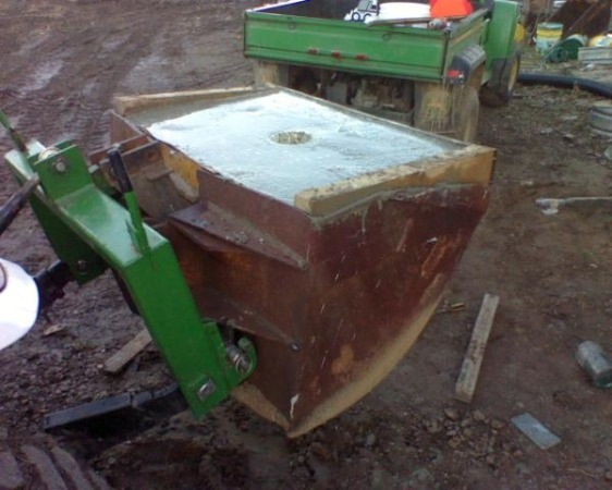

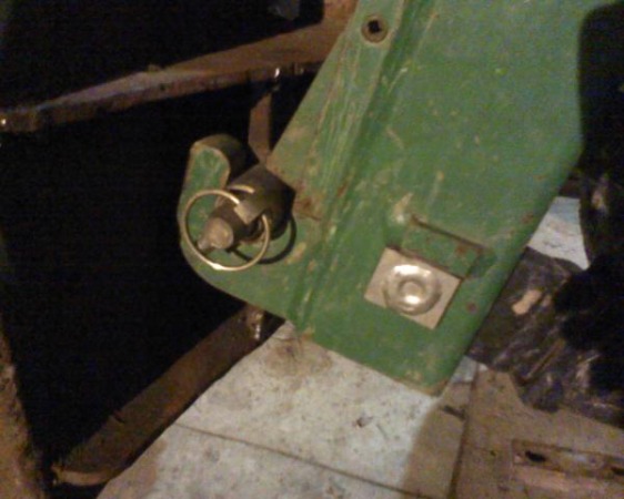

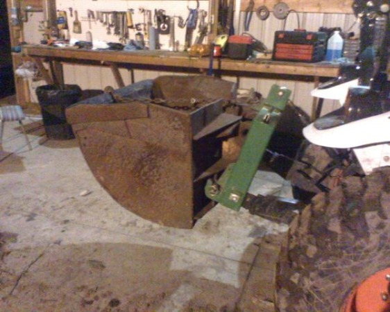

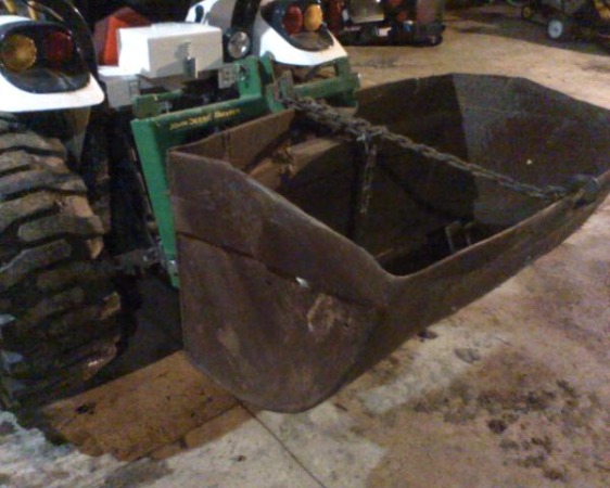

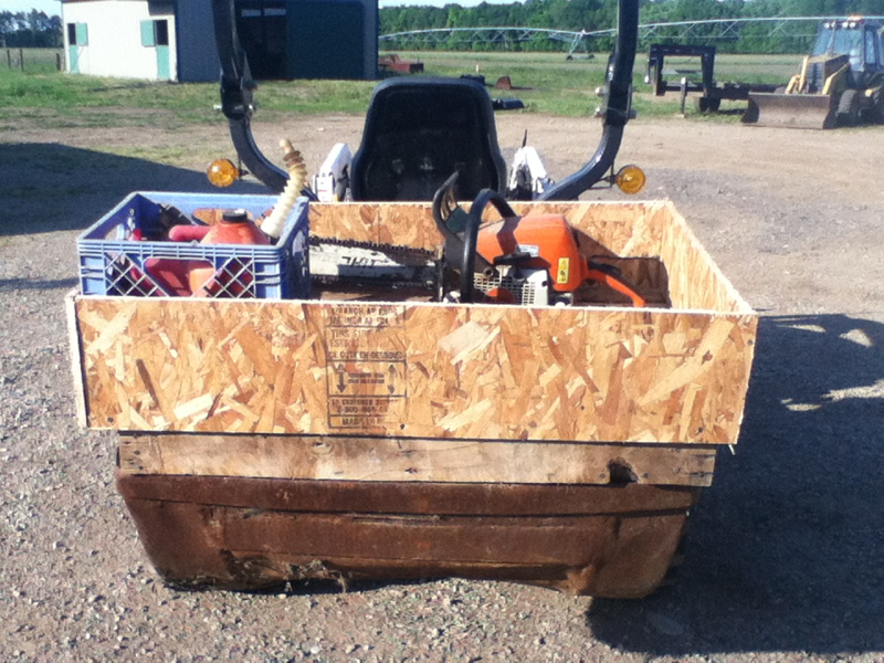

Came across this old HEAVY John Deere bucket and that we never use anymore. and well i was figuring i could make this into a nice ballast box or ballast bucket! :D so i mounted the bottom hooks and made it fit the Imatch hitch. just have to make the toplink tomorrow. it weights abut 400 lbs empty so its going to get a layer of concrete on the bottom then filled with some old cast iron wheel weights, then fill with sand and top off with a cap of concrete and form a tray to put chains etc in. thinking im going to end up with about 900 to 1000 lbs of good ballast :thumbsup: hope this works well!! :licking:

forgot pictures :p :tractor:

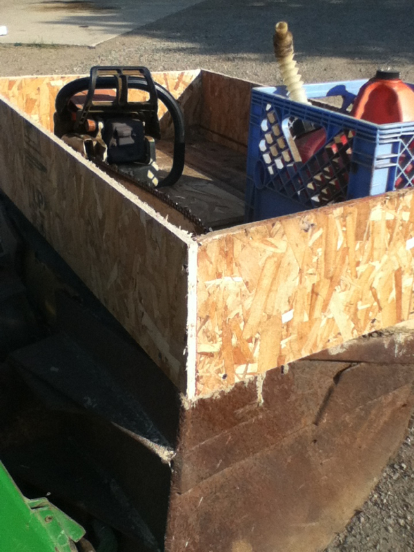

Looks good, will make a handy carrier if you need to move alot of tools etc. Like having a trunk. looks big enough I'd leave it with just loose ballast so you could dump it if you need the storage space.
I made a contraption where I can put a regular JD front bucket on my I match too. Haven't really had a need for it yet.

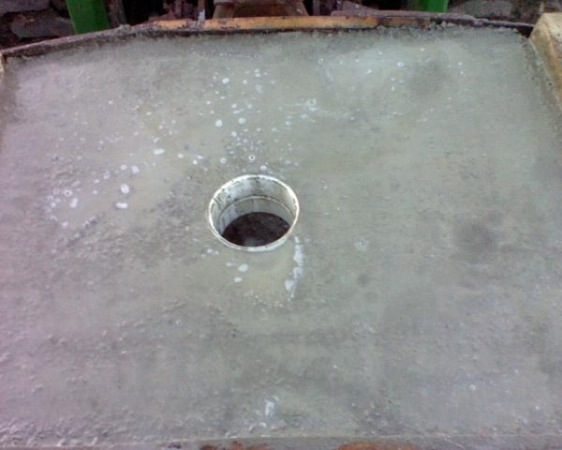

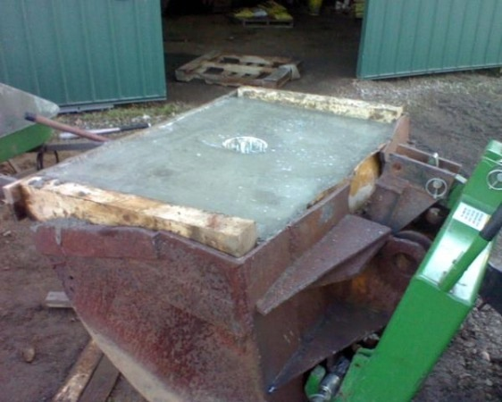

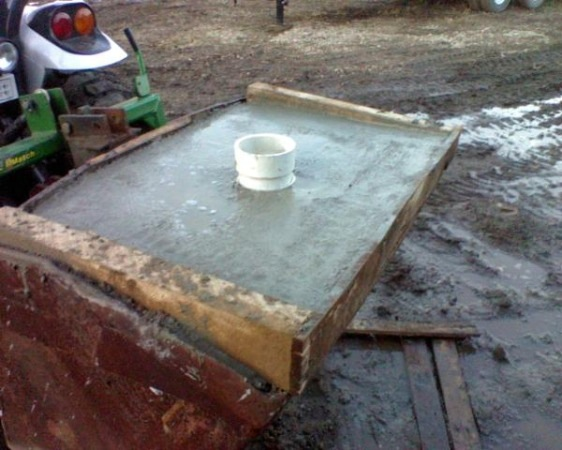

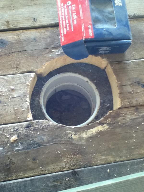

Yep all finished I can't believe how nice it is. Got about an hour today of cleaning trails, and it was not tippy with the grapple on, here's what I did from start to finish, step 1- place 1 80# bag of quick crete, 2- put moist sand in, 3- put 2 large HEAVY rocks in, 4- put more sand in and metal scraps wet down and compact. 5- mix 3 more 80# bags and cap with concrete. But always put the PVC coupler in first, so I dug a 4in area out put a 4in coupler so can a pipe on or keep flat. It is very heavy!!! Just have to weld some stands on to keep it from rolling back.

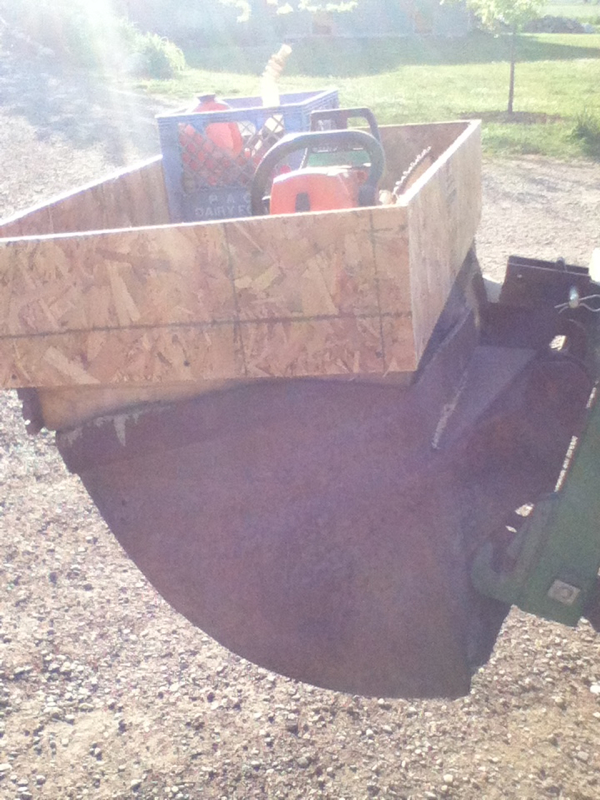

Here it is all finished, went into the woods with grapple it performed quite well, I thought I would loose visibility but I just lowered it and all was fine. Carrys tools quite well.
